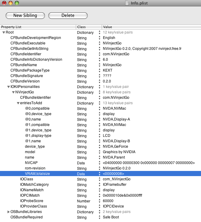

OR for a laptop GeForce Go series GPU, e.g. GeForce Go 7400, GeForce Go 7300, and GeForce Go 7200 you can try NVinjectGo.kext and edit (using e.g. PropertyListEditor) your NVinjectGo.kext > Contents > info.plist to include a VRAM,totalsize entry
with a value depending on the GPU fixed memory (NOT shared memory):
"VRAM,totalsize" :
<00000008> - 128Mb
<00000010> - 256Mb
<00000014> - 320Mb
<00000020> - 512Mb
<00000028> - 640Mb
<00000030> - 768Mb
<00000040> - 1024Mb
As Krazubu states in his now "disappeared" "Guide for *ALL* nVidia boards, List of supported cards + infos for modding" Insanelymac topic:
so EITHER for 7050 or 7100.......which are integrated onboard GPU/video chipsets.......as far as I know not supported by OS X for CI/QE.......and can only run in Vesa mode......

That is exactly what I was thinking, the table says to enable it, but do not select the drives to use. Thanks so much, I did an initial bench of this with one drive, and compared to my G5 its about 5x faster... I can't wait to setup the raid and get this going as my primary machine! Two last questions if I may and I think I am set...
1. As long as I do not use the Experimental diver for the Sata DVD drive, I can have 8GB of RAM on the board?
2. Is there a major difference between the kexts for NVDarwin, and NVinject?
Basically just wanting to set up the most stable and optimal setup...
Thanks for everything...
~Stephen
1. To use more than 3GB RAM you need to use slashack’s modified MeDevil AppleNForceATA.kext....when ≥ 3GB RAM is installed, you need 64-bit addressing capability....this kext contains rewritten code that causes it to use a kernel API that supports 64-bit addressing....MeDevil's original and Test kexts do not do so......
2. NVdarwin is more up to date.......latest version is CoreVidia.......you just need to choose the amount of VRAM that your graphics card has.....
1. To use more than 3GB RAM you need to use slashack's modified MeDevil AppleNForceATA.kext....when ≥ 3GB RAM is installed, you need 64-bit addressing capability....this kext contains rewritten code that causes it to use a kernel API that supports 64-bit addressing....MeDevil's original and Test kexts do not do so......
Maybe stupid question but since I am at work, do you know if slashack's modified MeDevil AppleNForceATA.kext is included in the latest iDeneb installer? v1.4...
Thanks again,
~Stephen
Thanks again,
~Stephen
Not sure.....but you can temporarily boot after installing OS X with -v maxmem=2048 and then use Kext Helper b7 to install slashack's AppleNforceATA.kext v0.1 from here.....it will also keep the iDeneb v1.4 installed nForceATA.kext backed up......
