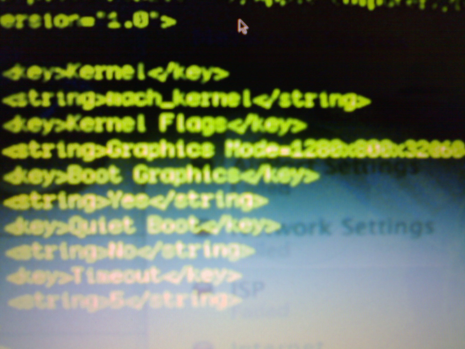

Modify the com.apple.Boot.plist file as follows:
1. Go to the Terminal, and at the $ prompt, type in
sudo nano /Library/Preferences/SystemConfiguration/com.apple.Boot.plist
2. Enter your password when requested. Use the arrow keys on the keyboard to move the cursor within the Terminal window.
3. Type in (without any spaces anywhere except where there are spaces)
"Graphics Mode"="1280x1080x32@60" BUT as I said using your display resolution.....
between <string> and </string> under <key>Kernel Flags</key>.
4. Move the cursor the Terminal window down until it no longer moves, then press Ctrl O and then Enter, to save the modified com.apple.Boot.plist file.
5. Press Ctrl X to Exit and type "exit" at the $ prompt to log out of the Terminal and then close and quit Terminal.

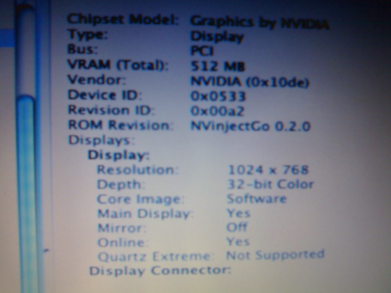

thanks a lot man...but nothing...i not resolved my issues.no sound no internet...
i instaled NVinstaller_v2.pkg after i made what you said to mi (unsuccesful)and i ssen this :
chipset model: graphics by nvidia
type : display
vram : 512
vendor:nvidia(0x10de) but mi resolution display is just 1024x768 no more :(
type : display
vram : 512
vendor:nvidia(0x10de) but mi resolution display is just 1024x768 no more :)

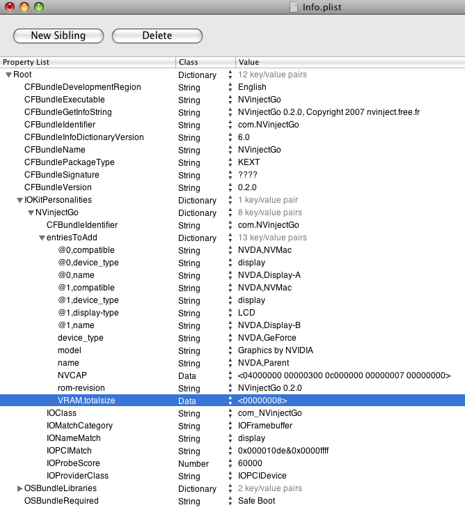

1. Check in /System/Library Extensions/ that you removed all other injector kexts tried such as NVkush.kext, natit.kext or titan.kext....that only NVinjectGo.kext is present.....
2. Check in /System/Library Extensions/ that
GeForce.kext
NVDAResman.kext
NVDANV50Hal.kext
NVDANV40Hal.kext
NVDANV30Hal.kext
NVDANV20Hal.kext
NVDANV10Hal.kext
are missing, and reinstall using the 10.5.4 files from here and check in /System/Library Extensions/ that
GeForce.kext
NVDAResman.kext
NVDANV50Hal.kext
NVDANV40Hal.kext
NVDANV30Hal.kext
NVDANV20Hal.kext
NVDANV10Hal.kext
are now present again
3. Check that you have entered <00000008> for "VRAM,totalsize" since you have 128 fixed i.e. not shared VRAM in your NVinjectGo.kext > Contents > info.plist
4. In Terminal set ownership and permissions of Extensions folder
sudo chown -R root:wheel /System/Library/Extensions
  sudo chmod -R 755 /System/Library/Extensions
  sudo touch /System/Library/Extensions
  sudo rm /System/Library/Extensions.mkext
  exit
If this does not work, then try this fix for your 1024x768 resolution.....

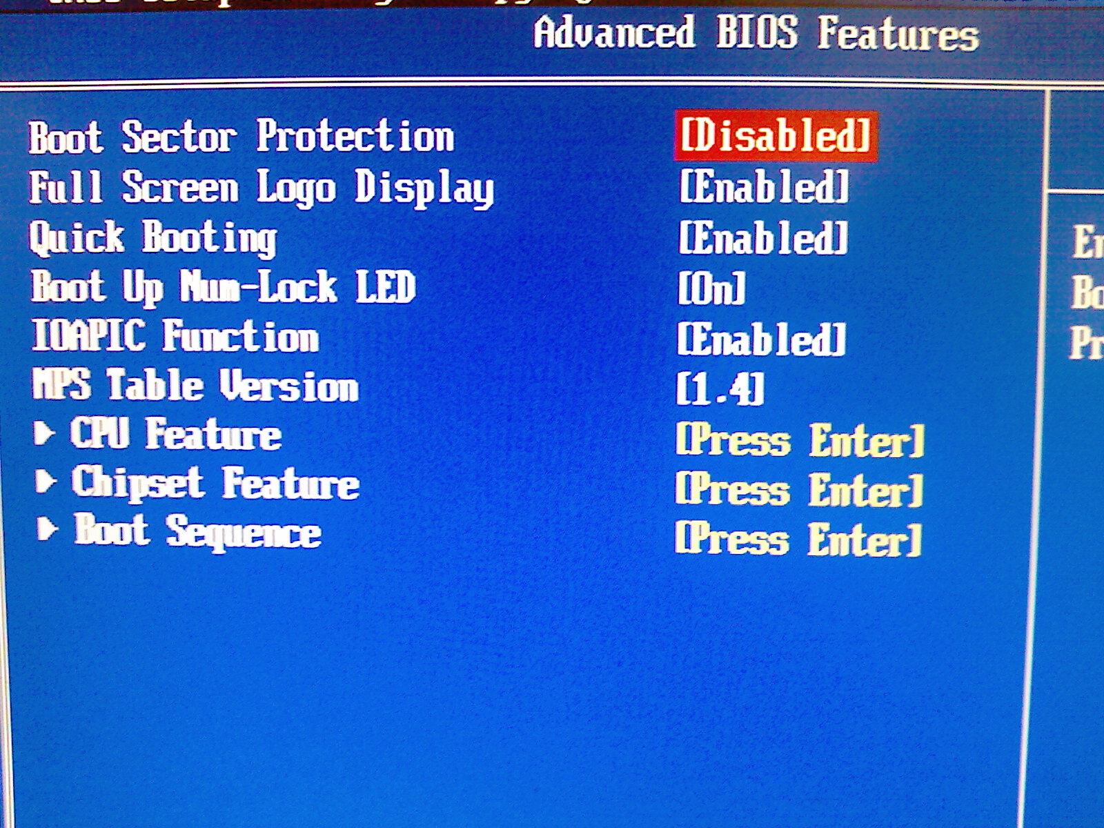

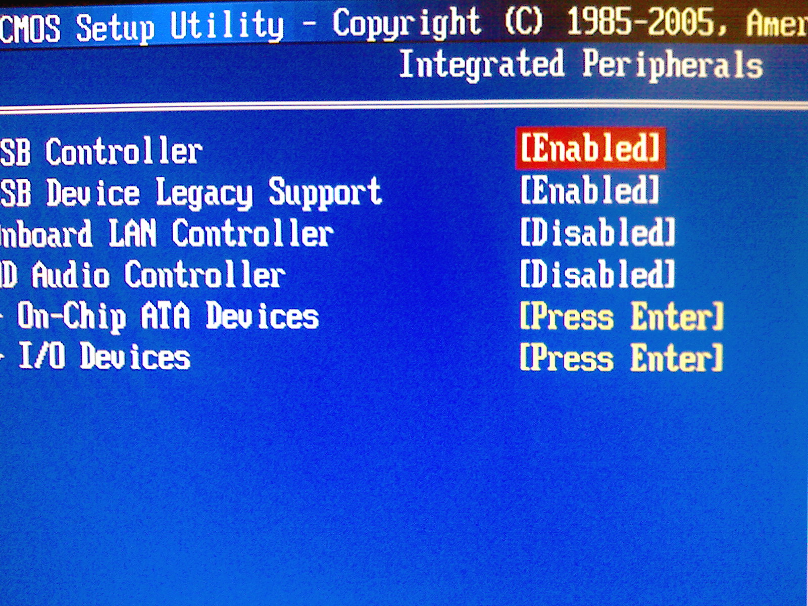

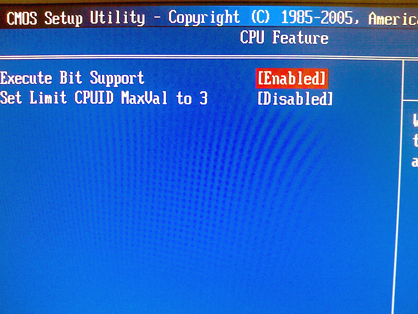

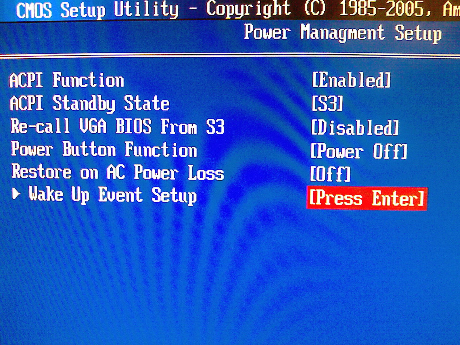

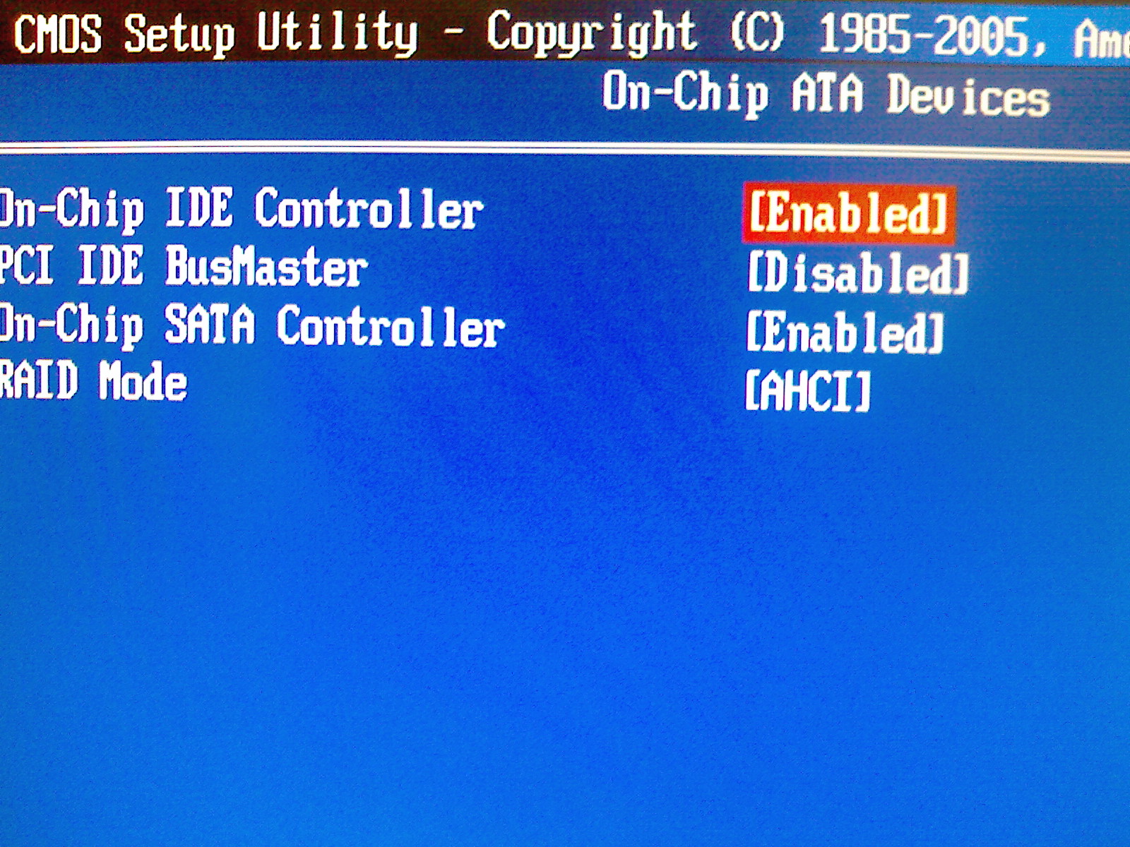

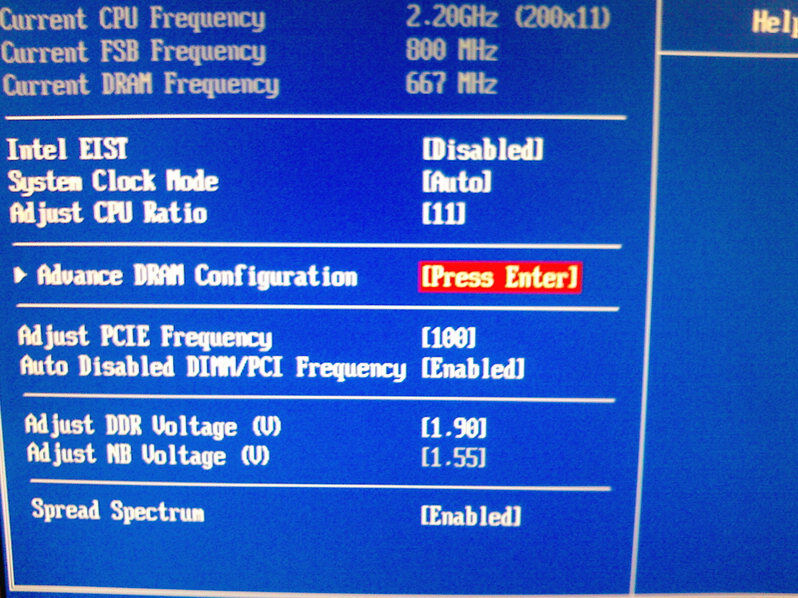

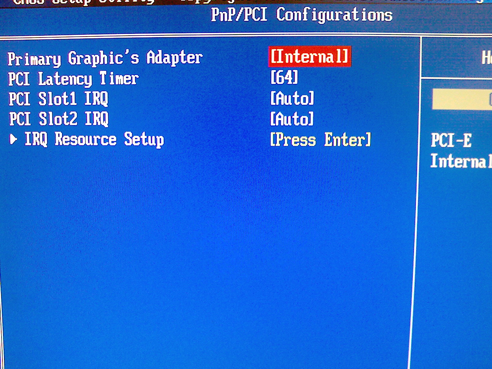

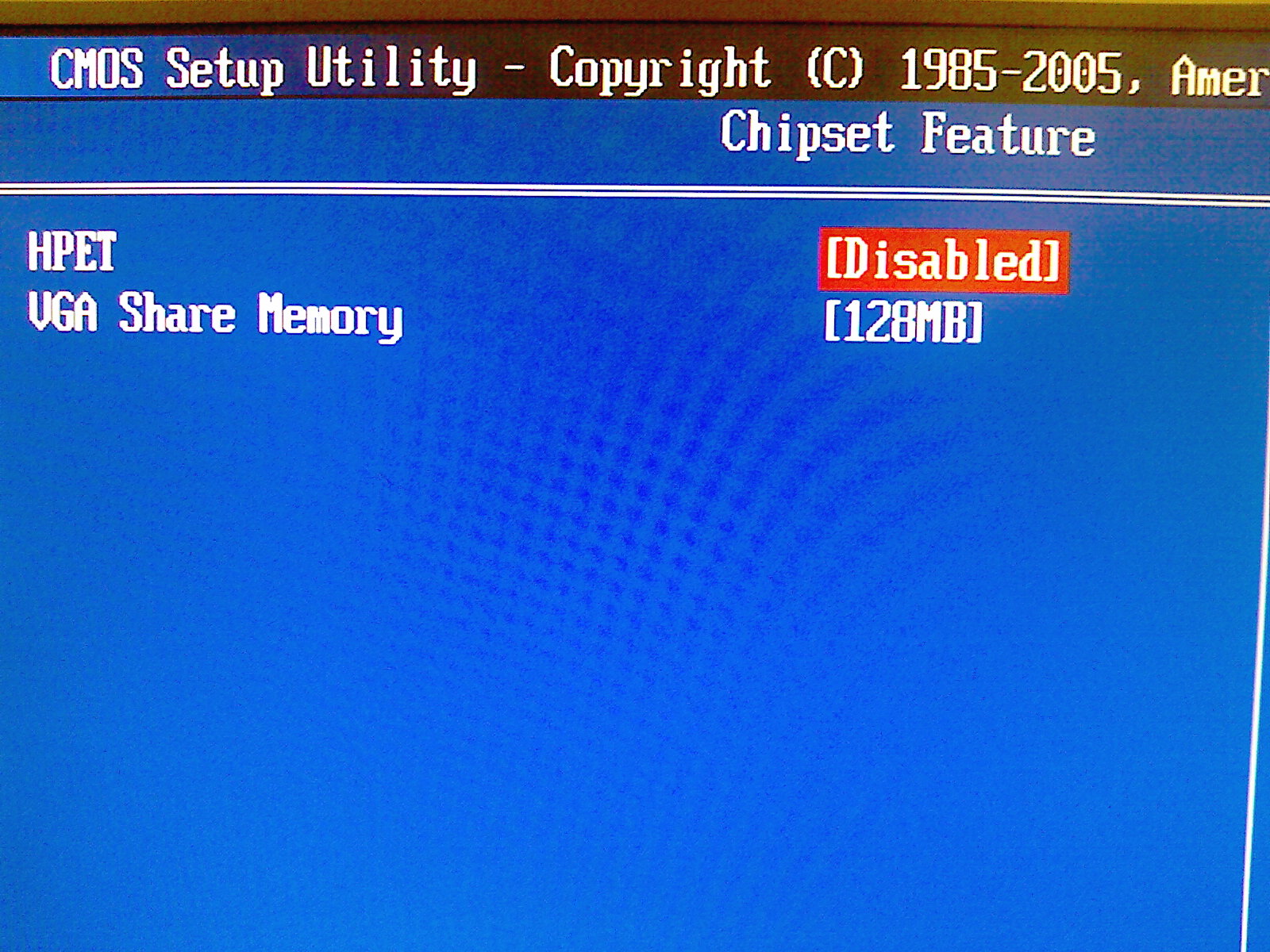

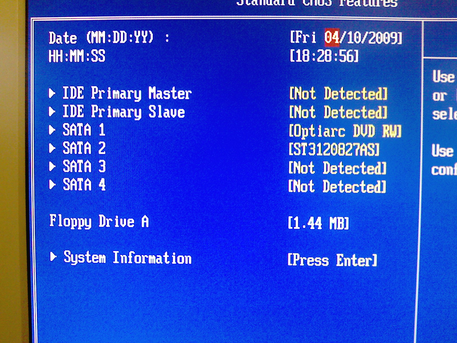

ACPI fix? Yeah man, I've read this. When I chosing this fix the best what happens is working Leo but only with cpus=1. So I can try to replace ACPIPlatform.kext with another on iAtkos 4i or iAtkos 1i r3 iso.
I compared my BIOS settings with 1st post and I'm sure that it's correct for what I need. I'll attach photos of BIOS sets bit later.
Thanks.
P.S.: SATA DVDRW
@ wrsMyMnd
Your BIOS settings look OK......but enable HPET and HD Audio Controller......
So when you install OS X from DVD what kernel are you choosing.....?
@ wrsMyMnd
