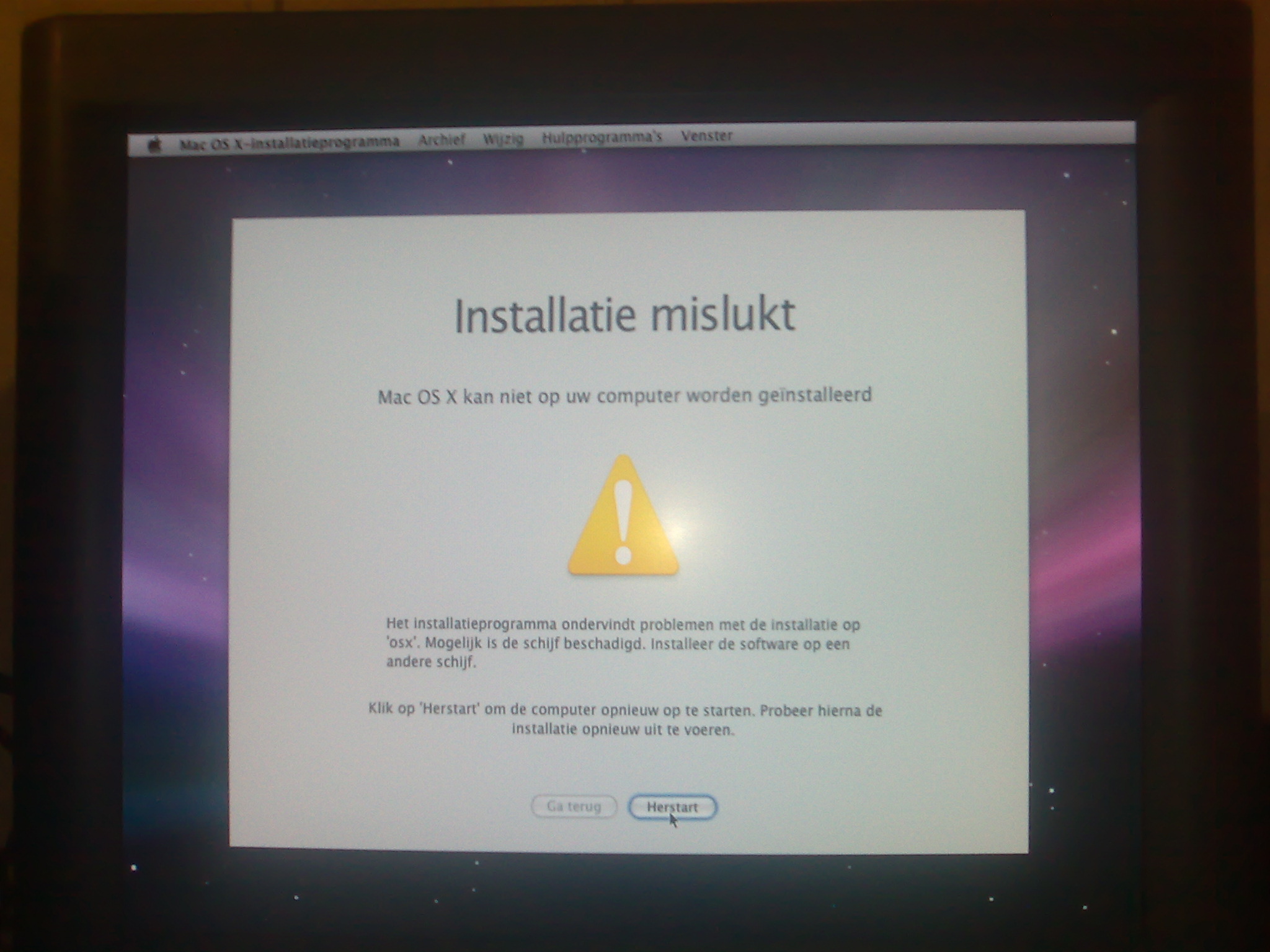

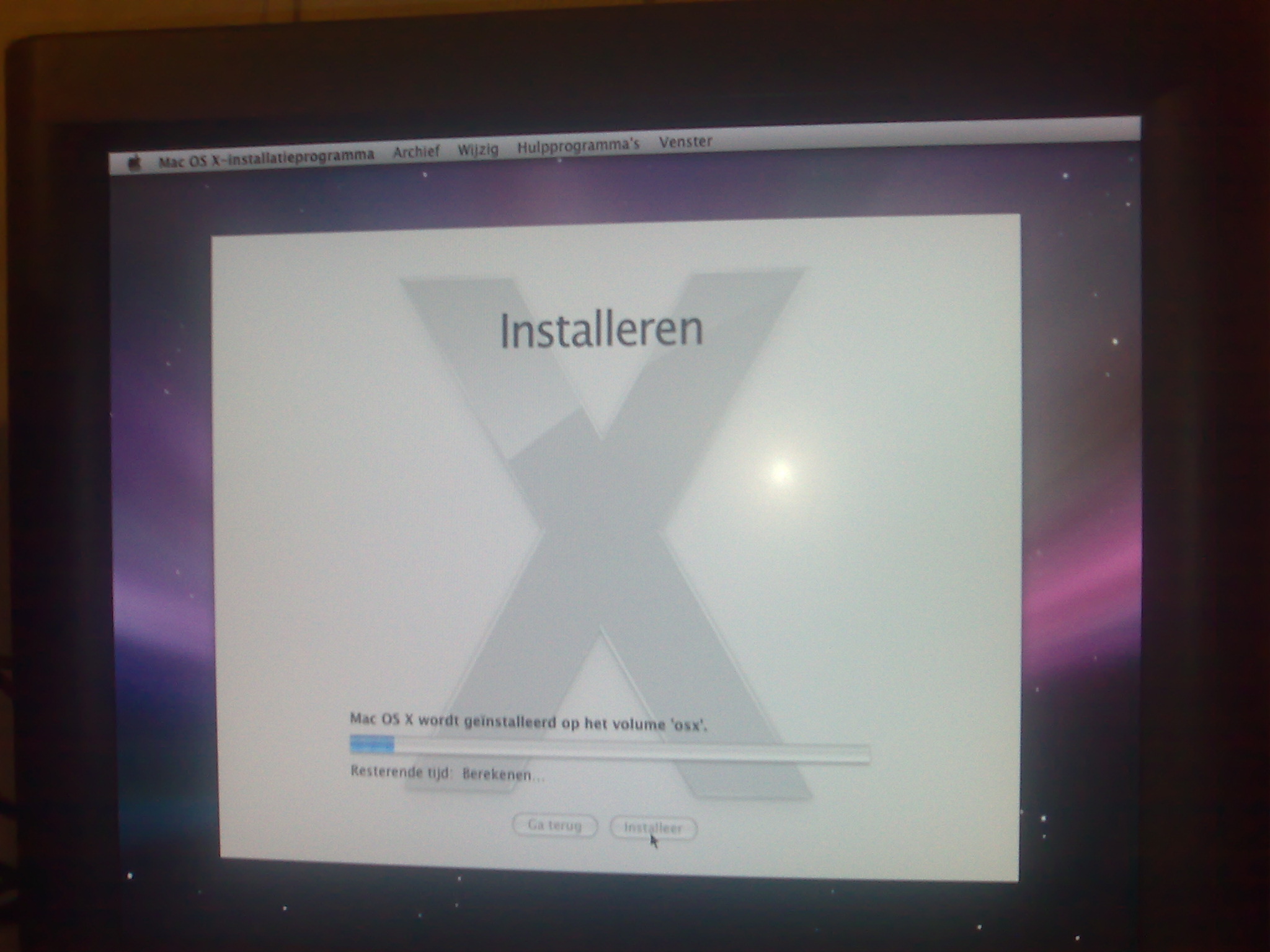

ok,
I'll continue in this topic ! in first place thx, the still waiting for root device problem is fixed but...
when I try to install I get a error, I think it's my hd but I ask it anyway here you got some pics in atachment
first pic: everything goes fine you think but then... first pic.
translation of first pic:
Installation failed
Mac OSX can't be installed on your computer
The installation program has problems with the installation on 'osx'
Possibly the disk is damaged. Install the software on another disk
Click restart  to restart the computer, then retry the installation
Do I have to search another Hd?
Thx ;)
ok,
Installation failed
Thx ;)
First suggest you try using DVD Installer Disk Utility to partition the HDD as MBR as before but then format the HDD as MS-DOS (FAT) and reformat as Mac OS Extended (Journaled) and then use Disk Verify to check the formatted HDD.......also set IDE DVDRW as Master and IDE HDD as Slave if you have not already.......otherwise if your MOBO has two IDE channels, then try HDD and DVDRW on separate channels, each as Master......

Assuming that Windows is booting fine from the SATA HDD, then Disk Utility should see the SATA HDD.....if not then the Install DVD has not loaded the correct kext at boot up for your MOBO Southbridge chipset......seems unlikely with IAtkos v5i......
So, also recheck that BIOS settings have not changed back to factory defaults rather than the settings, especially IDE/SATA settings, needed for OS X......
Also do a really clean install by using DVD Installer Disk Utility to partition the IDE HDD as MBR as before but then format the HDD as MS-DOS (FAT) and reformat as Mac OS Extended (Journaled) and then use Disk Verify to check the formatted HDD.......
Some forum members suggest that OS X is "happier" with SATA HDDs than PATA HDDs.......I am not convinced........so check out slashack's thread and ATA drivers here......

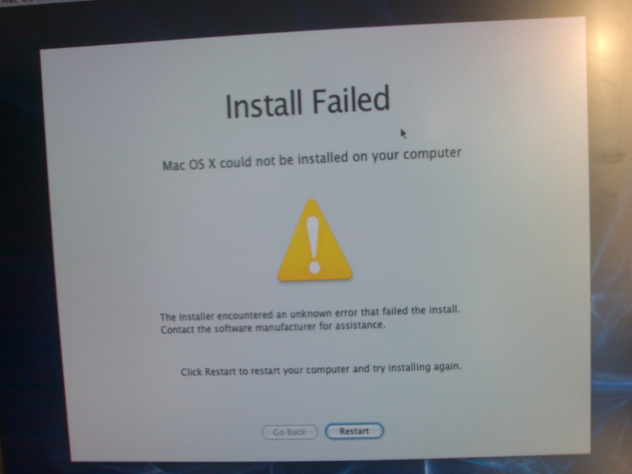

1. iDeneb 10.5.5 v1.3 / and some md5.rtf file that came with it
2. I would like to know if installing this on the extra hard drive, i would have to boot back onto XP to get missing sound drivers/ethernet port drivers/video drivers. I also read that there are some mac installations which install all the drivers for you, is iDeneb one?
still the same problem, will try with another hd from a friend now
Ok, I also tried Iatkos one time because kalyway doesn't work and then I got another error (see attachment)
I want kalyway running on my pc!!
This is what I do in disk utility:
I partition my hd (ide 80gb)
format it as ms-dos
format it again as mac os extended journal
partition it as mac os MBR
What Am I doing wrong?
