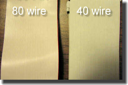

Nothing that is obvious based on what you are posting here....assuming that you partition as MBR and format as MS-DOS (FAT) and then reformat as Mac OS Extended (Journaled).........
Is your IDE cable 40 or 80 wire.....? It should be 80 wire AFIK according to some users who had problems with IDE HDDs until they changed from 40 to 80 wire ribbon cable......
Can you resize your Vista SATA HDD to create a free primary NTFS partition that can be re-formatted as Mac OS Extended (Journaled), or can you try another PATA or SATA HDD from a friend.......?

UPDATE: IDE CABLE CONNECTIONS
1. The modern 40-pin Ultra DMA 80-wire cable can be made connector-specific by jumpering CS (Cable Select) on HDD and jumpering CSEL (Cable Select) on the DVDROM, because the cable connectors are usually color-coded as follows:
Blue connector to the host i.e. MOBO,
Black connector to the chosen primary device, i.e. device cable-selected as Master (usually i.e.should be the END connector of the cable)
Grey connector to the chosen secondary device, i.e. device cable-selected as Slave (usually i.e. should the MIDDLE connector of the cable)
BUT not always......... :unsure:
With such a cable, if you jumper the DVDROM as Master and the HDD as Slave, or vice versa, then the Slave device is usually connected to the middle connector and the Master device to the end connector (with the Blue connector as always connected to the MOBO IDE connector)
2. If you have the older 40-pin 40-wire Cable Select cable, then the Master Connector is the MIDDLE connector of the cable, and the Slave connector is the END connector of the cable (with the Blue connector as always connected to the MOBO IDE connector).
3. If you have the older 40-pin 40-wire Regular (non-Cable Select) then the function of the MIDDLE and END connectors on the cable 40-pin 40-wire (with the Blue connector as always connected to the MOBO IDE connector) are determined by the jumper settings on the devices connected to each (i.e. Master or Slave). With such a cable, if you set both devices as Cable Select, each will configure itself as Master, causing a signal conflict.
4. If you have the very rare situation of one device having to be jumpered on Cable Select and the other jumpered as Master or as Slave (i.e. no CS or CSEL option), then Cable Select mode is invoked, configuring the MIDDLE connector of the cable as Master on older 40-pin 40-wire Cable Select cable, and on modern 40-pin Ultra DMA 80-wire cable, configuring the END connector of the cable as Master (with in either case, the Blue connector connected to the MOBO IDE connector).
Confusing or what......... :wacko:
Your photographs and results suggest that you may have an older 40-pin 40-wire Cable Select or Regular cable......
Your MOBO has two separate IDE channels, hence the two IDE connectos on the MOBO.......I am guessing that the blue connector is IDE Channel 0 and the black connector is IDE Channel 1.......if you had two IDE cables you could try connecting your IDE DVDROM to the blue MOBO connector as Master and your IDE HDD to the black MOBO connector as Master if other IDE arrangements do not work........

Ok I have two 80 wire cables ;) how do I have to connect them now? :D like you said here:
ty :D
edit: the 80 wire cables are only with one connector on each side so not like my 40 that I can connect two devices on one connector on the mobo
and indeed:
