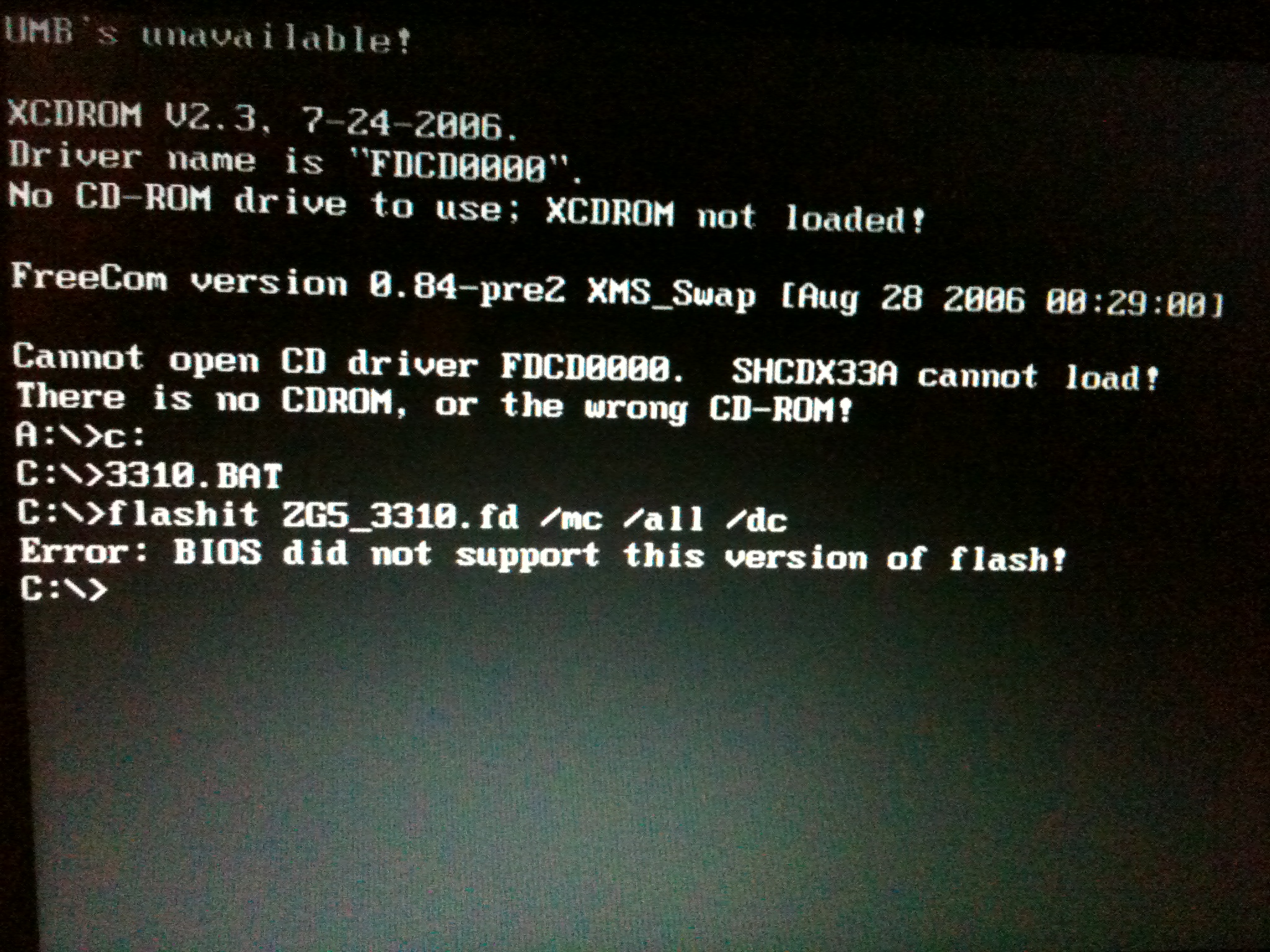

FrogsRhoppin Posted April 16, 2010 Share Posted April 16, 2010 I'm using the 3310 bios but every time I load them it says "Bios did not support this version of flash" Idk if I missed a something? I have tried the 3304 and got the same error.. I'll keep trying for a month if I can actually find a way to get this crappy windows system off, I cant even change the background and it keeps shutting down out of nowhere to install "important updates". It's plugged in also* Link to comment Share on other sites More sharing options...

elbizarro Posted July 20, 2010 Share Posted July 20, 2010 I'm using the 3310 bios but every time I load them it says "Bios did not support this version of flash" Idk if I missed a something? I have tried the 3304 and got the same error.. I'll keep trying for a month if I can actually find a way to get this crappy windows system off, I cant even change the background and it keeps shutting down out of nowhere to install "important updates". It's plugged in also* goto acer and redownload it.. There is an app in the zip file that will run in Windows and will let you update the flash within windows.. Well I finally decided to play with this and after loading up to 10.5.5 decided to take the plunge and go for 10.5.8. And thats when the fun started.. First it said Update Unsuccessful then after getting it to restart.. It loaded anyway.. But.. Killed my onboard Keyboard, Mouse, Network, Video.. So after I managed to reload the original kept files as per the original page I now have all that back.. Also plugged in my USB bluetooth and that loaded 1st time.. Doing some updates right now.. When I get a replacement Wireless Card I should be good to go.. The only thing I would like to resolve is the 2 Flash Card Readers and maybe a higher resolution. But on the whole If I can Image the HDD I will be happy.. Rob.. Link to comment Share on other sites More sharing options...
