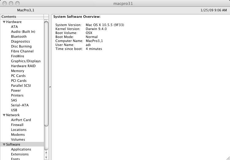

I just finished installing it on a Dell Optiplex GX620 USFF.
P4 3.4Ghz
2GB DDR2 memory
200 SATA drive

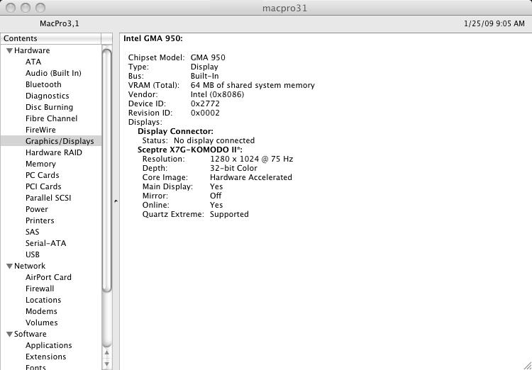

Video GMA950 (Dev 2772, Ven 8086)
NIC Broadcom Netxtrem 5703 (Dev 1677, Ven 14e4)
Audio Intel 82801 AC97 ICH7 (Dev 27de, Ven 8086)
Chipset i945G
I installed using GUID partition.
I installed with kernel 9.4.0, the only option I picked to install is the patch for intel ICHX and video GMA950 (but it needs the AppleIntelIntegratedFramebuffer.kext (attached).I get full QE/CI.
I did not pick NIC drivers or Audio at the time of install (I attached the ones I used).

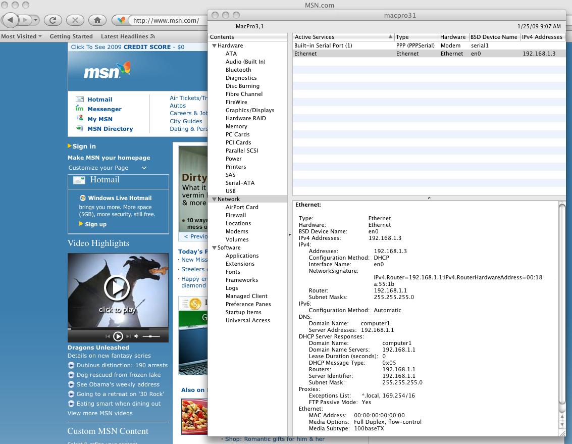

Additional steps I followed for the NIC are also included inside the zip file attached, You get a MAC address of 00:00:00... and also how tochange it to a real MAC and how to make it permanent.
This is information I got from other posts around here, thanks to all the people creating/helping with this.
Kexts_used.zip
