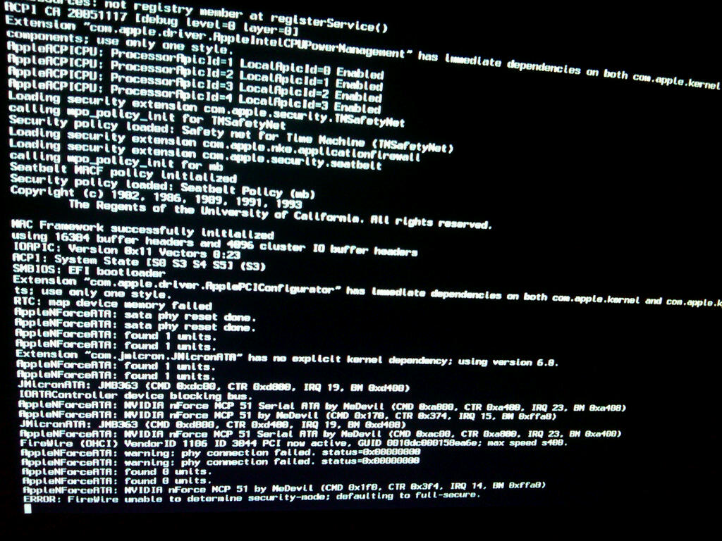

Hey, heres where I get hung up
Im using iDeneb 10.5.5 currently.(I also have tried iatkos v7 but during install end up with the kernal panic that pops up over my install)
Using cpus=1 i can get into the installer and install fine. Ive tried a few settings, but the only thing thats "worked" has been
(selected at install as per this thread http://www.insanelymac.com/forum/index.php...ode=linearplus)
9.4.0 kernal
Jmicron
MCP67
ACPI FIX
When I do that, I can boot into OS X, but only in safe mode. I get only one functioning monitor, and no interwebs. USB works, Firewire works (but im not sure how well..it at least recognizes one of my devices, a behringer fca202 audio interface)
I have the 9600 GSO card and use two monitors, but havent gotten so far as getting natit or titan or kush or anything on there working. Id like the get the OS booting normal and internet functioning first.
Im booting onto a bran new WD SATA 1 GB drive partitioned in two. 750 gigs of storage, and the rest is my mac install, both are MAC Journaled format.
Ive gotten JaS10.4.8 working perfectly before on my old HP, but i got the screaming new quad core, and I do a lot of video work, and get really tried of windows being a suckfest for that sort of work, and want to play around with FCP and CS 3/4 for Mac.
Let me know if anything has any ideas for iatkos v7 or iDeneb 10.5.5! Im sure its probably some stupid BIOS setting or something..i tried following the chart listed, but didnt see all of the options in my BIOS..
thanks!

If you can only boot into OS X using cpus=1 it is likely that you have a "bad" DSDT.aml being loaded by your BIOS......you need to generate a "patched" BIOS using fassl's DSDT Patcher and put it in /Extra generated by installing the Chameleon 2.0 V3 bootloader.......see post #1
The BIOS template in post #1 is a composite for many MOBOs with the same nForce chipset, so your BIOS may/will not have all of the parameters/options shown.....
When initially installing OS X do not select to install any video, network and audio options.......first focus on getting the basic OS X system running OK......these drivers can be installed later using Kext Helper b7.....
Recommend you use the Voodoo 9.5.0 kernel with 9.5.0 System.kext and 9.5.0 seatbelt.kext.....

My other specs:
XFX 750i SLI motherboard
Intel Core 2 Quad 2.83 GHz (Q9550)
2x2gb DDR2
IDE DVD-RW
SATA HDD
What I've done:
- Installed iDeneb 10.5.5 with only
- - 9.4 XNU kernel
- - AppleNForceATA
- - JMicronATA
- - ACPI Fix
- - Firewire remove
- - X11
- Upgraded with iDeneb 10.5.8 combo upgrade (now using 9.5 Voodoo kernel)
- Manually inserted EFI string from EFIStudio in com.apple.Boot.plist
- Upgraded Chameleon to v2 RC2 (for DSDT support)
- Used DSDT Patcher GUI to generate a dsdt.aml (after this, I could use 2 cores instead of 1)
- Inserted PCIClassMatch into .kext's in the OP
What else do you think I should try? Thanks for the help.

Have you been here.......?
Yes, I tried that too with 10.5.5 installed. I've also been trying to setup 10.5.2 with Leo Graphics updates + EFI strings, but haven't got it working yet. Kalyway 10.5.2 with the JMicron fix for IDE-DVD is crashing with ACPI panic errors before reaching the installer.

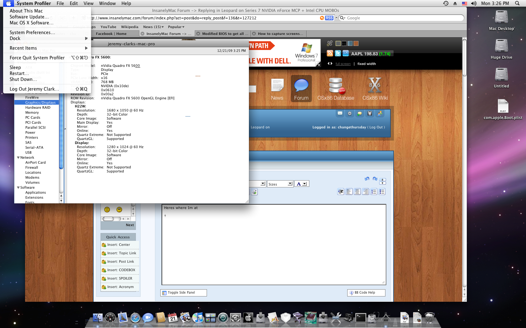

Heres where Im at
Ive got the OS up and running
GRAPHICS:
I have a 9600 GSO 768, and have tried a variety of graphics solutions. I can get both monitors and full resoultion, but no CI/QE going. Right now im on the 5700FX or something driver (ive tried all the 8800 and some 9XXX drivers all with the same result)
Im getting lines in various places on the screen, especially drop down menus. Im including a pic.
CPU:
Right now im only getting 1 core recognized. Im booting with CPUS=1, because my machine will keep restarting if I dont. Ive tried a few different fixes, but it always hoses my install. When i use the various DSDT patches, i see that when i -v boot ill see it recognize all my cores, but the boot will fail somewhere else down the line.
Audio:
No prob, using my firewire interface, works great
Firewire/USB:
No problems
Internet:
no problems (using the .pkg installer linked from this thread)
I would love any help with the Grpahics/CPU issues! I have the feeling i have to get my board recognized correctly before the graphics will work right, but I could be wrong..
BTW, im using iPC 10.5.6

Follow manual procedure here......your graphics hopefully will work.
For patched DSDT.aml file, did you run fassl's DSDT Patcher after booting with cpus=1......?
When i run Fassl's patcher, i notice it recognizes my 4 cores (at startup in verbose mode) but it always hoses my installation..something else fails buring boot. Ill try it again and post what comes up in -v at the fail point, because i forgot what it is off the top of my head..
Much thanks for the other link..ive been killing myself on the baords looking, but havent seen that thread!
