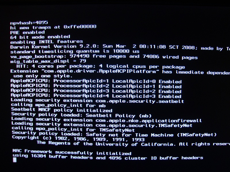

Well I did exactly as you put. Booting from the harddrive stops at the Mac Framework. Tried with flags cpus=1 maxmem=2048 -v -x. It does still boot up off the kalyway install disc with rd=disk0s1 flag.
Would I be right to think it's a kernel issue? Or maybe bootloader?
A screen shot of your HDD boot attempt freeze would be helpful......this way I can see what the cause may be from any onscreen error messages......

I did have it set as primary. I don't know how I can get Chameleon installed because my ethernet doesn't work yet and I couldnt get usb to work either. I'm going to try to reformat my usb drive and try again with Chameleon.
Here's my screenshot when I boot with -v
You appear to have a BIOS issue.....see the section
HELP FOR THOSE EXPERIENCING ACPI-APIC and/or BIOS PROBLEMS (e.g. always needing to use the cpus=1 boot flag)
in my Install Guide in post #1......
Would I need to patch if I had 10.5.6 or higher? I read that it isn't necessary after 10.5.5. It all seems pretty confusing so I'm trying to find out if there's a way around it, plus a I hate messing with BIOS because I had to replace the motherboard in my laptop once from a bad flash. I saw there was mackerintel's chameleon version, but would that help my situation? I posted in Kabyl's topic and am just waiting for him to reply.
DSDT patching may be needed for different reasons.....your issues probably does require DSDT patching.......
DSDT patching using a modified DSDT.aml file in the /Extra directory created when you install Chameleon 2.0 DOES NOT CHANGE your MOBO BIOS........Chameleon just overwrites the DSDT.aml file loaded into RAM by the BIOS with the patched DSDT.aml file in /Extra........ :(
I do not remember if you can boot OK or not using -v cpus=1 maxmem=2048......if you can, then simply install Chameleon 2.0 bootloader......then run Fassl's DSDT Patcher without choosing Force compile and New HPET options......
