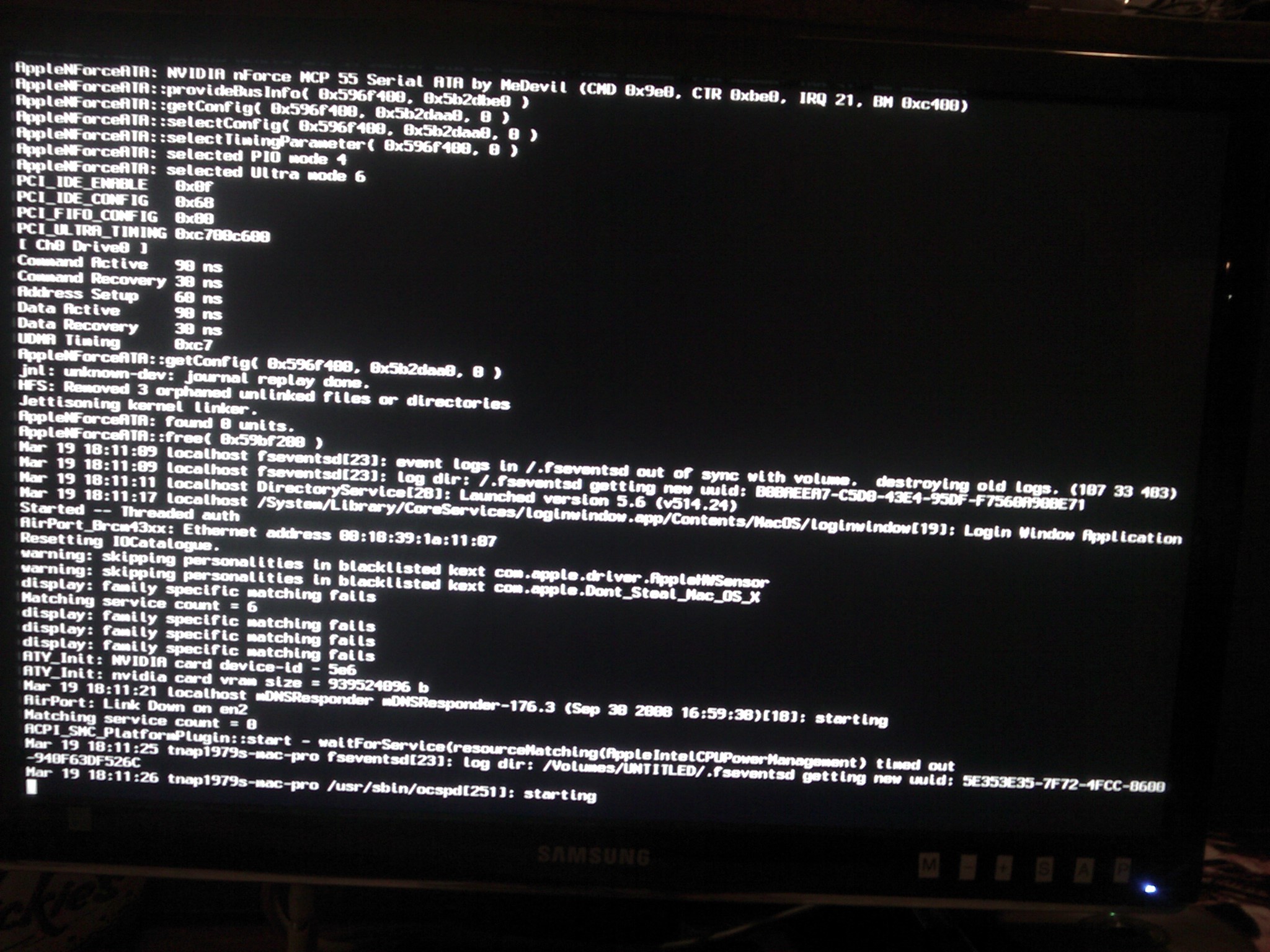

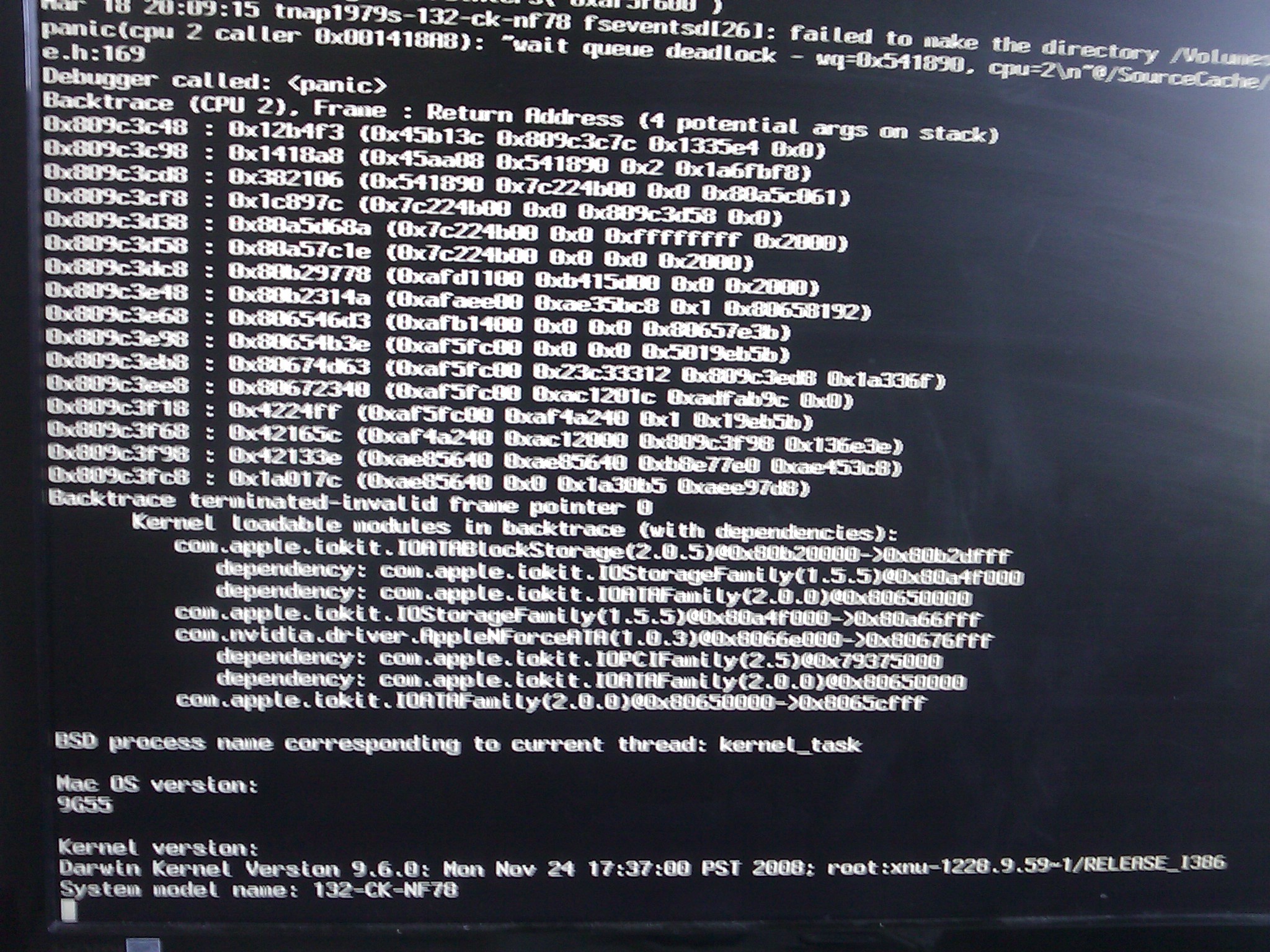

now my problem is, after i get the basic install setup options and am ready to install, i choose only what i need, and nothing else, im running vanilla kernel 9.6.0 i beleive from the disc, i dont choose any fix's just tha network drivers i need.
once install completes, i am going thru setup in the mac osx, and finally get to the desktop, can do anything, go on safari or whatever,
but then when i restart, shutdown, or anything that involves leaving the osx environment and booting back into it, i get some error im not to sure of...

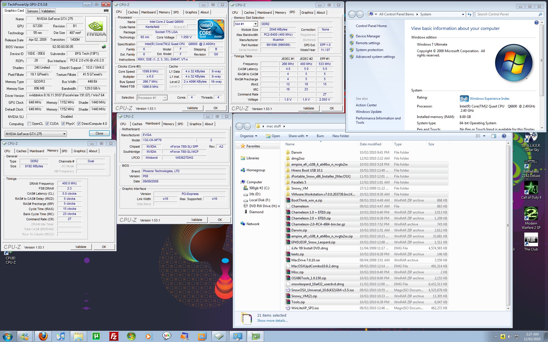

ill post pics here of my setup and information

so here is what happens,
i can install from the disc mentioned, iPC 10.5.6 ppf5 final,
i use boot flags as such " -v -f maxmem=2048 cpus=1 " to get the install to be good and then i restart the pc,
when pc restarts, i press " ESC " key, select my boot device as the 40gb PATA i installed osx to,
( all discs and memory sticks and usb storage devices removed... )
i can then boot into OSX 10.5.6 boot loader, use flags " -v -f maxmem=2048 cpus=1 ",
system boots, i have ethernet access and wifi access from the drivers i choose to install from setup...
i can browse safari, and do normal things as it seems the os is fully working, but no sound from my x-fi
i get bored of not being able to update or do much, so i figure, ok reboot system, and then if i boot without any flags...
it panics...

ok so here is how far i got after i restarted from a successful install, i booted into osx, set preferences, first thing was to install newest version of kXaudiodriver 1.3b0, then proceeded to install this package from this post,
gtx275 solution (leopard).zip = taken from this post from verdant,
http://www.insanelymac.com/forum/index.php...y=793"
using the leopard 10.5 solution i assume, i proceed with steps 1 & 2 given from above packages readme for gtx275 896mb,
then i assumed i was to restart, and came up with following screen that paused and did nothing for a good 45 minutes untill i restarted the pc, and booted now into my win 7 setup,
any help ??

What happens when you boot with -v -x.......

well verdant...
i had tried the " -v -x " boot flags...
to no effort, it failed...
so i did a complete re-install, using the bios settings, and the recommended settings for my hardware from iPC 10.5.6 ppf5 final,
im now again back in osx typing this on safari, this is the first reboot since the install,
the only drivers i did not install were my video and sound drivers, i left those blank in the setup options,
as i would like my specific video and audio drivers for my hardware, i dont care to much for the sound card working, as i can just revert to my onboard realtek system if needed, but i must have the video working accordingly, or the whole point of osx's sexiness is pointless.... lol
so im going to leave my system as it is, logged into osx, im not going to reboot untill i can figure out how to safely get my hardware running, and as an extra added measure, im going to clone this 10gb partition with the osx install, so that i can just boot back into a clean version if something fails...
lemme know any further advice, and btw my about this mac, it shows my full ram size of 8gb, my cpu speed of "2.4ghz Unknown", my model name shows as " mac pro ", cores are 4, processor is 1....
so it seems that major components are working properly, just the various hardware...
if you need any screenies, or more info, advise me how to do such, as im a newbie to using mac osx... and have no clue as to how to do screenies

I have a number of suggestions:
For video, see post #1 about IOPCIClassMatch modding of the nVidia graphics kexts as a start........
For sorting out About This Mac see my blog entry on it.....one of the early entries......

hey all.... GOOD NEWS>>>
ive managed to finally get my video hardware working,
this goes out to all in this thread, if you do follow instructions, and read enough, you will obtain the goal...
but no matter it will be a pain in the arse, i do admit....
so here goes,
i read, read, read, read till my brain bled.... :wub:
and learned alot, some of which i never knew how to do, and now the glory...
my pc finally boots OSX Leopard 10.5.6, Voodoo kernel 9.5.0, with all hardware working and installed,
i am just now about to clone my install test partition to have a backup, and im finally going to test the install of my creative X-Fi titanium fatality pro...
once that is complete and works... ill have managed to get all my hardware working in a full 100% setup...
the steps to get most of my motherboard, cpu, and ram setup working, were not that hard, most of all of it was built into iPC 10.5.6 ppf5 final, md5 hash check of - 9ceb2e8daaa182a1071a337ad9b81e3f...
so after i had base install, my goal was working on video, i followed all steps, installed all kexts, had to do an efi string edit, then as well as re-install the video drivers, then finally... BAM full video on restart..
1920x1200x32@60hz with QE/CI on BFG GeForce GTX 275 OC 896mb PCI-E 2.0
shows up properly now in about my mac, only now i need to figure out how to update, properly....
and then i can clone that updated system partition, and try testing out a snow leo install, so i can fall back on my leo install if things get hairy....
if any of ya'll have questions, ask away and i will try to help as best as i can to explain how i achieved my work....
i thank Verdant 100% for all his tips, tricks, and help along the way,
when i can afford to do so, ill be making a lil donation for effort, i think it takes great patience to have to deal with this kinda stuff on a daily basis...
thanks again, and lookin forward to learnin more to get snow leo goin now on my system... i like a good challange :unsure:
Nicholas
