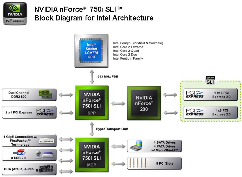

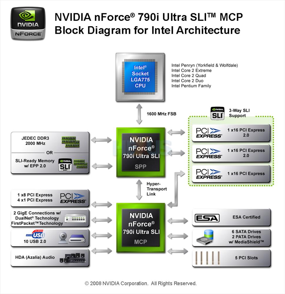

1. Your MOBO brand and model: e.g. EVGA nForce, 790i Ultra SLI
2. Your nForce Series 7 chipset: i.e. 750i SLI, 780i SLI, 790i SLI, or 790i Ultra SLI
3. Your Intel CPU: Model, Core Quantity, Stock Speed and if Overclocked to what speed..... e.g. Intel Core 2 Quad CPU Q6600, 4 cores, 2.4GHz stock, 3.0GHz OCd

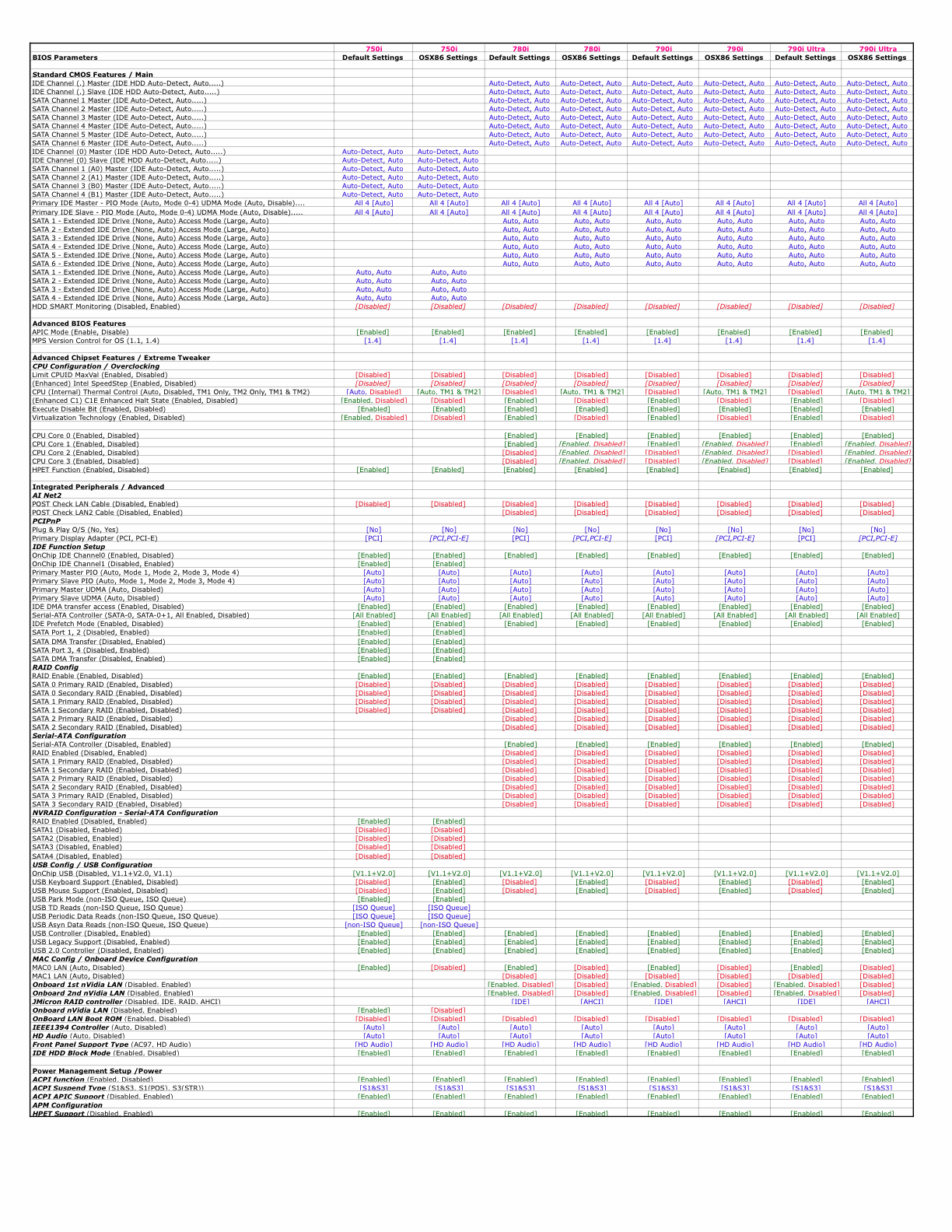

BIOS SETTINGS TEMPLATE FOR 750i, 780i, 790i and 790i Ultra NVIDIA nForce Series 7 MCP chipset based Intel CPU MOBOs
This BIOS template (now V2 correcting a few minor typos) does not claim to cover all the BIOS variations for all the different MOBOs that meet the above requirement........also apologies for any errors........It is a composite list so under 750i for example it has the settings for different 750i MOBOs in the same column; e.g. the Asus 750i BIOS layout is different from the EVGA 750i BIOS layout which is similar to MSI 750i BIOS layout.......likewise for the other chipsets......
BUT readers should be able to see which ones of the listed parameters match their particular BIOS parameters......
I did it this way because I am not able (due to time constraints and not having every MOBO manual etc.) to list all the relevant BIOS settings for each of the four Series 7 nForce chipsets for all of the nForce chipset MOBO manufacturers!.....I hope you understand...... :)
It is a preliminary guide to the most likely forms of the relevant BIOS parameters, their default settings, together with my recommended initial settings to enable OSx86 installation and stable operation (within the known limitations of nForce chipset MOBOs...... :blink: ).
The BIOS settings in italics are ones that you could change later if you so wish (assuming you have the appropriate kernel to install) to see if the system still runs OSx86 without any problems...... :)
In the BIOS template I have got IEEE1394 Controller (i.e. Firewire) set as [Auto], generally the default BIOS setting........BUT if when having it set as [Auto] you cannot install OSx86 from DVD because your PC freezes during booting from the DVD, then set IEEE1394 Controller as [Disabled] and try rebooting from the DVD.......
If it makes no difference, the origin of the freeze lies elsewhere......if, however, you can now boot successfully from the DVD into the OS X Installer window, then after successfully installing and running OSx86 from the HDD, you can set it back to [Auto]......if everything continues to work OK that is...... ;)

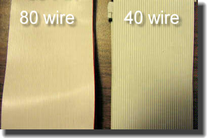

CORRECT IDE (PATA) DEVICE JUMPER SETTING AND CABLE CONNECTING
1. The modern 40-pin Ultra DMA 80-wire cable can be made connector-specific by jumpering CS (Cable Select) on HDD and jumpering CSEL (Cable Select) on the DVDROM, because the cable connectors are usually color-coded as follows:
Blue connector to the host i.e. MOBO,
Black connector to the chosen primary device, i.e. device cable-selected as Master (usually i.e.should be the END connector of the cable)
Grey connector to the chosen secondary device, i.e. device cable-selected as Slave (usually i.e. should the MIDDLE connector of the cable)
BUT not always......... :thumbsdown_anim:
With such a cable, if you jumper the DVDROM as Master and the HDD as Slave, or vice versa, then the Slave device is usually connected to the middle connector and the Master device to the end connector (with the Blue connector as always connected to the MOBO IDE connector)
2. If you have the older 40-pin 40-wire Cable Select cable, then the Master Connector is the MIDDLE connector of the cable, and the Slave connector is the END connector of the cable (with the Blue connector as always connected to the MOBO IDE connector).
3. If you have the older 40-pin 40-wire Regular (non-Cable Select) then the function of the MIDDLE and END connectors on the cable 40-pin 40-wire (with the Blue connector as always connected to the MOBO IDE connector) are determined by the jumper settings on the devices connected to each (i.e. Master or Slave). With such a cable, if you set both devices as Cable Select, each will configure itself as Master, causing a signal conflict.
4. If you have the very rare situation of one device having to be jumpered on Cable Select and the other jumpered as Master or as Slave (i.e. no CS or CSEL option), then Cable Select mode is invoked, configuring the MIDDLE connector of the cable as Master on older 40-pin 40-wire Cable Select cable, and on modern 40-pin Ultra DMA 80-wire cable, configuring the END connector of the cable as Master (with in either case, the Blue connector connected to the MOBO IDE connector).
Confusing or what......... :rolleyes:

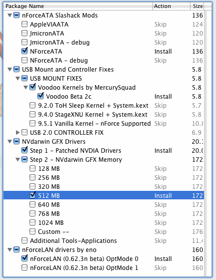

The Mysticus C* nForce Drivers Installer v1.2 and 10.5.5 Combo Update Patches v1.2.0 are BOTH available here ..... :thumbsup_anim:
At my request Mysticus C* has produced a standalone installer, primarily for nForce chipset + Intel CPU MOBO owners (although other users may benefit from it too....see installer options :) ) for the following advances of particular benefit to nForce chipset MOBOs:
XDarwin's NVdarwin GFX card driver installer
eno's nForceLAN onboard LAN driver for nForce MOBOs
MercurySquad et al.'s Voodoo kernel
slashack's NForceATA Darwin ATA Drivers (enables more than 2GB or 3GB of RAM to be used)
incorporating Mysticus C*'s USB mount and controller fixes too that will allow a post-OSx86 install on OSx86 10.5.2 and later........ALTHOUGH the installer is optimised for 10.5.5..... ;)
In his current version nForce Drivers Installer (v1.2), Mysticus C* has updated the current 0.62.3n beta version of eno's nForceLAN kext with the 0372-3 device IDs and provided it in two variants......one with the OptimizationMode set to 0 (for throughput-load optimization) and the other set to 1 (for CPU-load optimization)....... :)
I have successfully run version 1.0 of Mysticus C*'s nForce Drivers installer on
(i) Kalyway 10.5.2 OSx86 Test System (on an external USB2.0 [2 x 250GB SATA HDD] RAID enclosure running in BIG mode),
(ii) iDeneb v1.1 10.5.4 system, and
(iii) JaS 10.5.4 updated to 10.5.5 using Mysticus C*'s 10.5.5 Combo Updater Packages.

The installer runs successfully on my Asus P5N32-E SLI Plus (650i nForce chipset) MOBO with Intel Core2 Quad Q6600 G0 Version CPU OC'd to 3.0GHz, Gigabyte NVidia GeForce 8600GT GFX card, 6GB 667MHza DDR2 RAM, 3xSATA HDDs, PATA DVDRW, 2 x onboard nForce MCP55/Marvell 88E1116 LAN controller/chipset, and Netgear GA311 RTL8169 chipset NIC.....
The installer options in version v1.2 are:
BUT this does not mean that all of the installed kexts & kernel will run without error on your PC OSx86 system........

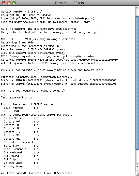

On my JaS 10.5.5 test system, I have run
HighLoad v1.9.8 memtest on 5020MB to test out the 6GB RAM as regards causing kernel panics with Voodoo Beta 2C kernel and slashack's nForceATA.kext.......all tests passed without any kernel panics!..... :thumbsup_anim:for Voodoo Beta 2C kernel and slashack's nForceATA kext.
Voodoo Beta 2C now successfully replaced by Voodoo Release Version 1.0 Rev_A

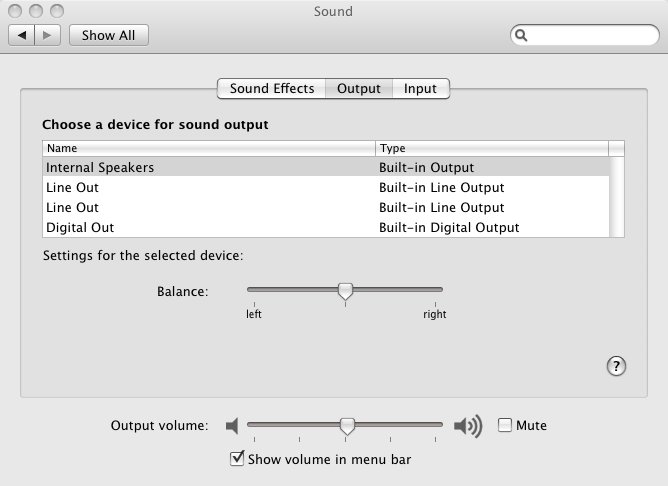

A. VoodooHDA.kext version 0.2.2 released.....see here......
Mute is now working.........autoswitching between speakers (unknown) on rear port and headphones on front port is still not working....
Sound_Output_VoodooHDA_v2.2.tiffSound_Input_VoodooHDAv2.2.tiffAudio_MIDI_Setup_VoodooHDAv2.2.tiff
B. Experimental Source for VoodooHDA released.........see here and here.......

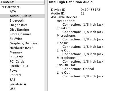

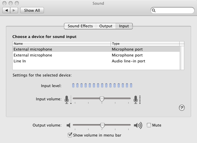

What I find
on my Asus P5N32-E SLI Plus MOBO with Asus SupremeFX Audio Card (with AD1988b audio codec) is as follows:
SysProfilerVoodooHDA.tiff
Sound_Output_1.tiff
Sound_Output_2.tiff
Sound_Output_3.tiff
Sound_Output_4.tiff
Sound_Output_5.tiff
Sound_Input_1.tiff
Sound_Input_2.tiff
Audio_MIDI_Setup.tiff
Rear sound-out ports working on Analog PCM #0: and Front sound-out ports working on Analog PCM #1:.......volume adjusted via Master or PCM.......autoswitching between ports is not working....
Sound Input ports and Digital PCM #2: have not been tested.......

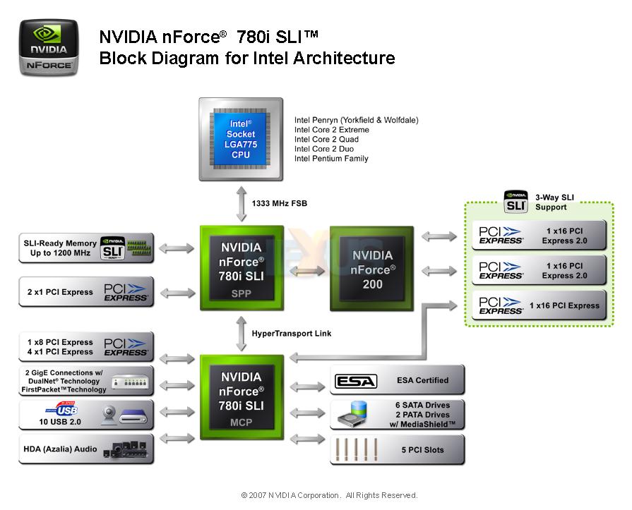

Below are block diagrams showing the 790i Ultra, 780i and 750i nForce chipset architectures to help thread readers understand more about nForce chipset MOBOs.....

Thanks for the update......I would like us to get to a position where in post #1 I can list in columns
| Key BIOS parameters | Factory default settings | Required settings for stable OSx86 operation |
for the 750i SLI, 780i SLI, 790i SLI, and 790i Ultra SLI chipsets, pretty much regardless of the MOBO they are on and/or the BIOS whether Phoenix-Award or AMI...... :)
