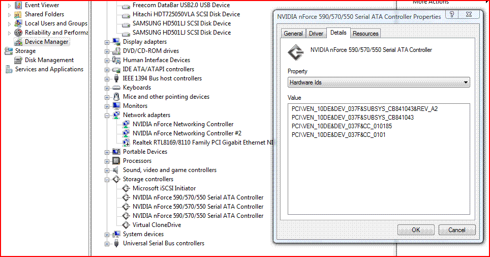

@ Metallica35
You can find out your Storage Controller Vendor and Device IDs in Vista as follows:
1. Open Device Manager by clicking the Start button, right-clicking Computer, clicking Manage, and when/if you are prompted for an administrator password or confirmation, type the password or provide confirmation by pressing Continue.....
2. In Computer Management window, click on Device Manager in LHS column.......click on Storage controllers in RHS column.......
3. Highlight desired contoller device and right-click, then click on Properties in pop-up window........then click on Details tab in window menu......
4. Click on Device description drop-down menu button and select Hardware Ids......in Value box
you will see a code similar to the one as shown:
PCI\VEN_10DE&DEV_037F&SUBSYS_...........
The code highlighted in RED is the Vendor ID and the code highlighted in GREEN is the Device ID, hence Vendor ID = 10de and Device ID = 037f

@ Metallica35

I am at the right screen, but under storage controllers the only thing coming up is Microsoft iSCSI Initiator
Are you sure that
(1) in your BIOS that you have set
RAID Enable [Enabled]
SATA 0 Primary RAID [Disabled]
SATA 0 Secondary RAID [Disabled]
SATA 1 Primary RAID [Disabled]
SATA 1 Secondary RAID [Disabled]
SATA 2 Primary RAID [Disabled]
SATA 2 Secondary RAID [Disabled]
I ask this because AFIK with your EVGA nforce 780i SLI FTW MOBO, you MUST have RAID Enable set to [Enabled], so that you can enable or disable the SATA functions.
This because WHEN you set RAID Enable to [Disabled], all SATA functions are changed to Disabled and cannot be changed, yet you want to set
Serial-ATA Controller [All Enabled]
(2) Have you installed the native AHCI/SATA drivers in Vista?
EDIT
You could run Ubuntu 8.10 Linux LiveCD and then in Terminal type
lspci -nn
as this will tell you if you have a OS or a BIOS issue with the SATA controllers......
EDIT 2
Vista is probably seeing your SATA drives as IDE drives which suggests that you do not have RAID enabled in BIOS.......I say this because in Windows XP, AFIK, if RAID is not enabled, SATA drives are seen as IDE drives.......so can you answer my questions above......

Ok i enabled RAID and updated the drivers and software for the nforce SATA controllers. It looks like the way you said it should look, and the hardware ID is
PCI\VEN_10DE&DEV_037F&SUBSYS_10013842&REV_A3. What do I do with that now? It seems that it has the same ID as yours, but mine won't work
Now that you have modified your BIOS settings:
with the EVGA nforce 780i SLI FTW MOBO, you MUST have RAID Enable set to [Enabled], so that you can enable or disable the SATA functions.
you should no longer see your SATA HDDs under the IDE section in Windows Vista Device Manager but now as SCSI Disk Devices and also see the NVIDIA nForce SATA Controllers together with Microsoft iSCSI Initiator under Storage Controllers........and now hopefully be able to pick up the SATA HDDs when booting from the OS X Install DVD.......?
You can also try booting from your Ubuntu Live CD and in Accessories - Terminal, type lspci -nn and see if your SATA controllers are picked up in Ubuntu......if so, you should see the SATA HDDs under OS X......
