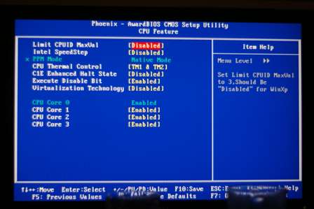

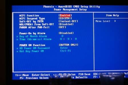

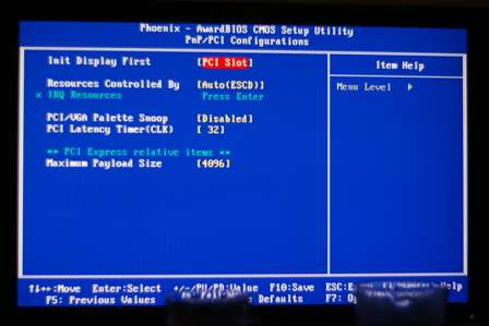

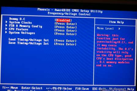

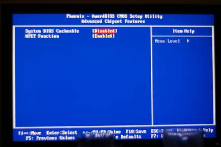

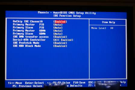

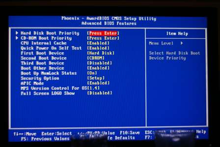

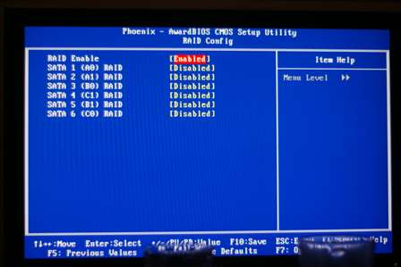

Also the first few times I was doing this with just the IDE SATA HardDrive and DVDRW to make sure it went into installation fine. But it worked the same way with everything hooked up as well. I would just like to get booted full constantly w/o that blue screen. I've tried -x -s and -f and combos of them and nothing seems to work. Ive also tried cpus=1 which I do for installation and maxmem=2048 and combos of them and still doesnt work.
Here are some pics of my bios for you, I followed your guide on bios setting for my mobo but some things I couldn't find so i wanna make sure they are set. I feel like it something pretty easy that I have overlooked.
Also just as a side note, I have almost an identical pc, running same mobo, a 2.83ghz quad, evga 9800GX2, 8gb ram and everything is running fine and used the same distro and patches.
Also just notice something when it turn my monitor off after leaving it there for a while and then i moved my mouse to wake it, it was fine. So i tried changing it so it would sleep my monitor...no luck. Then I tried to turn my monitor off and on again then it display osx for like 2 secs and back to the blue screen. So confused.
and now i feel like an idiot, it was the display port. The other one, boots up fine. Thank you Verdant still I thank you for the support on these forums you're awesome. Hope this helped someone out there. iDeneb technically works for everything right off of installation.

i disable the HBET in the bios and guest what the os is smooth but i feel there is something wrong with usb speed rate
