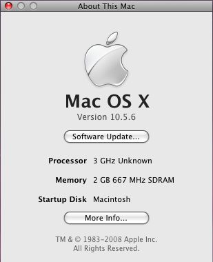

I can finally add a reply after a couple weeks of trial & error.
Dell Poweredge 400SC working from EFI boot. Processor upgrade to Prescott (SSE3 instructions).
I am using modbin to boot
Onboard audio (AC97) is not working, but a 10 dollar USB audio widget that was laying around works just fine.
Big thanks to munky for putting this all together in a cohesive format
Thanks to BladeRunner for posting the disc that got me on the right track
And thanks to all the other community members who put effort into making this work. I know who you are, you know who you are, let's leave my shoddy memory out of the question and leave it at that.
I'd gladly post the obligatory 'about this mac' screenshot, but that's not quite working. It seems to panic the GUI and that's just not happy. I'll figure that out in good time and hopefully follow up with the aforementioned picture.
got it working too, used the original ISO from the original boot123 post,or atleast the first one I found. Modded the files in initrd.img using a base install from an ideneb 10.5.5 v3 install. (stole the kernel i think it was 9.2.0, system.kext and a few others that might/might not be working). Install went pretty flawless once I figured out what two-digit hex device code to use (ef for me). Booted the a retail 10.5.4 dvd without issue, install went well (minus the language pack which wasn't necessary). Reboot also uneventful, even able to bring up 'about this mac' without issue (could be because I kept my system.kext file from same kernel but not 100% on that). anyway appreciate all the work DFE and munky put into this. if i didn't thank you...thanks and sorry for forgetting you.
attempting to install combo update 10.5.6 right now...will post results - also need to figure out some issues with audio not working, including wifi card and GMA950 without resolution change (QE/CI working though).
so interestingly enough, updated to 10.5.6 by downloading the combo update from apple, installed fine, system rebooted, tried to use my usual rd(0,1)/mach_kernel.modbin -legacy -v rd=disk0s2 and it crashes....tried again minus the -legacy ... it boots up like a charm and 'about this mac' shows 10.5.6.
