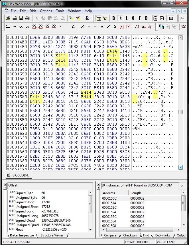

The 14E4 sounds like a Broadcom, and the 8086 sounds like an Intel, am I correct? I've search through the bios and I have not been able to find any entries of the 14E4 (E414 while searching). Intel wifi cards are unsupported in OS X, or do you dual boot? I will continue to look through the BIOS, hopefully I can find the whitelist.
they maybe are (this is from the hex of the bios) E4141843 3c105613

I have taken another look at the BIOS and still having problems. I haven't been able to locate the whitelist in the normal bios locations (BIOSCOD1-BIOSCOD4) I'm open for suggestions if anybody else here has opened up your bios and taken a look... ;)

awesome, thanks for the info... after reading your post, i looked again but didn't see biosexec but i did see romexec and found it in there. I do see your original wifi card in there and I can go ahead and add the intel. Please be aware that making any changes can brick your system. I advise that you know how to do a phoenix crisis recovery in the event of a bad flash. Please PM with a personal email, so I can send you the file.

Your 1490 is more than likely is an accepted card with your bios. Here is the screen shot for the whitelist in the f.29. I bet the ven dev subsys of your wireless card is in there. So not everybody that buys a dell 1490 is going to have the same success and will more than likely get the 104 error.

No problem. :whistle: The F.29 bios is just like mine (F.58A) in the whitelist aspect and I was able to patch it to allow any wifi card.

I have found the whitelist in BIOSCOD1.ROM of the F.3D. We can try to add in the specific card you want to use though. No guarantees but I have had 1 AMD user be able to use his atheros in his 6000 model after adding in the card ids for him. If you want I can give it a shot, but i will need the ven dev subsys of the card you want to use. I do advise knowing how to do a phoenix crisis recovery on your system in case of a bad flash.
