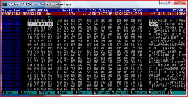

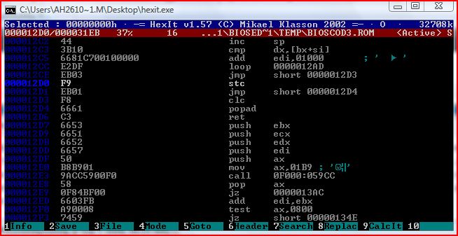

LRZRAGE Posted September 5, 2008 Author Share Posted September 5, 2008 Mehdymedy, looks like you are on the right track here. Later today i will go ahead and download the F.2B bios, do you happen to have a quick link? Your screen shots look good, one thing you might double check is in hexit hit F4 and go to code mode.. it will show F9 as a STC instruction and a F8 is a CLC. Can you give me you line numbers where you are seeing the ven ids etc. I have added a screen shot of what i did in my BIOS. The whitelist for the F.58A was located in COD4. notice all the E414(broadcom) and 8680(intel) ven ids... is yours similiar. Let me know what you figure out. Keep up the good work! OK LRZRAGE , thanks for your fast replay. i have found some interesting things . but my problem is i can't risk flashing my bios unless i make sure it works 100% or my wife will kill me . so i wish there will be somone who is willing to test it . cus i have found the F9EB01F8 code that you've mentioned above. the whitelist in bios F.2B is actually inside BIOSCOD3. Now , i took 3 pictures from inside BIOSCOD3. first one i highlighted with some numbers which i want u to look at them . these numbers are about 20 to 30 lines before i find F9EB01F8 code . The second picture clearly shows F9EB01F8 code . the third picture you can find numbers of other wireless cards which are supported like E4 14 11 43. please take a look at these pictures ,or if u want to open the F.2B bios, Go to BIOSCOD3 type inside search 22 42 . you'll see the first picture i took ,and when u go down about 20 lines you'll see F9EB01F8 code, and when u go further down you'll see the rest of the wireless cards which are supported. thank you for your help. Please i would be thankful if some people will test this and come back with great news . cus i really can't test this on this laptop cus i don't really own this laptop for now lol. Please whoever get this working create a patch , i promis u'll have the honor of hacking this bios Link to comment https://www.insanelymac.com/forum/topic/120190-hp-dv-series-whitelist-bios-hack/page/2/#findComment-880586 Share on other sites More sharing options...

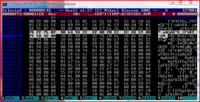

mehdymehdy Posted September 5, 2008 Share Posted September 5, 2008 OK thanks 'LRZRAGE' here is a quick link to the bios . click on download only and get it . http://h10025.www1.hp.com/ewfrf/wc/softwar...product=3747191 and i took a screen shot that shows F9 is stc and f8 is clc . I do see in your screen shot that after F9EB01F8 code all your wireless cards are listed nice and in order. but in my case you look about 23 lines down under the F9EB01F8 code you'll start seeing the wireless cards which are supported in white list. and they are not nice and in order . so it's kinda hard to see them. so if the F9EB01F8 code is the one that disables the whitelist . than yes u can see a list of ven ids of different devices and than comes the wireless cards . cus not only the wireless cards are listed in the whitelist as u know. i hope we can find a real tester . there was a guy here saying that he is willing to test the F.2B . but i don't know if he's still available. if someone is ready to take the test we will change the F9 to F8 and see if that solves all the headeach. thanks. Link to comment https://www.insanelymac.com/forum/topic/120190-hp-dv-series-whitelist-bios-hack/page/2/#findComment-880852 Share on other sites More sharing options...
LRZRAGE Posted September 5, 2008 Author Share Posted September 5, 2008 Mehdymehdy, if you would like to go ahead and change that F9 to a F8 at the spot you located, go ahead and do it, and then post the .wph here. There is a cool little program out there called crisis recovery and it is used for phoenix bios! If you happen to brick your computer, all you do is extract the original .wph file and add a couple other files to a floppy and shut off you computer and then hold win+b or fn+b and then power on (there are better directions out there). I believe I have the software but I have never had to use it. If you go ahead and post, anybody who downloads it, please use caution and only do it if you have used crisis recovery before. That is going to be the only feasible way of testing. Crisis recovery saves a lot of time rather than having to send it to somewhere in california for the repair shop for HP to fix. The only other thing I could think of right now is that there has been a thread going around here about a broadcom that is supported in the whitelist. I cant remember the exact name of the thread. obviously a couple of broadcom cards are support as you can see the E414 in the whitelist. Anyways, let me know on the progess. OK thanks 'LRZRAGE' here is a quick link to the bios . click on download only and get it . http://h10025.www1.hp.com/ewfrf/wc/softwar...product=3747191 and i took a screen shot that shows F9 is stc and f8 is clc . I do see in your screen shot that after F9EB01F8 code all your wireless cards are listed nice and in order. but in my case you look about 23 lines down under the F9EB01F8 code you'll start seeing the wireless cards which are supported in white list. and they are not nice and in order . so it's kinda hard to see them. so if the F9EB01F8 code is the one that disables the whitelist . than yes u can see a list of ven ids of different devices and than comes the wireless cards . cus not only the wireless cards are listed in the whitelist as u know. i hope we can find a real tester . there was a guy here saying that he is willing to test the F.2B . but i don't know if he's still available. if someone is ready to take the test we will change the F9 to F8 and see if that solves all the headeach. thanks. Link to comment https://www.insanelymac.com/forum/topic/120190-hp-dv-series-whitelist-bios-hack/page/2/#findComment-880908 Share on other sites More sharing options...

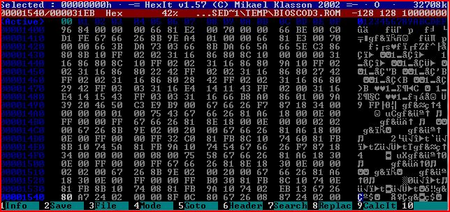

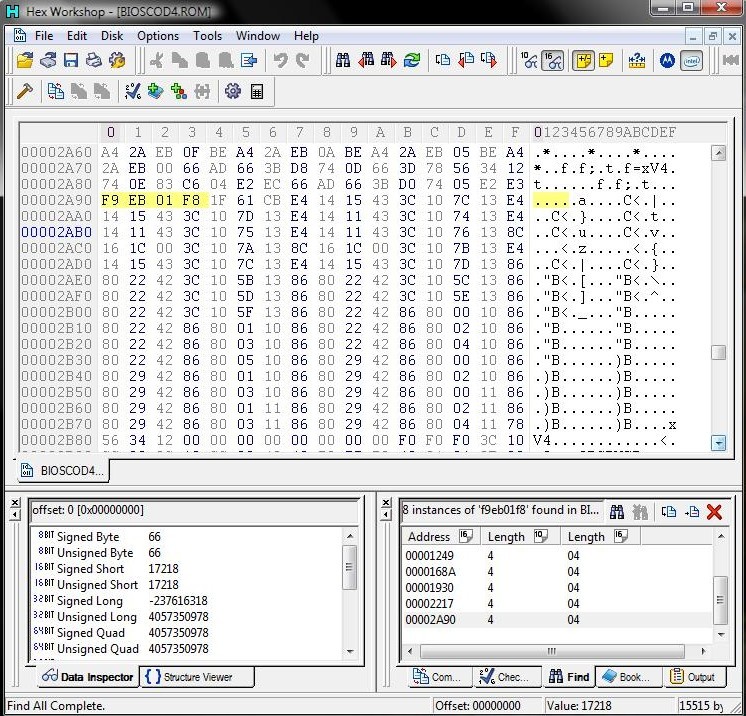

mehdymehdy Posted September 6, 2008 Share Posted September 6, 2008 hey mukole . here is another one . because there were 4 F9 EB 02 F8 inside BIOSCOD3 i tried to change all of them to F8 and i got it . now the phoenix editer gives that RLS error to everyone i guess . if not atleast everyone has files which are not recognizable in the begining when it loads or extracts the bios... i don't think that's the problem since it does buid it successfuly . also search in google for winphlash you can find it on intel website too so search winphlash intel easy to find it. download it . than install it and than go to C:\Program Files\Phoenix Technologies Ltd and put the bios there u must name it BIOS.WPH . and flash from there . but i don't recommand this one . it's just a suggestion. i wish you success this time . if not we might try changing some other stuff . or probably you give me the VEN&SUBSYS of the wireless card u want to use and i'll try to place it instead of one of them and we try if that can be helpful. and i wish some more experience people help here . thanks. i'm going to look inside the previous bios see if it's complicated like this one . mukole can you tell me the model of ur laptop. thanks . i found some good information on what to do before u drop the file inside the bios installer . but than i lost it and i can't find it . it was about double clicking on PHLASH and there is some information you change a couple of numbers and save it . i guess you set hidall to 0 and one more thing . i forgot. but i don't think it should be that important. anyways try this and tell me what happens. hi i'm also adding this one . if u want to try . this one is with only the first 3 F9 EB 01 F8 changed . because the last F9 EB 01 F8 which is at the bottom of BIOSCOD3 has no wireless card listen under it . so i thought i leave that it could be for some other important things . and i only changed those first 3 which you can find wireless cards under them. i don't know what else can be done i'm just trying different ways. sorry it kinda got messed up here . the one in the bottom is the one with only three F9 EB 01 F8 changed and the first one all four are changed. 30CDF2B.rar 30CDF2B.rar Link to comment https://www.insanelymac.com/forum/topic/120190-hp-dv-series-whitelist-bios-hack/page/2/#findComment-881436 Share on other sites More sharing options...
LRZRAGE Posted September 6, 2008 Author Share Posted September 6, 2008 Mehdymehdy, i went ahead and opened up the F.2B but when it opens up and loads I get an error. Are you getting any errors when it opens up? I might try a different version of phoenix bios edit. I am using 2.2.0.1. I did go ahead and open up COD3 and did see the vens scattered throughout. When I did the patch on the F.58A for my system, I only changed 1 F9 to a F8 that was right before the whitelist of vens. Thank you for helping out Mukole! hey mukole . here is another one . because there were 4 F9 EB 02 F8 inside BIOSCOD3 i tried to change all of them to F8 and i got it . now the phoenix editer gives that RLS error to everyone i guess . if not atleast everyone has files which are not recognizable in the begining when it loads or extracts the bios... i don't think that's the problem since it does buid it successfuly . also search in google for winphlash you can find it on intel website too so search winphlash intel easy to find it. download it . than install it and than go to C:\Program Files\Phoenix Technologies Ltd and put the bios there u must name it BIOS.WPH . and flash from there . but i don't recommand this one . it's just a suggestion. i wish you success this time . if not we might try changing some other stuff . or probably you give me the VEN&SUBSYS of the wireless card u want to use and i'll try to place it instead of one of them and we try if that can be helpful. and i wish some more experience people help here . thanks. i'm going to look inside the previous bios see if it's complicated like this one . mukole can you tell me the model of ur laptop. thanks . i found some good information on what to do before u drop the file inside the bios installer . but than i lost it and i can't find it . it was about double clicking on PHLASH and there is some information you change a couple of numbers and save it . i guess you set hidall to 0 and one more thing . i forgot. but i don't think it should be that important. anyways try this and tell me what happens. hi i'm also adding this one . if u want to try . this one is with only the first 3 F9 EB 01 F8 changed . because the last F9 EB 01 F8 which is at the bottom of BIOSCOD3 has no wireless card listen under it . so i thought i leave that it could be for some other important things . and i only changed those first 3 which you can find wireless cards under them. i don't know what else can be done i'm just trying different ways. sorry it kinda got messed up here . the one in the bottom is the one with only three F9 EB 01 F8 changed and the first one all four are changed. Link to comment https://www.insanelymac.com/forum/topic/120190-hp-dv-series-whitelist-bios-hack/page/2/#findComment-881857 Share on other sites More sharing options...
