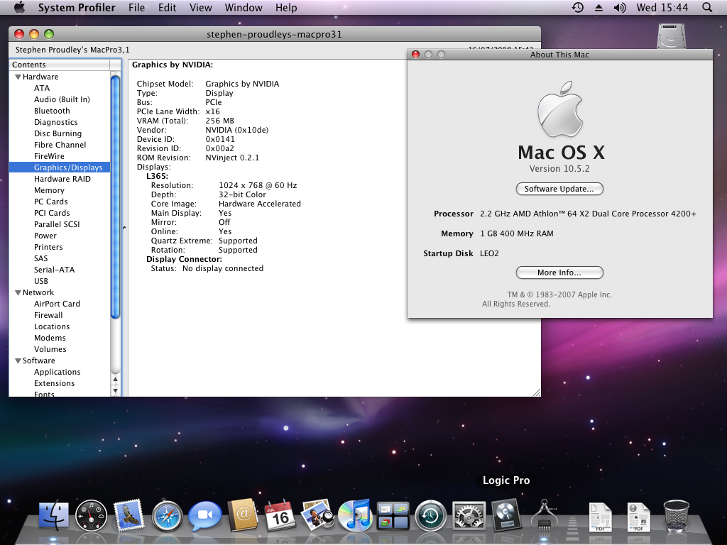

bl003r Posted September 28, 2008 Share Posted September 28, 2008 I'm running Logic Pro with no issues at all through a digi003R Link to comment https://www.insanelymac.com/forum/topic/114574-logic-studio-on-hack-compatible-firewire-cards/#findComment-908974 Share on other sites More sharing options...
Khan_Man Posted September 28, 2008 Share Posted September 28, 2008 Running Logic Express 8.0.2. Having some problems with drop outs on my Firepod in Kalyway 10.5.2 and 10.5.2 but the same setups work fine in Tiger. Problem seem to be between Leopard, firewire cards and Firepod. I'd recommend U get a TI firewire card, might help keep Murphy away (as in Murphy's law). Khan Link to comment https://www.insanelymac.com/forum/topic/114574-logic-studio-on-hack-compatible-firewire-cards/#findComment-908980 Share on other sites More sharing options...
