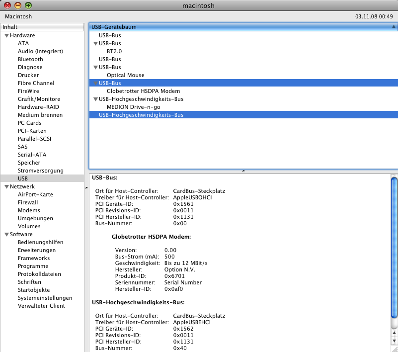

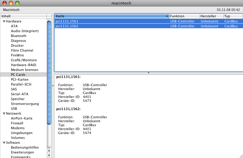

djmastera2000 Posted November 3, 2008 Share Posted November 3, 2008 Most PCMCIA devices are attached to the usb bus. Me e.g, with chunnan's pccard patches i have two pcmcia devices shown in system-profiler, but i have one pcmcia slot in my book only. The first one is pccard, the other device is the card reader, but not recognized by osx as is... PCCard works, but if i insert e.g. an sd card nothing happens, no mount activities: hotplug problems, insert device id anywhere?? But i think it should work because it it recognized by osx(see pics). But when i insert a pcmcia 5in1 reader into the pccard slot, it works, i can read/write all supported cards... Any suggestions? Link to comment https://www.insanelymac.com/forum/topic/108321-internal-card-reader/#findComment-953176 Share on other sites More sharing options...
