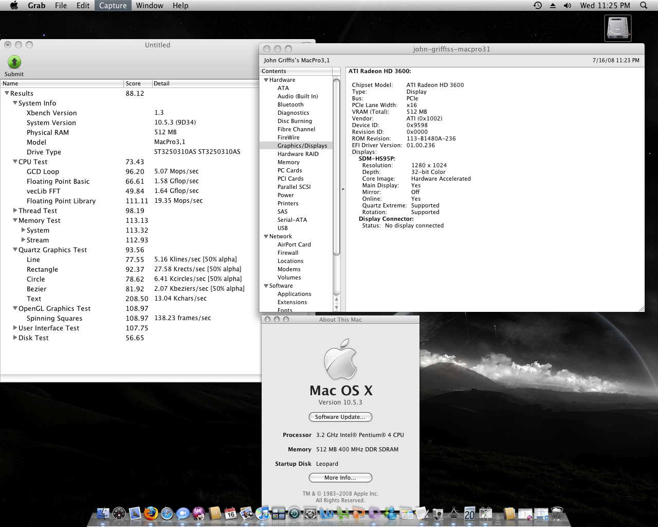

gfoury Posted July 16, 2008 Share Posted July 16, 2008 Ohai everyone !ATI Radeon HD 3650 Device ID:9598 Download Works for me on a Sapphire HD 3650 if I install it with Pacifist instead of running the installer. (Actually I only extracted the extensions to get it working, I skipped the OpenGL goo, but I probably already had the OpenGL stuff installed.) Dual DVI-D outputs work, with one strange exception: the monitors are detected as swapped. The 1920x1200 LCD gets 1600x1200 output, and the 1600x1200 display gets 1920x1200 output. So every time I boot I have to go behind the computer and swap cables. My guess is that the GPIO lines are swapped relative to what the driver expects. (I'm too lazy to track down how the DDC bus works on these cards; I figure that anybody who can fix this problem already knows.) Link to comment https://www.insanelymac.com/forum/topic/107526-ati-radeon-hd-pkg-installers-105x-106/page/9/#findComment-821636 Share on other sites More sharing options...

gfoury Posted July 16, 2008 Share Posted July 16, 2008 Your Sapphire HD 3650 is a PCI-e card right? I have an AGP version of the card, not PCI-e. When I tried the installer, it didn't work. The first time it caused a kernel panic, the second time it just didn't do anything. Yeah, PCI-e. I haven't seen kernel panics in my flailing at it. I'm not all that happy with how loud this 3650 is. Maybe once 34x0 support stabilizes I'll swap somebody for it. Good luck with your card. Link to comment https://www.insanelymac.com/forum/topic/107526-ati-radeon-hd-pkg-installers-105x-106/page/9/#findComment-821703 Share on other sites More sharing options...
