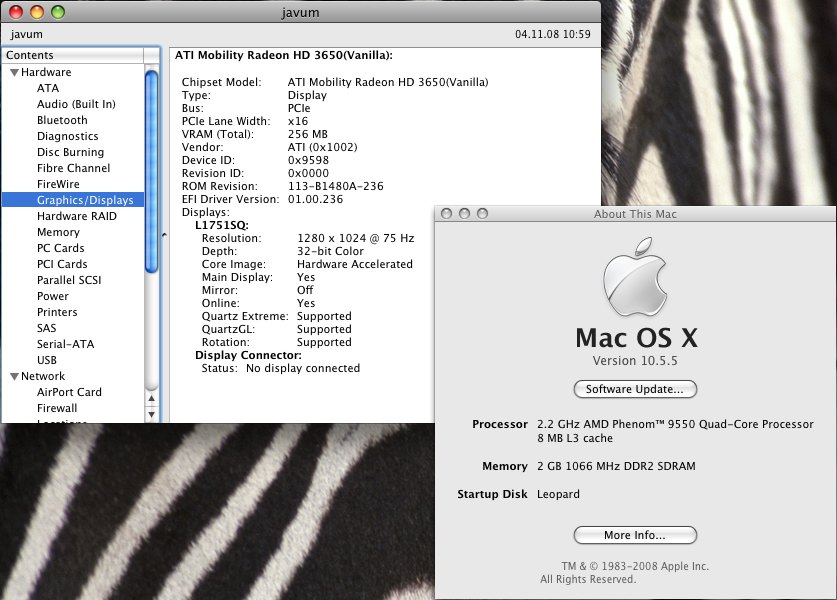

ridgeline Posted November 4, 2008 Share Posted November 4, 2008 I added $10 and replace my HD3470 with HD3650 (dev_id:9598) and with latest kexts (ATI_NEW.zip) from this tipic it works Big Thanks to lastExile and Eps What system did you do this with? I have a studio and if this is a last resort for me at least I would know...... Thanks, Mark Link to comment https://www.insanelymac.com/forum/topic/107526-ati-radeon-hd-pkg-installers-105x-106/page/34/#findComment-954804 Share on other sites More sharing options...

javum Posted November 5, 2008 Share Posted November 5, 2008 What system did you do this with? I have a studio and if this is a last resort for me at least I would know......Thanks, Mark The system is in the post signature (desktop) - the card only recognized as Mobility (I can fix by editing Natit Info.plist, but it doesn't matter). Link to comment https://www.insanelymac.com/forum/topic/107526-ati-radeon-hd-pkg-installers-105x-106/page/34/#findComment-955573 Share on other sites More sharing options...
