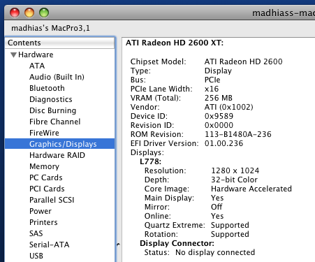

madhias Posted October 27, 2008 Share Posted October 27, 2008 Thank you, my HD 2600 Pro works perfect.I used the ATI Radeon HD 2600 Pro AGP driver, the only thing I had to do is to add my card's revision to the Info.plist file thank you again! Hey, which System do you have? Which 2600Pro Card? Link to comment https://www.insanelymac.com/forum/topic/107526-ati-radeon-hd-pkg-installers-105x-106/page/31/#findComment-945301 Share on other sites More sharing options...

madhias Posted October 28, 2008 Share Posted October 28, 2008 Horay! I bought today instead of my crappy old Ati X300 a HD2600 Pro for 35 Euro (Gecube, PCIe, 256MB, without cooler) and downloaded this package for the HD2600Pro, made a restart and it works. WOW. Great work! Link to comment https://www.insanelymac.com/forum/topic/107526-ati-radeon-hd-pkg-installers-105x-106/page/31/#findComment-946905 Share on other sites More sharing options...
