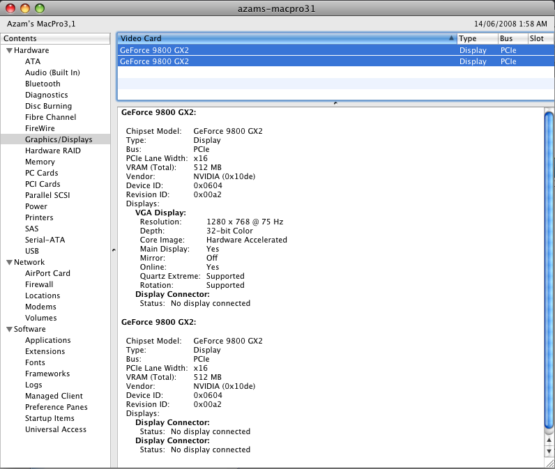

Azamic Posted June 13, 2008 Share Posted June 13, 2008 SUCCESS!!!! I can see 512MB on each of my 9800GX2 cores!!! The best part, Leopard recognizes my cards as GeForce 9800 GX2 and its QE/CI enabled!!! So in short, my 9800 GX2 has no shortfalls on Leopard now. The problem as I mentioned earlier was due to the usage of older kexts. I have uploaded the kexts working on my system (CAUTION! only compatible with 9800GX2) here. Note: These kexts may not work with non-Nvidia motherboards. Link to comment https://www.insanelymac.com/forum/topic/101121-dual-9800-gtx-512-working-in-osx86/page/5/#findComment-782726 Share on other sites More sharing options...
