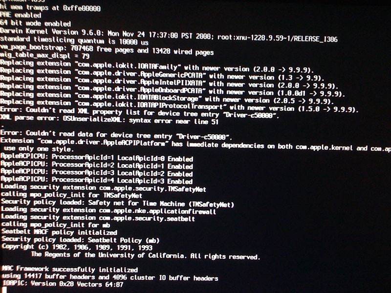

mrbonkers Posted February 24, 2009 Share Posted February 24, 2009 my com would hang just before the login screen and i have to do a hard reset. i solved this by changing(the font in red). it boots and i get QE/CI but when i connect a monitor to the second card, it does not work. <?xml version="1.0" encoding="UTF-8"?><!DOCTYPE plist PUBLIC "-//Apple//DTD PLIST 1.0//EN" "http://www.apple.com/DTDs/PropertyList-1.0.dtd"> <plist version="1.0"> <dict> <key>PciRoot(0x0)/Pci(0x1,0x0)/Pci(0x0,0x0)</key> <dict> <key>@0,compatible</key> <string>NVDA,NVMac</string> <key>@0,device_type</key> <string>display</string> <key>@0,name</key> <string>NVDA,Display-A</string> <key>@1,compatible</key> <string>NVDA,NVMac</string> <key>@1,device_type</key> <string>display</string> <key>@1,name</key> <string>NVDA,Display-B</string> <key>@2,#adress-cells</key> <string>0x01000000</string> <key>@2,#size-cells</key> <string>0x00000000</string> <key>@2,compatible</key> <string>NVDA,sensor-parent</string> <key>@2,device_type</key> <string>NVDA,gpu-diode</string> <key>@2,hwctrl-params-version</key> <string>0x02000000</string> <key>@2,hwsensor-params-version</key> <string>0x02000000</string> <key>@2,name</key> <string>sensor-parent</string> <key>@2,reg</key> <string>0x02000000</string> <key>NVCAP</key> <data> BAAAAAAAAwAMAAAAAAAABwAAAAA= </data> <key>NVPM</key> <data> AQAAAAAAAAAAAAAAAAAAAAAAAAAAAAAAAAAAAA== </data> <key>VRAM,totalsize</key> <data> AAAAIA== </data> <key>device_type</key> <string>NVDA,GeForce</string> <key>model</key> <string>NVIDIA GeForce 9800 GTX DDL</string> <key>name</key> <string>NVDA,Parent</string> <key>rom-revision</key> <string>3172a</string> </dict> <key>PciRoot(0x0)/Pci(0x1c,0x0)/Pci(0x0,0x0)</key> <dict> <key>@3,compatible</key> <string>NVDA,NVMac</string> <key>@3,device_type</key> <string>display</string> <key>@3,name</key> <string>NVDA,Display-A</string> <key>@4,compatible</key> <string>NVDA,NVMac</string> <key>@4,device_type</key> <string>display</string> <key>@4,name</key> <string>NVDA,Display-B</string> <key>@2,#adress-cells</key> <string>0x01000000</string> <key>@2,#size-cells</key> <string>0x00000000</string> <key>@2,compatible</key> <string>NVDA,sensor-parent</string> <key>@2,device_type</key> <string>NVDA,gpu-diode</string> <key>@2,hwctrl-params-version</key> <string>0x02000000</string> <key>@2,hwsensor-params-version</key> <string>0x02000000</string> <key>@2,name</key> <string>sensor-parent</string> <key>@2,reg</key> <string>0x02000000</string> <key>NVCAP</key> <data> BAAAAAAAAwAMAAAAAAAABwAAAAA= </data> <key>NVPM</key> <data> AQAAAAAAAAAAAAAAAAAAAAAAAAAAAAAAAAAAAA== </data> <key>VRAM,totalsize</key> <data> AAAAIA== </data> <key>device_type</key> <string>NVDA,GeForce</string> <key>model</key> <string>NVIDIA GeForce 9800 GTX DDL</string> <key>name</key> <string>NVDA,Parent</string> <key>rom-revision</key> <string>3172a</string> </dict> </dict> </plist> Link to comment https://www.insanelymac.com/forum/topic/101121-dual-9800-gtx-512-working-in-osx86/page/6/#findComment-1089952 Share on other sites More sharing options...
dgently Posted April 5, 2009 Share Posted April 5, 2009 my com would hang just before the login screen and i have to do a hard reset. i solved this by changing(the font in red). it boots and i get QE/CI but when i connect a monitor to the second card, it does not work. I just attempted the same thing. Ditto on the result. I get it to boot and both monitors on the main card work perfectly QI/CE and all... but nada for the second card. It shows up in system profiler and is recognized correctly but doesn't show that any displays are available. plugged in or not. I can post my string if anybody thinks they can help solve this. Ive tried mucking about with some of the other plist entries but nada. Link to comment https://www.insanelymac.com/forum/topic/101121-dual-9800-gtx-512-working-in-osx86/page/6/#findComment-1125200 Share on other sites More sharing options...

_nox Posted May 1, 2009 Share Posted May 1, 2009 Dear InsanelyMac Forums, Hello. About 6 months ago, I followed a tutorial on how to run an nVIDIA GeForce 9800 GTX on a Hackintosh (10.5.3). It worked fantastically and I thank all of you for that, and all the work that's gone into stuff. You guys are life savers. I have recently added a second 9800 GTX and would like to enable both of these cards (I understand SLi is not possible, but more monitors = better). I found this thread, and understand we have gotten dual 9800 GTX's working. I was wondering if someone would be so kind as you give me some instructions on how exactly you did this. The posts I've read seemed a little bit lacking in step-by-step instructions, which unfortunately is what I think I need. I would greatly, greatly appreciate this. Thanks a bunch guys, this really means a lot to me. nox Link to comment https://www.insanelymac.com/forum/topic/101121-dual-9800-gtx-512-working-in-osx86/page/6/#findComment-1146234 Share on other sites More sharing options...
