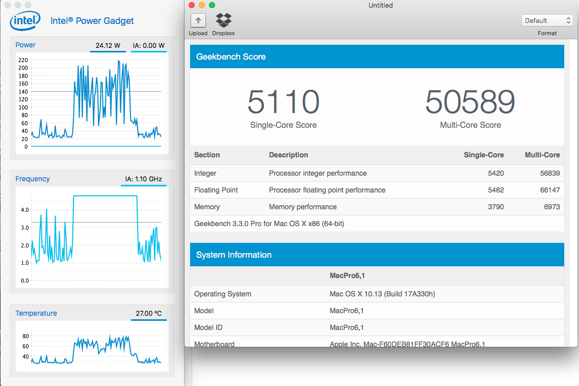

surfinchina Posted August 20, 2017 Author Share Posted August 20, 2017 That is FANTASTIC !!! I know that I'm getting 59,000+ but I'm using Dual CPUs. Can't wait to build one of these. So why did you choose that Gigabyte board and not Asus? Just curious. Also with a score like that I wonder what GB scores you'd get with a Dual CPU setup when that comes out? 95,000+ would look real nice... But you're current setup is really nice! I wonder, can you run 2 x AMD cards on this setup and would they both work? A few reasons, My hacks with Gigabyte are always easier, the USB DAC on the Aorus 9 are outstanding and I like good music, and it has a USB header by the sata. My 360 rad blocks off the entire bottom of the mobo which means I couldn't connect the case USBs with the Asus. And finally the black goes better than white with my build There are a few cases on this site of guys running dual Vega with high Sierra... http://www.insanelymac.com/forum/topic/325120-vega-frontier-edition-on-high-sierra/page-3 My design software likes high single core performance a lot of the time and then for rendering it uses all cores, so an overclocked i9 is perfect! When the 18 core comes out I'll sell the 10 core and get the big one I found my output with multi CPUs goes down because of their poor single core performance. I only render a couple of sessions a week. Thanks a lot for the kext file. By the way would this X299 work with 2 x AMD cards? Yes this board is good for it, but any ATx board will be fine If you get a 7900, you need to allow for excellent cooling. water-cooled 360 rad is minimum. AIO 360 is ok. I have a 420 rad plus a 360 and that is ideal. Link to comment Share on other sites More sharing options...

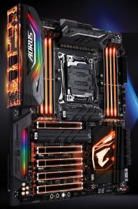

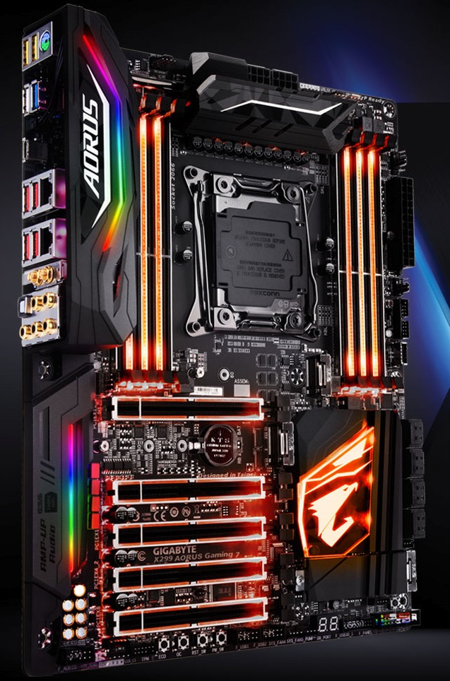

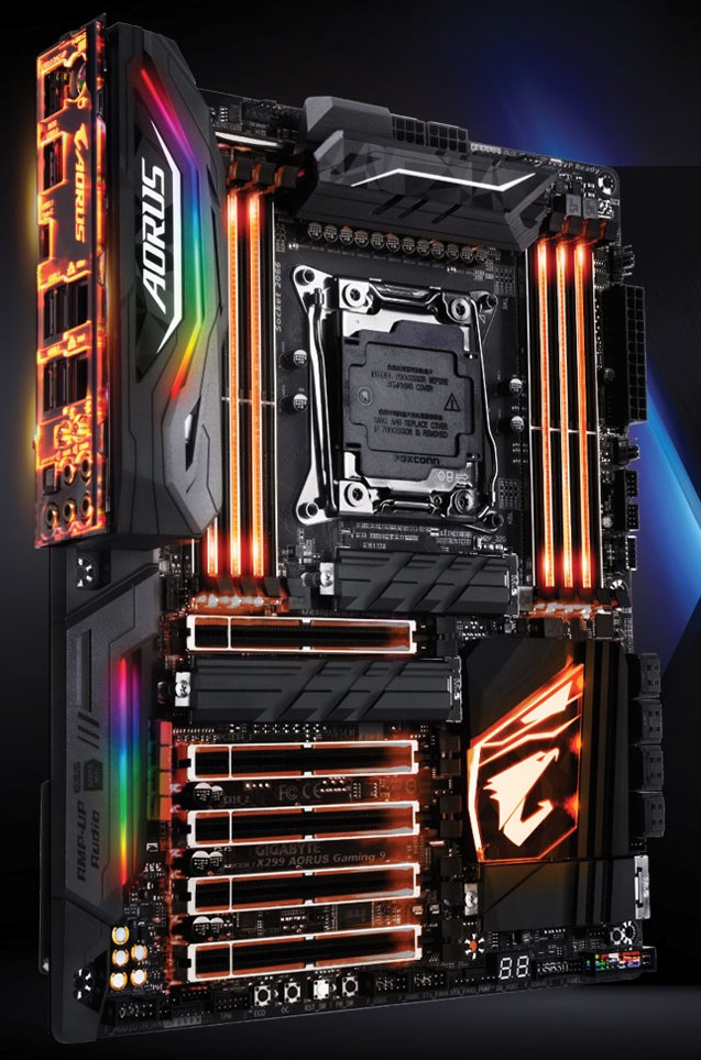

PunkNugget Posted August 22, 2017 Share Posted August 22, 2017 Unless I'm mistaken the AORUS 7 and AORUS 9's PCIe slots are identical. The board as a whole is identical with some extra stuff added for the AORUS 9. If I ever get the time, I'd like to get MacMod of the Month kickin' again. We'll see what happens in the near future... Link to comment Share on other sites More sharing options...
surfinchina Posted August 22, 2017 Author Share Posted August 22, 2017 Unless I'm mistaken the AORUS 7 and AORUS 9's PCIe slots are identical. The board as a whole is identical with some extra stuff added for the AORUS 9. Gigabyte X299 AORUS Gaming 7.jpg Gigabyte X299 AORUS Gaming 9.jpg If I ever get the time, I'd like to get MacMod of the Month kickin' again. We'll see what happens in the near future... Oh, the difference is that IF you have 3 GPU, the gaming 9 works in 16x, 8x, 16x. The gaming 7 works in 16x, 16x, 8x. With 2 GPU they will both always work 16x. I think because the gaming 9 has that extra M.2 between slots 1 and 2. the gaming 9 also comes with a matchy PCIE M.2 card giving you 4 M.2 in total. My VRM/CPU cooler is shipping next week, I'll take a pic once it's on Link to comment Share on other sites More sharing options...

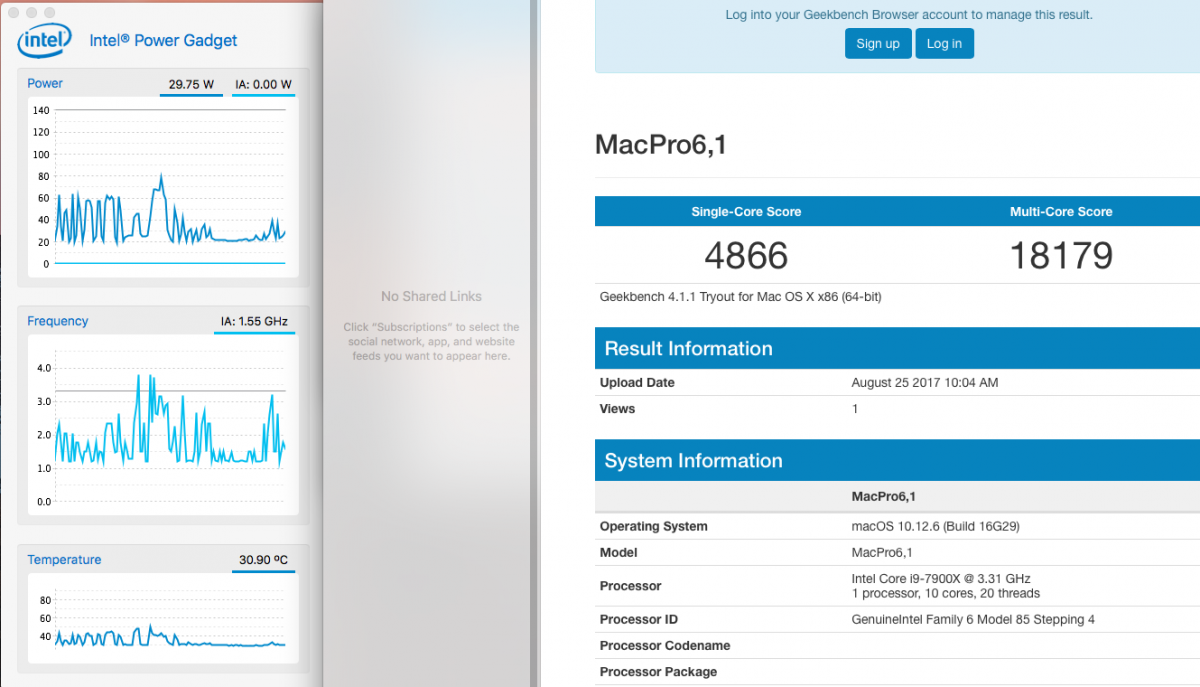

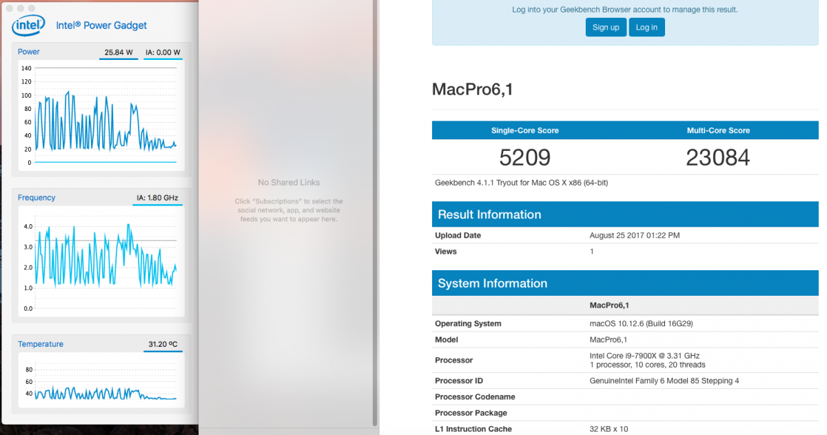

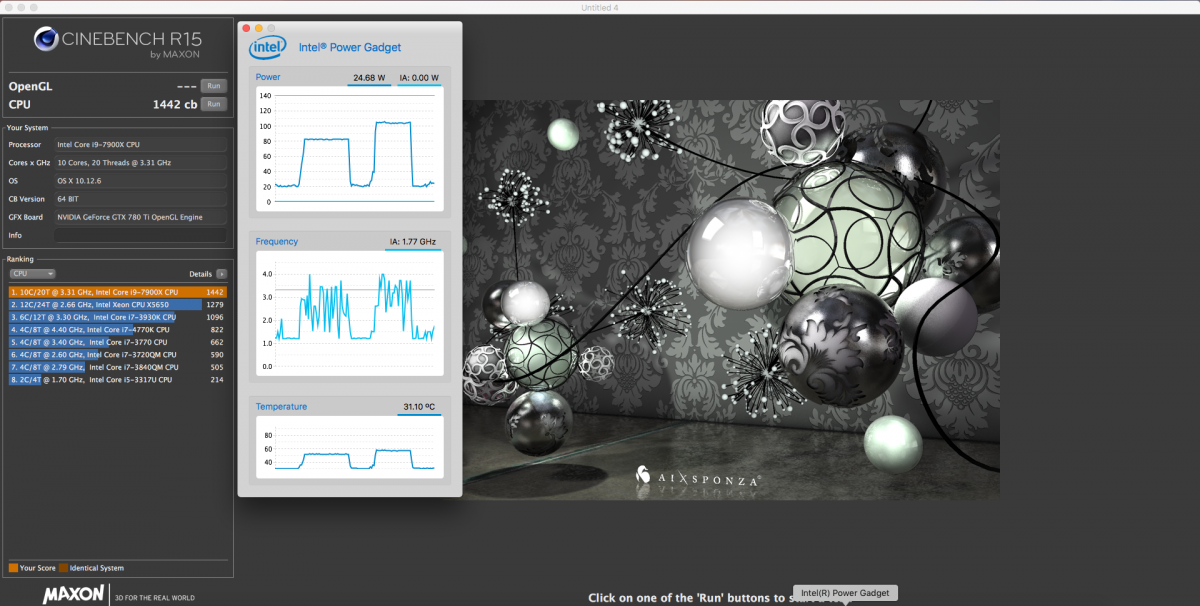

Philterino Posted August 25, 2017 Share Posted August 25, 2017 Hi, First off big thanks to Surfchina... I finally got a boot using your EFI. Thanks! I dont seem to be getting anywhere near the Geekbench scores you are getting... see attached. I haven't done any overlocking... is that it? or is there something else that might not be working? any help whelp or point in the right direction would be very much appreciate! x299 Gigabyte UD4 i9-7900x gtx780ti P.S. I know nothing about xcpm Link to comment Share on other sites More sharing options...
Philterino Posted August 25, 2017 Share Posted August 25, 2017 Update: I changed frequecyVectors to MacBook Pro as suggested in the first post of the other thread. and it has improved a bit. not sure what I should look at next. Link to comment Share on other sites More sharing options...
