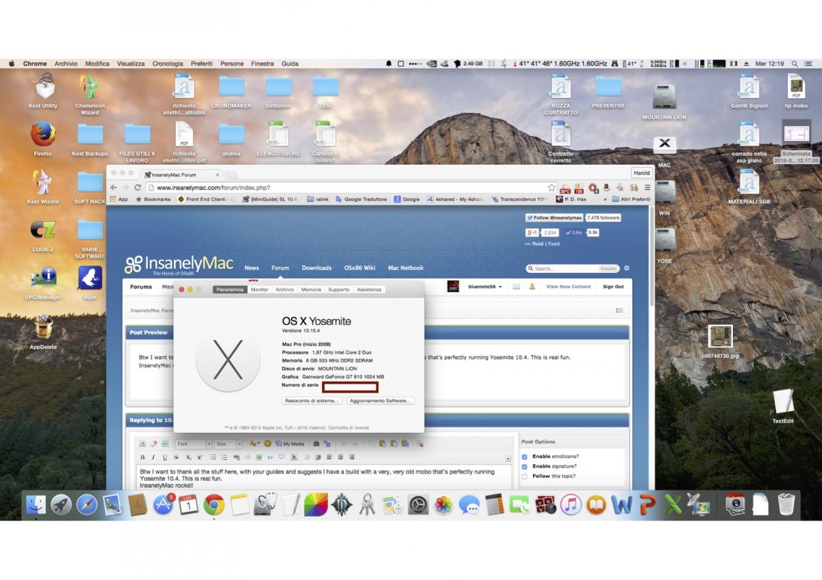

bluenote56 Posted July 1, 2015 Share Posted July 1, 2015 Just for feedback. This time I could update but I had to install again modified AppleIntelFramebufferCapri and AppleIntelSNBGraphicsFB kexts from backup to have HD 3000 working as well as audio kexts for ALC892. For an old issue (I never understood what kind of problem it is) I also had to put OpenCL framework from Mavericks to get Preview working and no related graphic issues. Link to comment Share on other sites More sharing options...

bluenote56 Posted July 1, 2015 Share Posted July 1, 2015 Btw I want to thank all the stuff here, with your guides and suggests I have a build with a very, very old mobo that’s perfectly running Yosemite 10.4. This is real fun. InsanelyMac rocks!! 1 Link to comment Share on other sites More sharing options...
