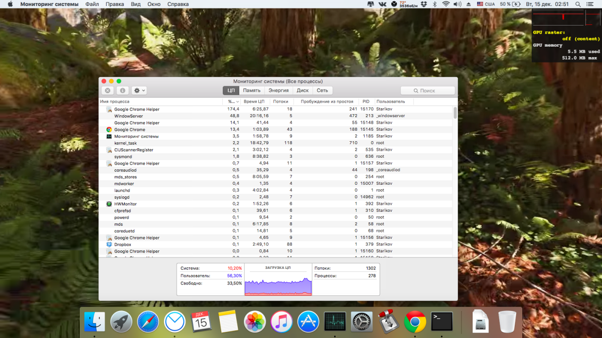

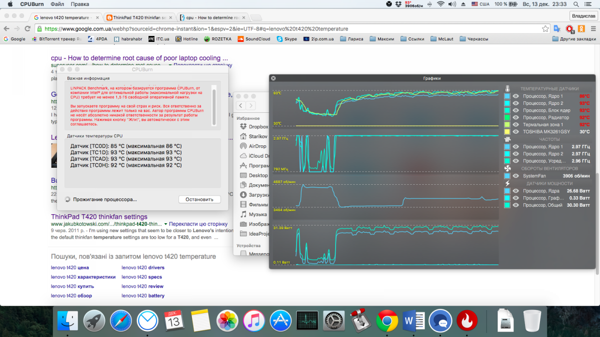

Hi. I have some questions about temperature of my T420 with i5 2520m. When i watch 1080p video on youtube or work with powerful software, temperature is above 75 degrees and up to 85 degrees. It normal? Notebook is clean and have new thermal paste. In CPU burn i got temperature 93 degrees. Now while I editing this post I have temperature about 47-48 degrees.
And I have some trouble with performance. Sometimes it so many lags. 1080p 60fps video on youtube lags. When I launch Word 2016, Intellij IDEA, airmail and chrome, I have few seconds latency in text input! It very hard to programming. It normal? I use 7200rpm 320gb HDD. Time to replace it with SSD?
@Xsmile2008
the temperature seems about right for high CPU - i see the same thing for heavy use. somethings i push the ThinkVantage Blue button to force the fan to run at maximum speed if am doing a lot of CPU intensive work. There are a few Fan control programs that can provide more linearity on heat vs speed.  i use Mac Fans Control.
Well on Disk issue,  i will say once you run from an SSD you will never want to go back to spinning disk! my lenovo T420 cold boots to login in under 2 seconds vs 20-30 seconds.  I run VMware a lot and there is no contest. i am not sure IO wait what is causing your system lags or not.
Do you have lags when watching 1080p60fps video on youtube? Why it need so much cpu resources. CPU load is about 170-230% (full load 1-2 threads of 4). Youtube is not use GPU for video rendering?
I turn on developers features in chrome and see this
Why it use only 5mb of VRAM for 1080p60fps?
