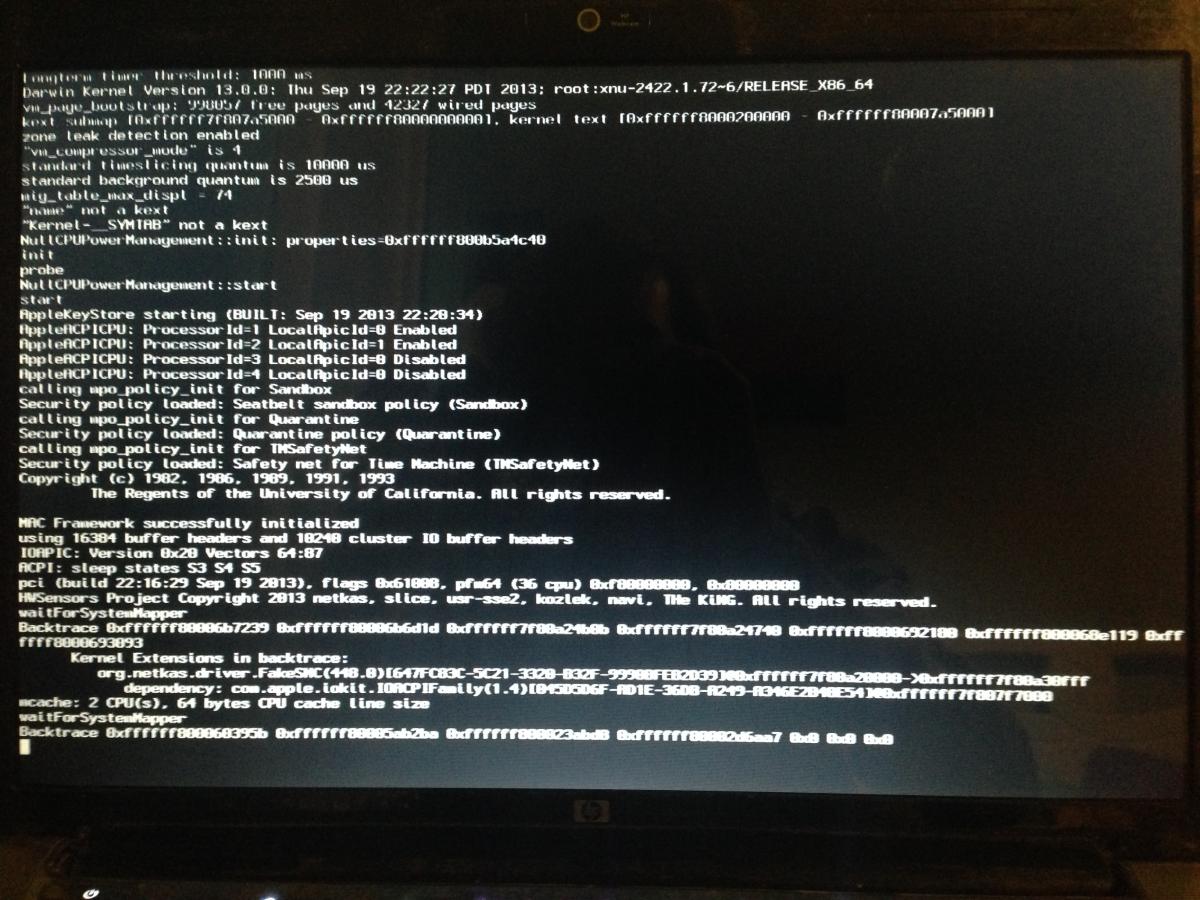

Hello i did everything as you explained in the post but i can't get it to boot, it just boots with -x and after i install is the same thing it hangs exactly in the same place i'll post here a picture of where it hangs.
I have mountain lion installed in this pc and everything works just fine..
Thanks
ups the image is upside down but i can't get it right to here hope you guys can understand it
Thanks a lot i've reuploaded the image now

I dont think it would be from the graphics because the system even on safe mode can detect my graphic card. I have an hp dv5-1040ep core 2 duo 9600m gt and 4gb ddr 2 ram, i have the mountain lion fully working, and now wanted to upgrade to mavericks, wich kexts should i use from ML if any?

Hello
Try configure your Bios: http://olarila.com/forum/viewtopic.php?f=2&t=1804
Try boot with -x -f -v
And please, post your hardware speficications...
I do believe I have tried installing those kexts but ill give it another go and check back.
Do you only have problem with ps/2?
update the cache of S/L/E folder
put those spects in your signature, will be more easy to see them

Wich hardware specifications you want? i told you my graphic card, and i don't think its bios problem since i have in this same computer a working hackintosh of mountain lion,
This is my hardware specs:
http://h10025.www1.hp.com/ewfrf-JAVA/Doc/pdf/c01560085.pdf
i can boot with -x but i wanted to fix that, i want to boot without being in safe mode, because in safe mode i can't do much thing :/
Thank you
Hello.
Your problem is graphics…
If you only can boot to system with -x… so boot to system with -x and active your graphics by there.
What boot loader you want use? Chameleon?
Chameleon is more easy to configure…
Try active with GraphicsEnabler=Yes on org.chameleon… or with Chameleon Wizard app
If it doesn’t work, try GraphicsEnabler=No

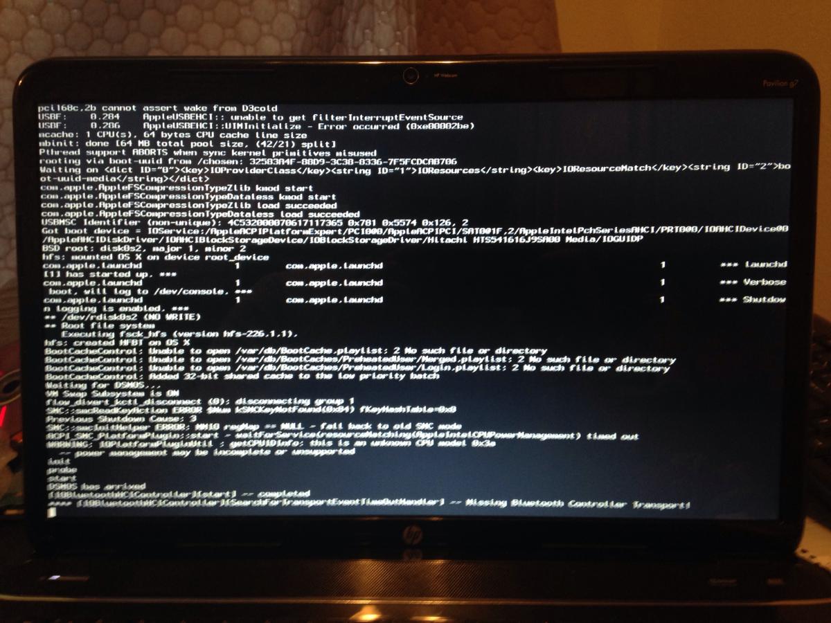

I have followed the guide to the T and I'm having hang ups. I have to boot with cpus=1 in order to get it where it won't panic. It hangs after the Bluetooth thing when I boot -v. Screenshot attached.
EDIT: SOLVED- booted in safe mode (-x) and deleted every kext with Bluetooth in the name from S/L/E.
