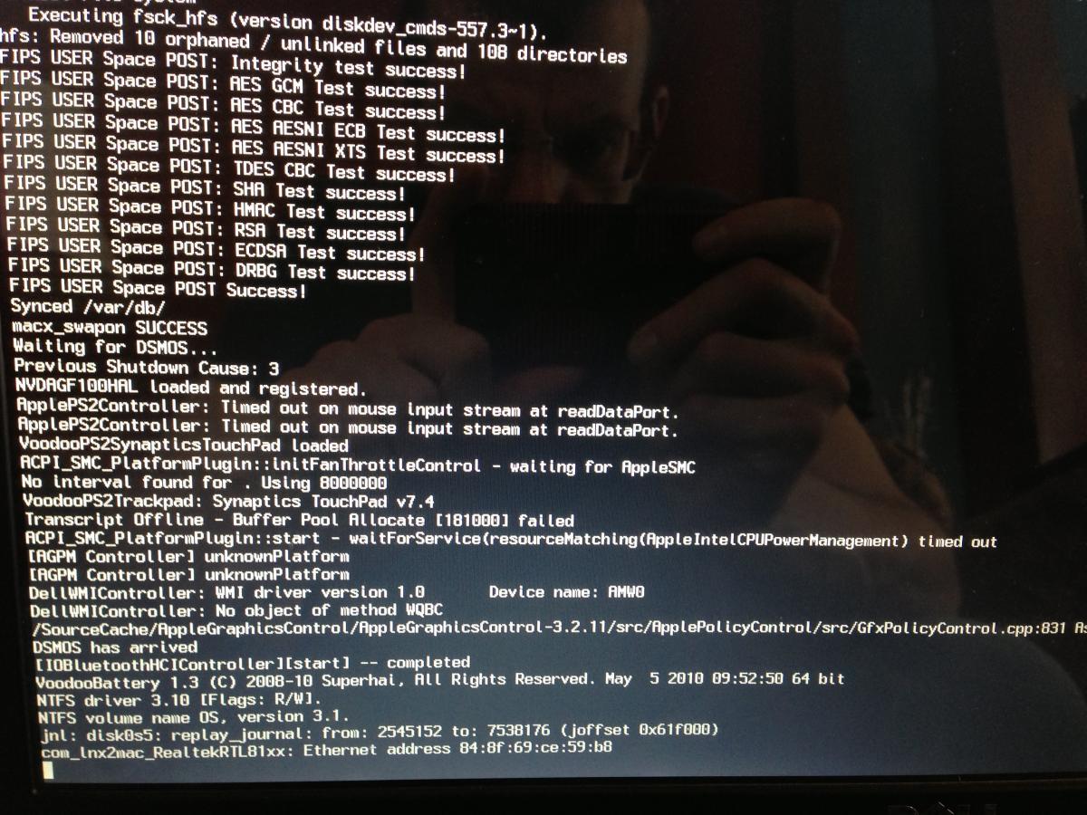

In need of help after fixing the boot conflict, I am not able to boot 10.8.3 unless I use -v -x, when I use just -v the system hangs at "still waiting for root device" this happens just after
com.apple.applefscompressiontypedataless load succeeded
[realtexrtl81xx:init] Using Updated PHY config method
[realtekRtl81xx:init] init completed
[rtl81xx@0x2000:rtl8168_init_board] NIC identified as rtl8168E/8111E (mcfg=14)
I am using the latest chameleon boot loader, with the dsdt from the kexts Pack. Intel I5 2450M, 25 bus ratio non-3d model
Any help would be great

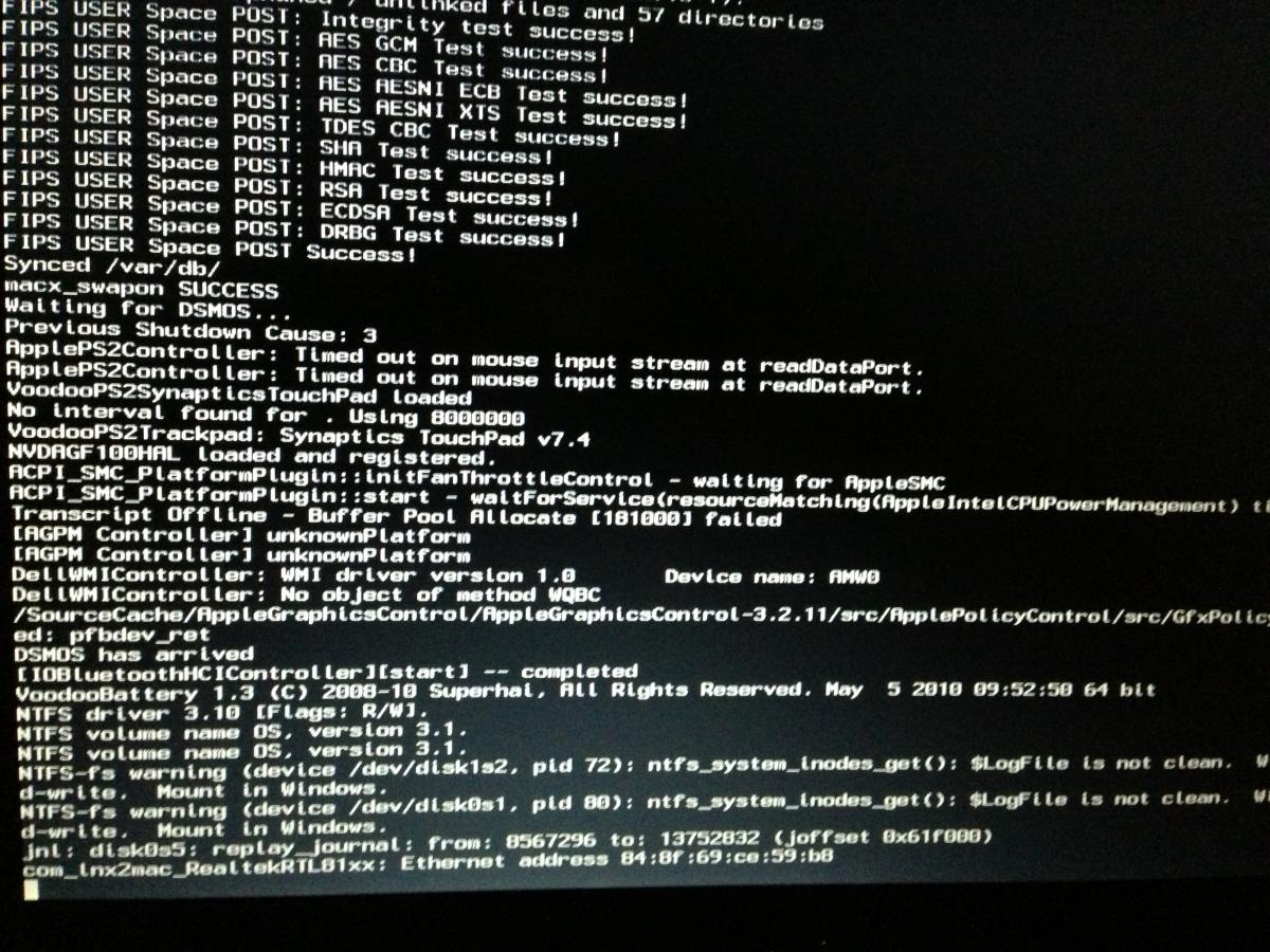

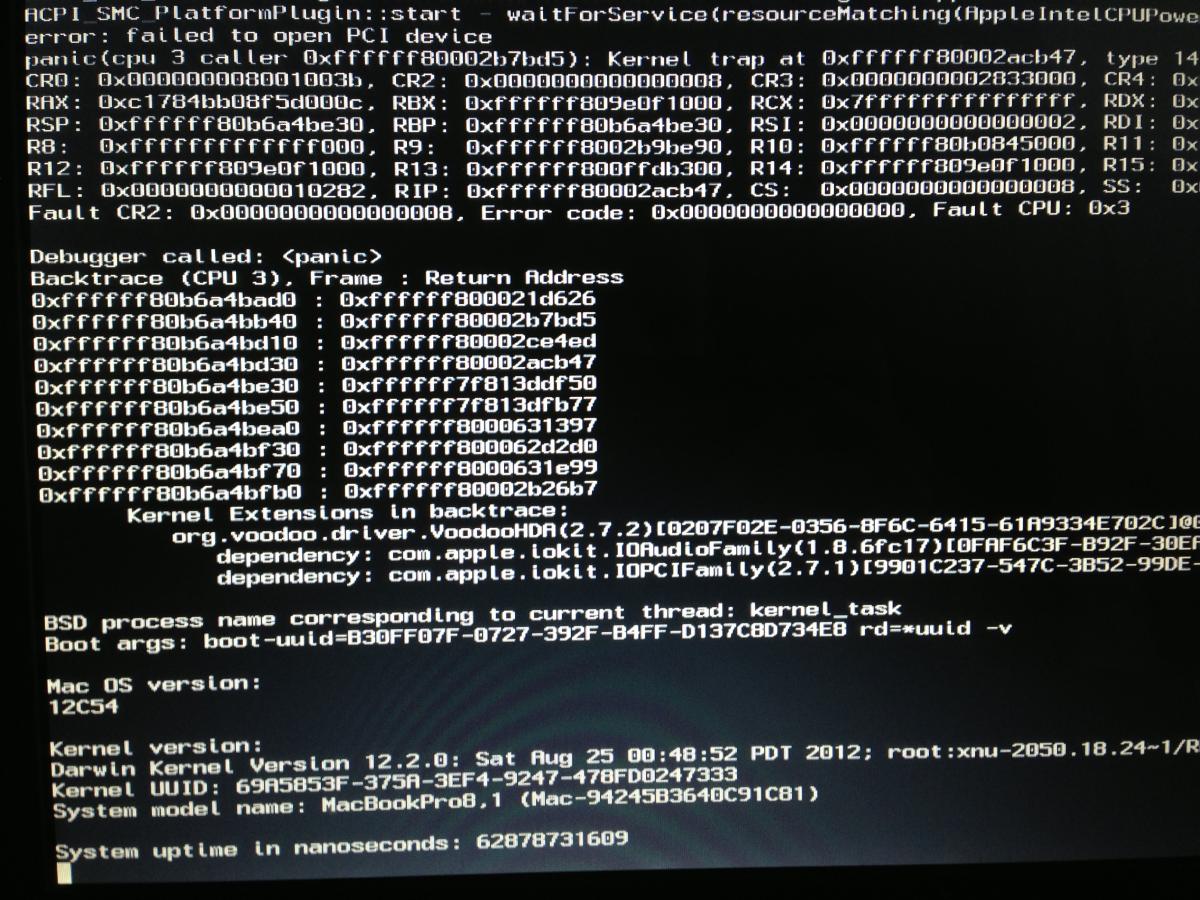

So i used the appleacpiplatform.kext from the original dmg image of ML 10.8.2 when I boot with just -v the system hangs, looks like panics on the cpu's. I removed the dsdt.aml thinking that might be causing the issue but apparently its not.
@ Chrisemtpa
You don't need to patch any other kexts besides the one in the Kext pack on the first page for 10.8.2 as you don't need some of the kexts with the unlocked A19 bios. I assume you are using that from your sig. Make sure you have DSDT in your extra folder. I don't see SSDTs for your CPU in the kext pack but I assume you might have them.
The error in your screenshot is VoodooHDA just remove it from S/L/E for now and see if it lets you through.

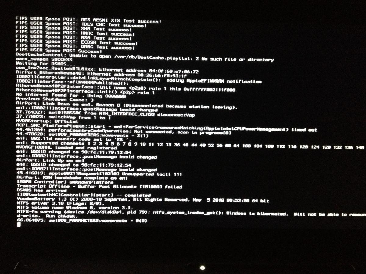

I did all the above suggestion now I get stuck at this screen...Anymore ideas? Where do i find the unlocked a19 bios? Mine is definitely not unlocked and it is still freezing after the realtek line in the screen shot below

Ok so i removed Apple HDA, and rolled back to apppleacpiplatform.kext and still unable to boot without use of -x, I went back and used the l702x kexts for the dell still can't boot without -x. I have the unlocked bios with (AHCI?) hard drive enabled. Also when I restart or shut down 10.8.2 it hangs on a gray screen with just the mouse cursor.
