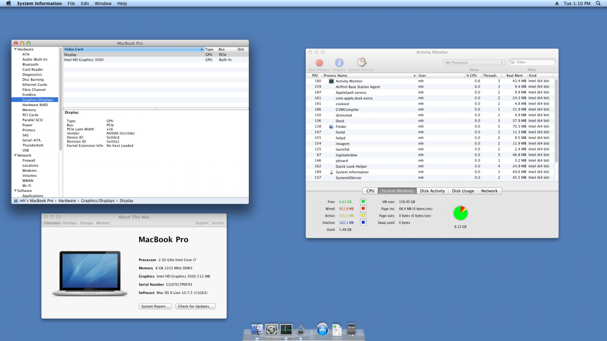

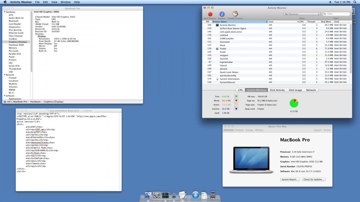

mackyreddy Posted July 6, 2013 Author Share Posted July 6, 2013 @ webcivilian Even the memory consumption problem has been resolved with the new DSDT. So can you confirm it by taking screenshots of Activity Monitor Memory consumption with different DSDT's ( From the new Kext Pack). I want to have a look at it. @ Everyone I would recommend everyone to update to the latest DSDT, as its one of the best available & better optimized DSDT for our laptop. Link to comment https://www.insanelymac.com/forum/topic/273500-macos-ventura-on-dell-xps-17-l702x-optimus/page/31/#findComment-1930588 Share on other sites More sharing options...

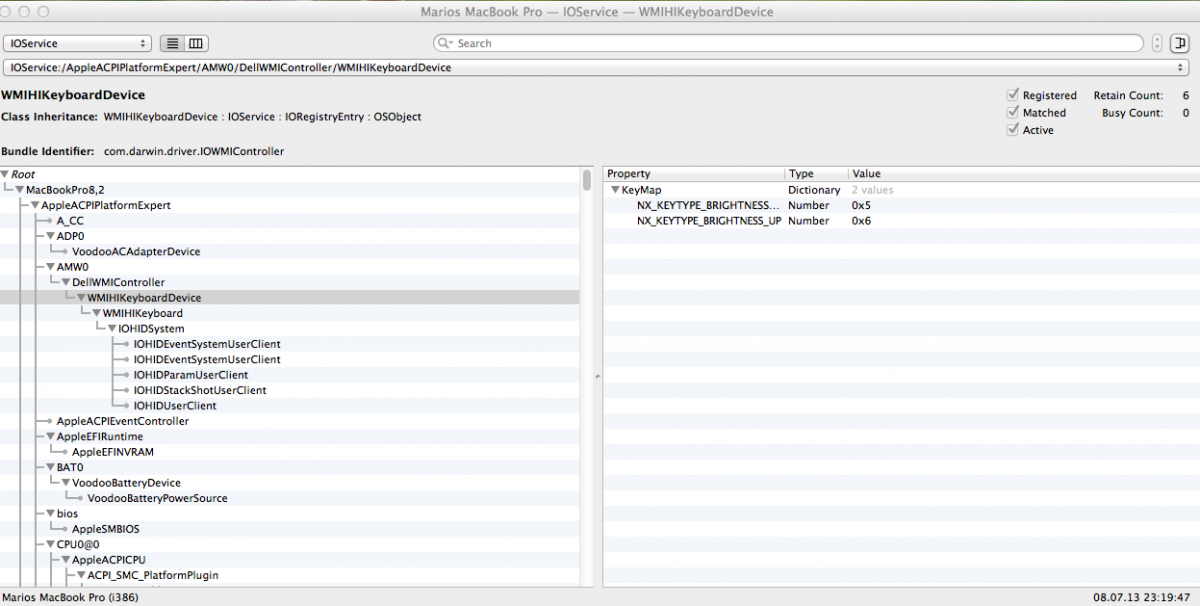

TimeWalker75a Posted July 8, 2013 Share Posted July 8, 2013 Tried it, but did not work. Use A12 Bios, because this gives me best sleep/wake. Here is my DSDT. Hope to find a solution, because this is the only thing not working left (ok there is the intel wifi ;-) but thats just impoosible and found an alternative) Thanks in advance Do you see a device like this in your Registry ? http://cl.ly/image/3g0e1G1n1B06 You should see the kext being attached properly if you've done the edits, but your memory OperationRegions are worng. If you don't see it, then you've failed to install the kext properly. Link to comment https://www.insanelymac.com/forum/topic/273500-macos-ventura-on-dell-xps-17-l702x-optimus/page/31/#findComment-1930975 Share on other sites More sharing options...
TechMo Posted July 8, 2013 Share Posted July 8, 2013 Do you see a device like this in your Registry ? http://cl.ly/image/3g0e1G1n1B06 You should see the kext being attached properly if you've done the edits, but your memory OperationRegions are worng. If you don't see it, then you've failed to install the kext properly. Where can i find the Registry? Link to comment https://www.insanelymac.com/forum/topic/273500-macos-ventura-on-dell-xps-17-l702x-optimus/page/31/#findComment-1930992 Share on other sites More sharing options...
TimeWalker75a Posted July 8, 2013 Share Posted July 8, 2013 IORegistryExplorer? Link to comment https://www.insanelymac.com/forum/topic/273500-macos-ventura-on-dell-xps-17-l702x-optimus/page/31/#findComment-1930994 Share on other sites More sharing options...
TechMo Posted July 8, 2013 Share Posted July 8, 2013 IORegistryExplorer? There it is. Whats the matter then and how can i fix it ;-) Thanks for your help :-) Link to comment https://www.insanelymac.com/forum/topic/273500-macos-ventura-on-dell-xps-17-l702x-optimus/page/31/#findComment-1931056 Share on other sites More sharing options...
TimeWalker75a Posted July 8, 2013 Share Posted July 8, 2013 If you have a copy of windows installed (uefi) or a licecd of ubuntu 12.04 or higher (uefi grub2) do dump your dsdt from one of the OSes forementioned to see what are your memory regions as of now. Link to comment https://www.insanelymac.com/forum/topic/273500-macos-ventura-on-dell-xps-17-l702x-optimus/page/31/#findComment-1931060 Share on other sites More sharing options...
