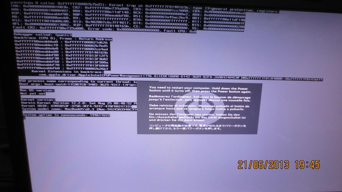

jaygala8 Posted June 21, 2013 Share Posted June 21, 2013 I tried installing the iAtkos ML2 using a DVD as i had the image burned to DVD from a long time & deleted that onto my L502X As per ur instructions i deleted & copied the new files from the zip file but when I boot into ML2 "Restart error" comes & i have uploaded a image of that. Help needed. Thank You. Link to comment https://www.insanelymac.com/forum/topic/273500-macos-ventura-on-dell-xps-17-l702x-optimus/page/29/#findComment-1926407 Share on other sites More sharing options...
Brabbelbla Posted June 23, 2013 Share Posted June 23, 2013 The driver causing the kernel panic is AppleIntelCPUPowerManagement, i'd say that points to not having the right SSDTs in te the right place. Link to comment https://www.insanelymac.com/forum/topic/273500-macos-ventura-on-dell-xps-17-l702x-optimus/page/29/#findComment-1927076 Share on other sites More sharing options...
