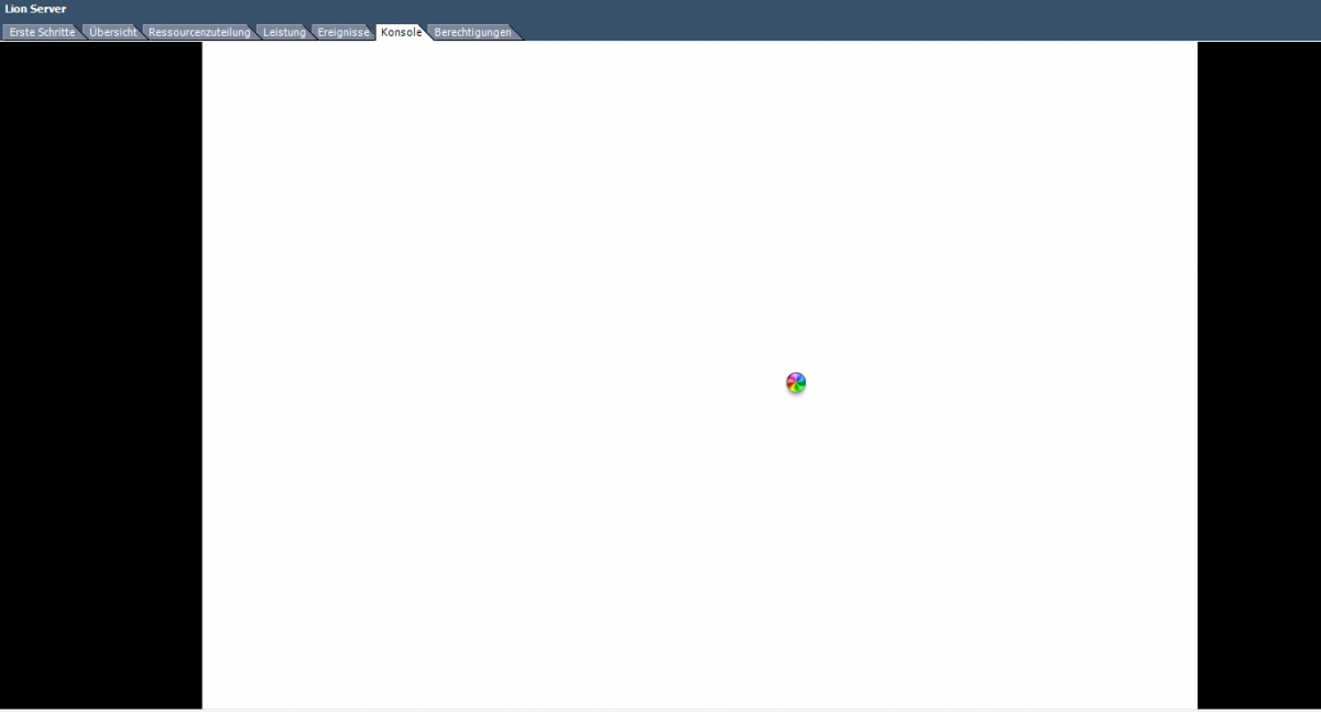

Hello
I like to install Mac OS X Lion (iso image) on my ESXi 5 Server (Version 623860).
No Matter what i Try, (Boot with verbose mode, or reconfig the vmx File) the power up stops at on same point.
I Power on the vm, After the gray Apple it shows me a white screen with the "spinning wheel of death".
Thats all, no CD Menu, no Error message
What can i do?

Hello
Thanks for fast Replay.
I found the issue.
First I start the uninstaller of the newest Patch and after this I installed it again. I rebooted the Host. After this the VM starts the Mac OS X Lion 10.7.0 CD (Image).
I see the Harddrive and installed the System without any errors.
I also started the Apple Software Update.
Now it works with newest Version of Lion (10.7.3) and Lion Server Tools installed.

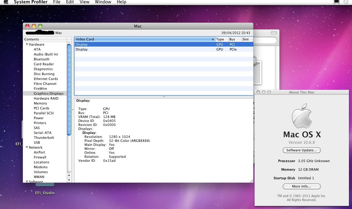

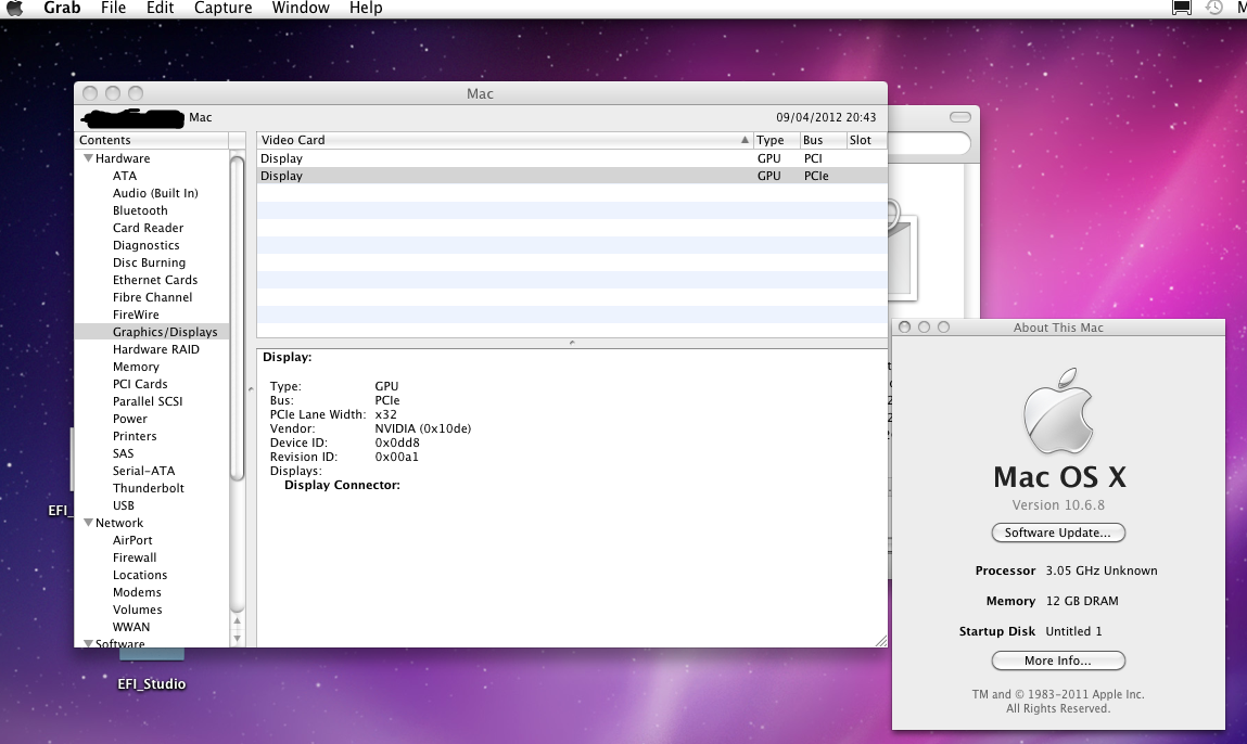

Hi all,
I was wondering if this has been tried before and how to solve this issue:
I am on ESXI 5.0.0, succesfully installed and upgraded OS X to 10.6.8. I have (I think successfully, see second screenshot below) done a PCI passthrough of my Nvidia Quadro 2000 to the OS, however I don't think this is being fully recognized as the system is still using the emulated ESXI video card (firstscreenshot) and i get no signal through the DVI in the card.
I have tried some of the methods (aquamac/gfxutil and EFIstudio, downloaded Tonymac's drivers for Nvidia) that actually work if I do a 'straight' OS X install on the machine - but do not seem to work on the vanilla install on ESXI.
Any ideas on how to force OS X to recognize and use my card?

Unless you are using a natively supported video cards, you are going to have a hard time getting this card working. The way it's done on Hackintoshes is using the boot loader to "inject" the card information but using ESXi you loose that ability. The only thing I can think of trying to install the latest NVIDIA drivers for QUADRO cards which worked for my GTX460 SE in a non-vitualized setting.
Hopefully you will get it working.
Good luck.

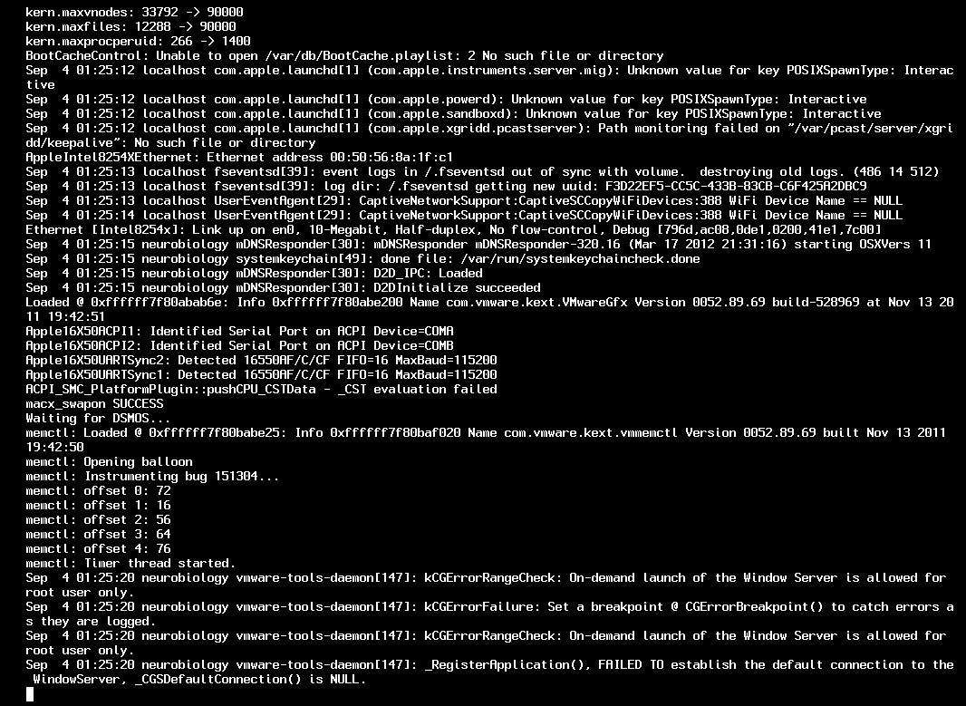

We would like to get, a version of Mac OS X running on our ESXi 5.0 host servers, we currently have many Mini Macs, but because of overhead of management, and the fact that they are very stealable, they are currently locked in the datacentre, and access is provided by VNC.
We would much rather, have virtual machine versions running on ESXi 5.0, and the fact we have real hardware, are "comfortable with the breach of license" at present.
We have Dell Poweredge 2950 and R710s, with the unlocked patch applied, but still fails to install. We have a Snow Leopard DMG, which we have converted to ISO, this works perfect, and boots/installs on VMware Workstation 8.0 (with the unlocker patch - thanks).
Apple Mac OS X 10.6 (64 bit) has been selected as the VM Template.
Processors in Physical Servers are Intel Xeon L5335 and X5560. Plenty of RAM, Plenty of hard disk storage.
But when booting the ISO, I get the grey screen, and spinning wheel, which I believe from googling is a non-starter!
If I select EFI Internal Shell (unsupported options)...
fs0:
\usr\standalone\i386\boot -v
I guess, the VM is booting from the cdrom, until....
ACPI_SMC_PlatformPlugin::pushCPU_CSRData - _CST evaluation failed
I'm not sure if the above is correct and preventing installation?
I've also tried
‘boot -v npci=0×2000′
Any ideas, would be very welcome, thanks (and great unlock!)

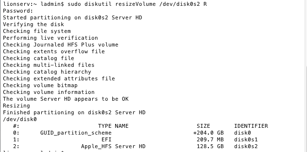

I have a Problem with Lion Server VM installed on VMware ESXi 5 (768111).
The LionServer works fin but I can not expand the Lion System Disc. In VMare I expand the Disc-File from 100G to 200GB. After I Restart the VM the Disc shows the new Free Disc-Space. But I can not expand the LionHD. I test it booted from System with Disc Utility and with Terminal and i also test it booted from Lion Boot CD. There is no error Message.
How can I expand the system Disc?
Can anybody test it on a Lion Server?

Another thing that I think is related is that the WindowServer process is not running. Launching it does nothing, whether I start the plist through launchd or launch it directly from the command line (except it turns the screen white and then quits).
