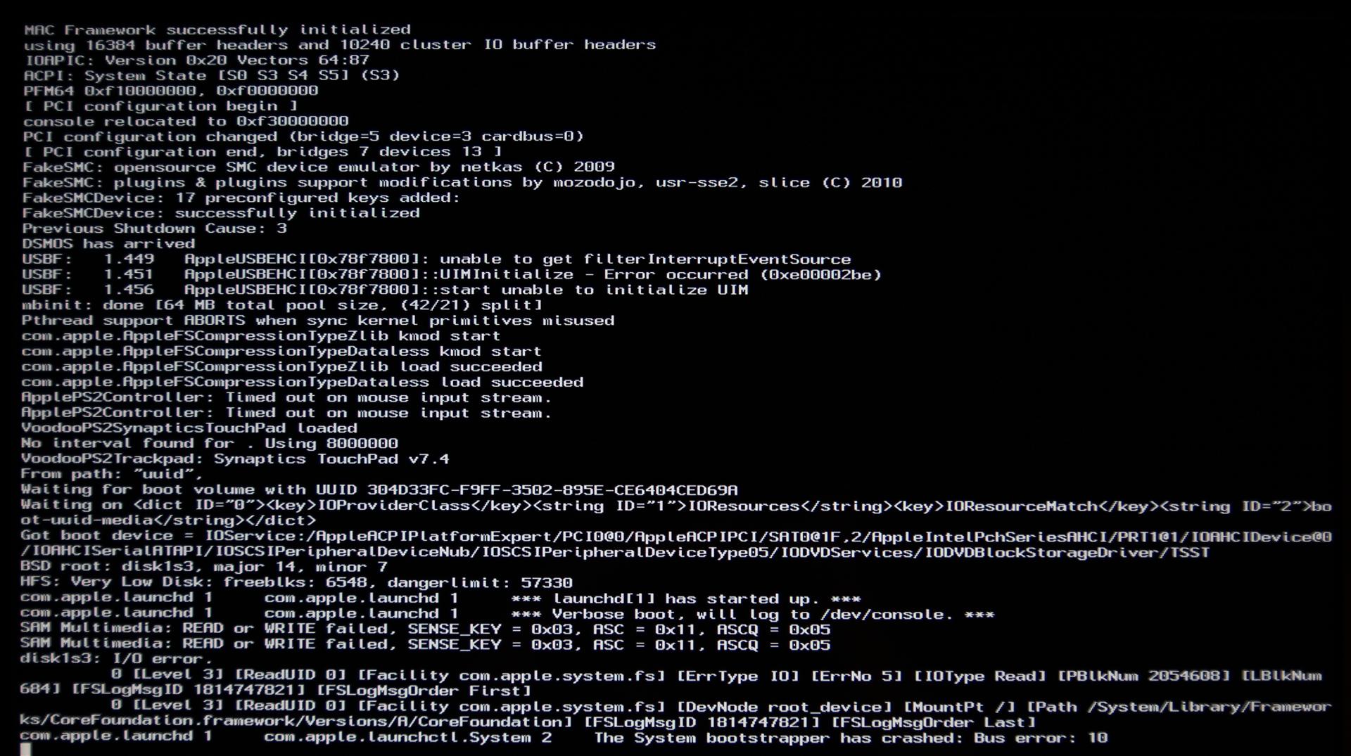

@bastisk8 A picture or a transcript of the Kernel Panic screen would be great, i need to know whats causing this. I'm planning on making a L502x Only boot CD so more info will be valued.

I hope the attached picture helps.
Also, when booting with my miniDisplayport>DVI adapter, the iAtkos DVD immediately freezes when pressing anything on the keyboard.
Don't use the mini display cable until you have Lion installed and working, as for the picture no KP there, only SAM Error which means you prolly burned the dvd at hight speed. Burn it again wtih 4x.

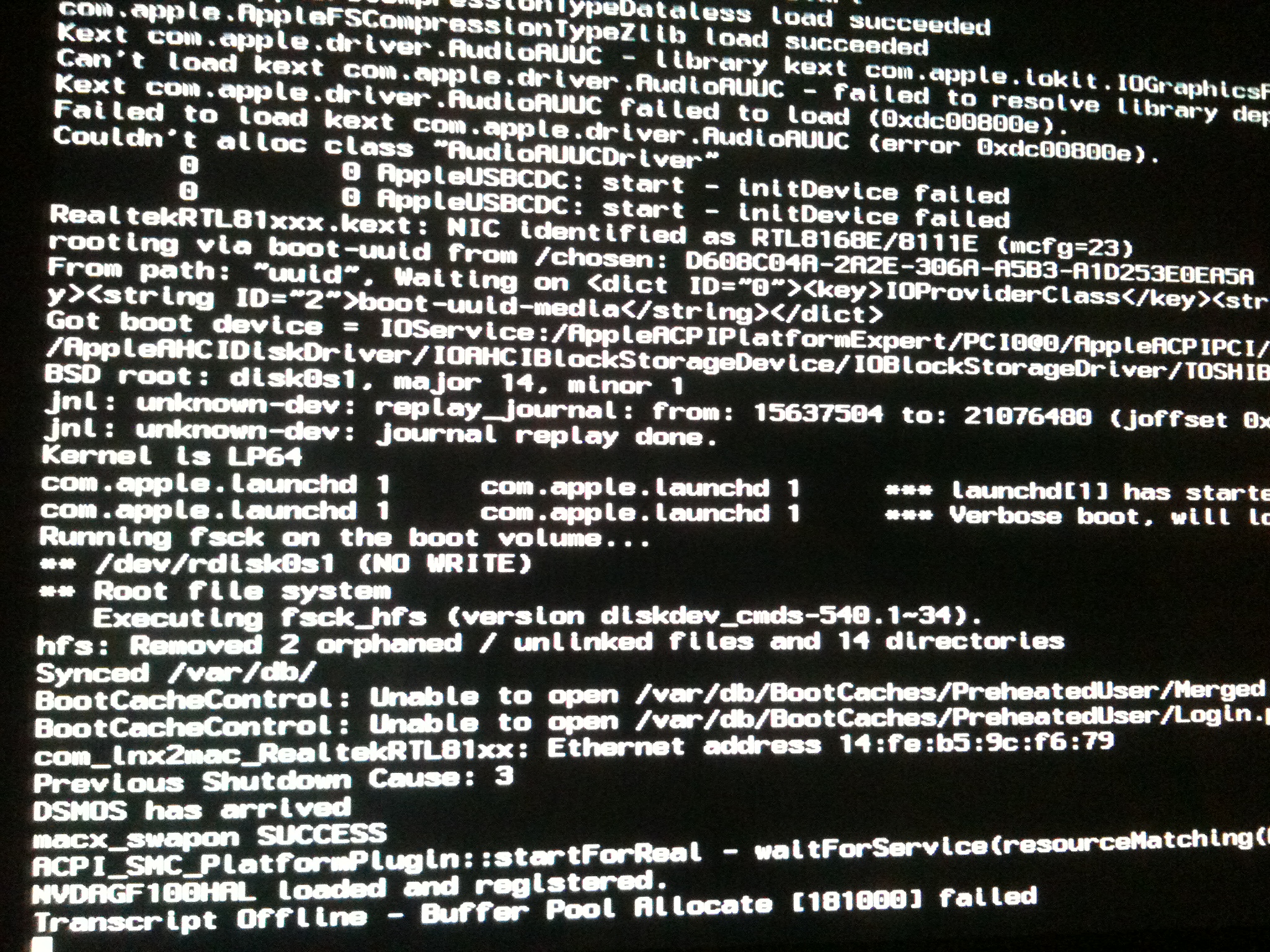

I can not enter in lion because command:-v GraphicsEnabler busratio = No = 20 does not enter. The last written on the screen is : Transcript Offline - Buffer Pool Allocate [181000] failed
this is the photo

The busratio for the 2820qm is 23 (from here: http://ark.intel.com/products/52227) so try "busratio=23"
Also, according to the OP you should do the installation with 4gb of ram first.
Try that.
Just tried installing Lion today on my L502x, here's the results.
Booted and installed from iAtkos L1. No problems other than 1024x768 resolution, but KB/M worked fine.
Booting from HD (-v GraphicsEnabler=No busratio=23) stalls after
ACPI_SMC_PlatformPlugin::startForReal - waitForService(resourceMatching(AppleIntelCPUPowerManagement) timed out
A line above says the DSMOS has arrived, if that helps.
When booting from rBoot LE, same flags, it prints out the same lines as above but continues to the first-run GUI. Once there, though, it can't detect the keyboard. Native resolution, 1366x768.
My XPS 15 stop whith the same line: "Transcript Offline - Buffer Pool Allocate [181000] failed"...

I faced this issue before, this problem relates to intel HD3000 graphics
my hd3000 dev id is 0116, what I did to fix this problem is by downloading and installing DSDT.aml from the first post at http://tonymacx86.com/viewtopic.php?f=15&t=28851
but to install this you have to boot into osx first, try booting with -x (it worked for me last time, and maybe with GraphicsEnabler=No busratio=20). after you've sucessfully booted, install the DSDT file (run [url="http://www.insanelymac.com/forum/topic/279450-why-insanelymac-does-not-support-tonymacx86/"]#####[/url], choose install userdsdt and macbookpro8,1 in customizations>system def.), after that try to boot normally (without -x)
hope that helps.
plug usb keyboard just for the first run, after that you dont need it anymore.
Thanks rndlgna, -x helped get to the first run screen from HD boot, I'll report back to you all when I get an external keyboard to use.
