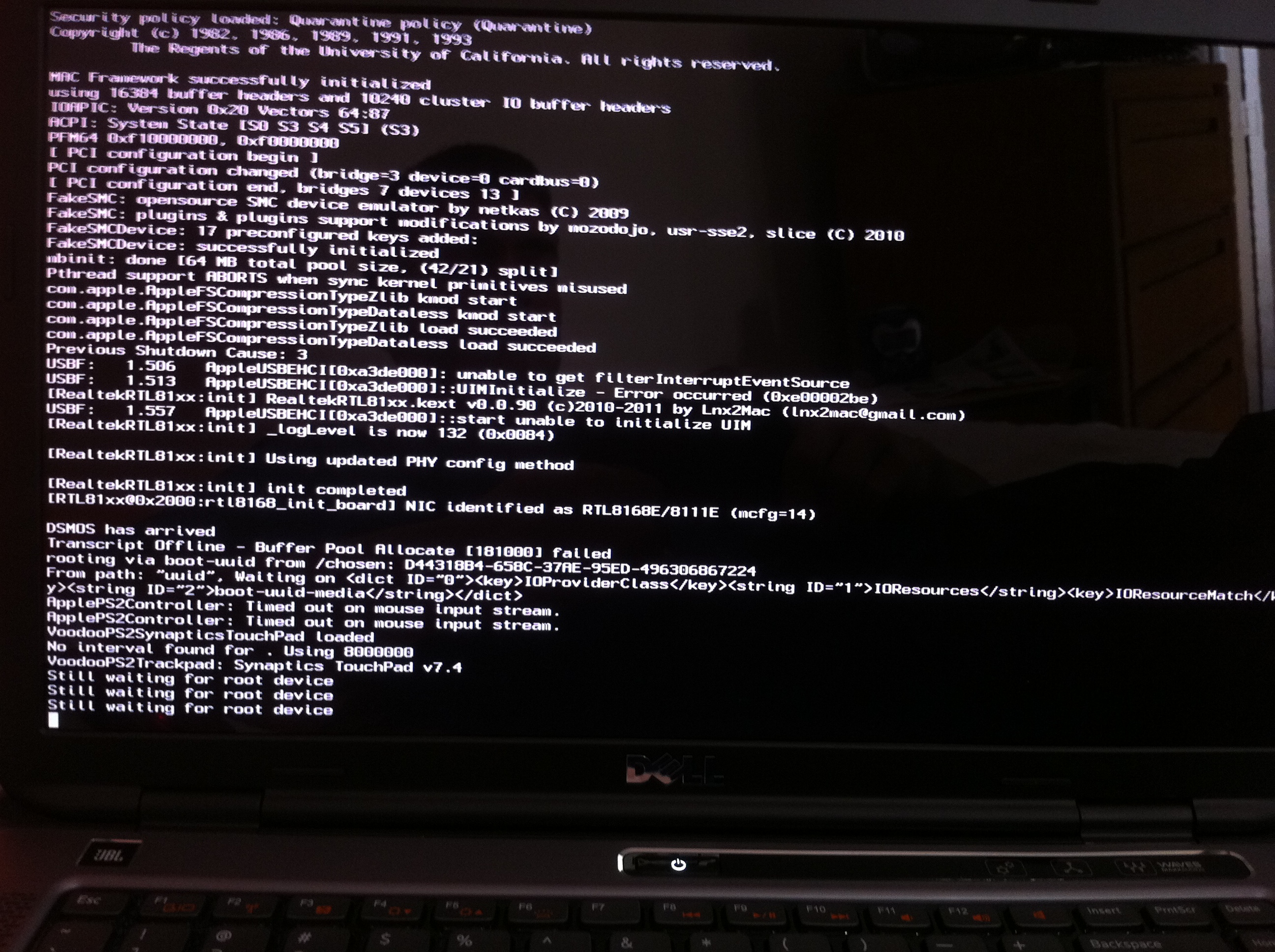

AKennedy_4 Posted October 22, 2011 Share Posted October 22, 2011 Hey DoiX, Thanks for your help. I burned iAtkos L1 to a usb drive and went to boot with it but if i try to boot straight into "USB Mass Storage" I get a missing operating system error (The drive is partitioned 3 times with MBR table). If I use the boot cd without any boot flags I get nothing but a blueish screen. If I add the flags "-v GraphicsEnabler=no cpus=1 busratio=20" I get this far (check image in attachments). I've also tried adding the other flag you mentioned (can't think of it off the top of my head) and that resulted in the same screen. Any ideas what I'm doing wrong? Thanks for the help Link to comment https://www.insanelymac.com/forum/topic/257950-guide-dell-xps-15-l502x-early-2011-snow-leopard-install-possibly-l702x-too/page/11/#findComment-1763486 Share on other sites More sharing options...

DoiX Posted October 22, 2011 Share Posted October 22, 2011 I swear i hate dell's bios. @futuregator15 Problem is, the iAtkos on USB stick doesn't know from where to boot so to say, you need to specify parameters if memory serves the extra parameter you need to add in order to boot using the boot cd is this one: rd=diskXsX (example rd=disk0s1) or UUID fix one... im no sure tho, check the help menu in the boot cd and read descriptions of individual flags for more info. I'm tired now so i'm going to sleep, good luck! i'll try to provide further assistance tomorrow if you don't succeed Link to comment https://www.insanelymac.com/forum/topic/257950-guide-dell-xps-15-l502x-early-2011-snow-leopard-install-possibly-l702x-too/page/11/#findComment-1763501 Share on other sites More sharing options...
AKennedy_4 Posted October 22, 2011 Share Posted October 22, 2011 I read up online and made sure my SATA options in the BIOS are set to AHCI. Also I tried to bootflag to point to the the portable usb drive im using to install OS X. In my case the flag I used was "rd=disk1s1 -v GraphicsEnabler=no cpus=1 busratio=20". I also tried to point it to the drive I'm trying to install OS X too, ex- rd=disk0s3. Neither flags worked. Thinking the problem lies with iAtkos since the Wen1's method never lead me to encounter this problem. If it amounts to anything I'm using A06 bois for l502x Link to comment https://www.insanelymac.com/forum/topic/257950-guide-dell-xps-15-l502x-early-2011-snow-leopard-install-possibly-l702x-too/page/11/#findComment-1763509 Share on other sites More sharing options...
