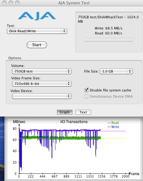

Does anyone have a Non-Cartri BIOS EP45-UD3P with a Seagate 750 or 1500 GB SATA drive that they could do a Disk Read/Write test on ? ( using AJA System Test v 3.1 with a 1.0GB file size and a video frame Size of 720x486 8bit )
AJASystemTest.zip
I am trying to determine where the issue is with my relatively slow motherboard SATA II speeds.
I am currently getting speeds in the same range as FW800, when I should be getting significantly faster speeds.
( See my previous posts in this topic )
Thank You!

I see that you have a raptor hd, what speeds are you getting on that drive?
RW
Great Question RemoteWorks!
And you may have solved the puzzle in part too!

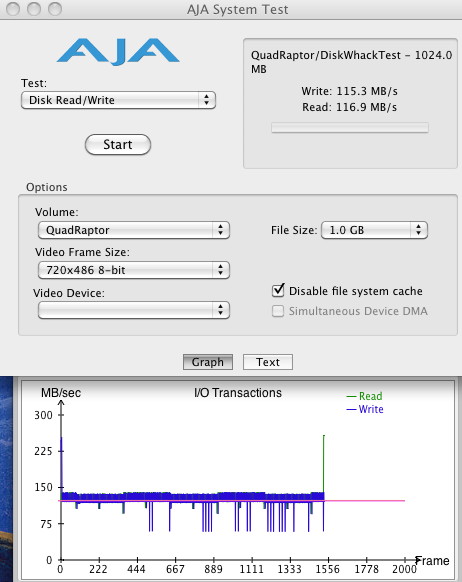

And, for more completeness...
FW800 test using Seagate SATA 750GB connected to StarTech FW 800 Card PEX1394B
300GB VelociRaptor connected to Motherboard SATA
THIS SATA result is more in line with what I would expect.. Therefore I suspect the issue is with the Seagate drives
vs the MB or Cartri's BIOS
Thanks for the question RW!
( and no, I have no jumpers on the seagates forcing them to SATA I )
Hmm, try testing the Seagate on the same sata port as the Raptor, but i think it's more likely related to the Seagate hard disk and not the Mb or Catri's bios.
Also confirm that Spotlight is not indexing while testing the drive.
