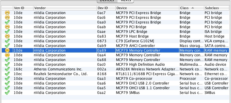

Regarding compatibility; What's the difference between smiley face and green check mark?
I ASSUME green check mark = tested and verified, and smiley face = SHOULD work but not sure?
I don't need a description for frownie :P Even though I got ONE.

I added the icons description in first post.
Icon meaning:
  • checkq.png - device was reported as working;
  • positive.png - device was not reported, but devices in this class are not usually reported;
  • negative.png - device was not reported, and devices in this class are usually reported.
I will talk to el coniglio about your suggestions. The first one is possible, I already asked him about it previously. The second one doesn't make much sense to me, but let's see.
