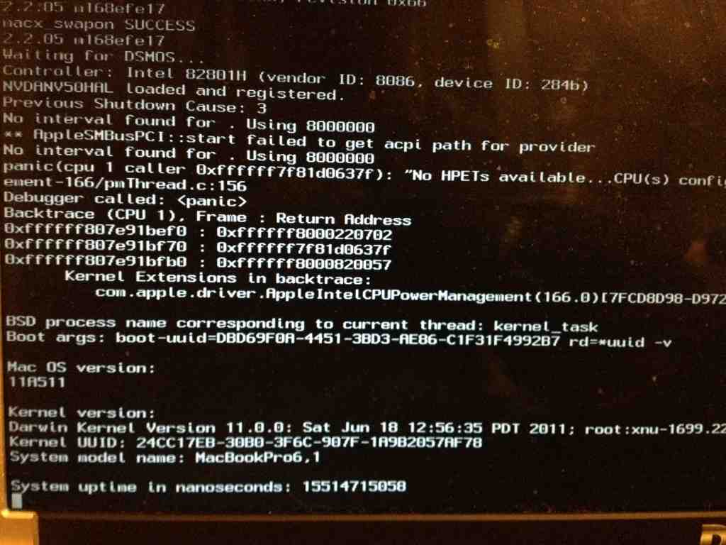

When I insert back the _PSW into the Latest DSDT any CPU for the XPS M1530 I now get a kernel panic. I am using DSDTSE v1.4.3 to compile. Do I need to use a newer version of the DSDTSE compiler? Is there a way to swap out the IASL compiler in DSDTSE with the latest one unless the newer versions have the iasl compiler issue?
I am doing more tests. Never did the RTC patch for CMOS reset. I think something is screwy with either the RTC script in the DSDT or something else. WIll look into this.
Screenshot of panic:
Edited:
Well the lastest dsdt seems to be a bit flawed. I and to remove the IRQ {15} from the hpet section. Kernel Panic taken care of. Still working on sleep/wake with darkwake=0.
Edited once more:

ahh i used 0,8,11 not 15
RTC i had it set to length 0x08 instead of 0x06 and second 0x02 i removed. (like a real macbook) or leave stock.. but do patch AppleRTC.kext for sleep issue.
your SMBUS is missing also. u can grab the one in my dsdt or on first page shows how to fix.
