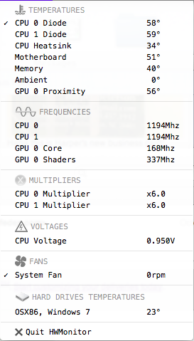

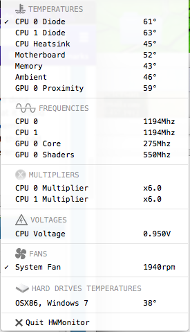

lulighttec Posted October 18, 2013 Share Posted October 18, 2013 Have you cleaned the fan and reapplied the thermal paste recently? I have done this fairly recently (~4 months ago?) and my temperatures are very much like DarwinX' with the DSDT he posted for 10.8.5, maybe a little bit lower when not under load (CPU 44, GPU 60, Ambient 17; CPU 58, GPU 68 while watching a video on youtube). I opened it up not too long ago, and there was nothing to clean, which surprised me. I expected it to be full of cat hair. Like, seriously, no dust anywhere. Shocking. Not sure where I would put thermal paste if I was going to. Everything seems pretty solid, so I'm not sure I want to disturb it. Link to comment https://www.insanelymac.com/forum/topic/190780-guide-making-a-dsdtaml-for-dell-xps-m1330-xps-m1530-and-xps-m1730/page/57/#findComment-1955823 Share on other sites More sharing options...
DarwinX Posted October 18, 2013 Share Posted October 18, 2013 I opened it up not too long ago, and there was nothing to clean, which surprised me. I expected it to be full of cat hair. Like, seriously, no dust anywhere. Shocking. Not sure where I would put thermal paste if I was going to. Everything seems pretty solid, so I'm not sure I want to disturb it. This has been a problem for me ever since 10.8.5 also, except MUCH higher than yours. It seems like my processor cores switch to the highest frequency too often, and they get hot fast, anywhere from 70-95C, in particular when I'm playing a video of any kind. Right now they seem pretty cool, and the fan isn't running too hard, but it worries me... right now, CPU is at 74, and GPU is at 70. Ambient is 18. This is not under load (or much of one). If I put it under load, it will shoot up. Simply opening your laptop case enclosure is not sufficient. The entire GPU fan assembly must be removed and disassembled in order to even see the multiple layers of dust and filth that have build up on the inside of the fan casing. If you have never cleaned it, the fan assembly is guaranteed to be too congested and clogged up by dirt to properly cool and aerate your GPU causing your CPU/GPU temperatures to skyrocket which would inevitably cause your laptop to fail due to overheating, especially considering that our GPU chips are already inherently faulty and prone to overheating. The thermal paste is applied directly on to the GPU's heat sink which is accessible upon the removal of the GPU's fan assembly. Also, use the modified DSDT.aml which I posted a few days ago, it should bring your temperatures way down from your existing levels which are dangerously high! Here it is yet again: XPS M1530 DSDT - 10.2013.zip See, this is a problem I'm having now, under 10.8.5, since I followed your instructions for a clean install. Sleep mode for me causes either a black screen upon wake, which I can only resolve by hard rebooting, or a reboot with a CMOS reset. Before 10.8.5 the CMOS reset wasn't a problem, but the broken sleep was. I have the same problems with the darkwake=0 fix that you do, and the same problems with trying to force chameleon to use the wake image (i.e. it just doesn't work, says the wake image is corrupted). As far as the CMOS chip reset upon Sleep mode invocation under the 10.8.5, here is the patched 10.8.5's AppleRTC.kext 1.5 which successfully remedies said issue: AppleRTC.kext-v1.5.zip Warning: This particular AppleRTC.kext is version 1.5 which is only applicable to the 10.8.5 and below. If you require a CMOS patched AppleRTC.kext version 2.0 for the 10.9, here it is yet again: AppleRTC.kext-v2.0.zip I haven't put my laptop to sleep since the 10.8.5 update, but I am having the same problem. Black screen when waking up with no option but to do a hard reboot. I have never had any Sleep mode issues under the 10.8.5, such issues only occur under the 10.9. Link to comment https://www.insanelymac.com/forum/topic/190780-guide-making-a-dsdtaml-for-dell-xps-m1330-xps-m1530-and-xps-m1730/page/57/#findComment-1955833 Share on other sites More sharing options...

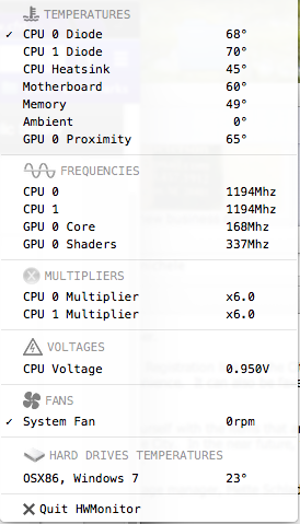

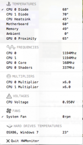

DarwinX Posted October 19, 2013 Share Posted October 19, 2013 I followed these instructions (lo and behold, there was dust in the fan assembly after all), and I am still having the same problems as I was before, i.e., sleep not working properly, CMOS reset if I try to sleep, and temperatures are a little lower, but they still hang around 65-72C. I did notice the fan doesn't run constantly anymore (sometimes it just stops), and that the ambient temperature dropped to 0C. You should have NO Sleep mode issues under the 10.8.5. As far as the CMOS reset, the appropriately patched AppleRTC.kext v.1.5 for the 10.8.5 posted above completely remedies that issue. The Ambient temperature should never be at zero C. Also, before checking temperatures again, turn your laptop off for a few hours and allow it cool down completely. DarwinX .. try Device (RTC) original with no fixed 0x02 .. i remember i had reboot on second sleep also with 10.6.x when i was modding the RTC testing. but i think its an acpi issue of the video. also i had issues with inspiron 1520 intel vid version an shutdown.. had to remove _PRT or was it _PRW from HDEF aka AZAL then it would shutdown fine without _PTS trick. I remember having issues with the RTC in our DSDT.aml which required some slight modification. I too was considering the ACPI as the culprit due to the fact the AppleACPIPlatform.kext that we use under the 10.9 is not regressed for a change. Perhaps, the usual AppleACPIPlatform regression might narrow it down. Either way, my understanding of the ACPI programming is at a near zero and the DSDT.aml modification and patching is better left to coders and experts, of which I am neither. Link to comment https://www.insanelymac.com/forum/topic/190780-guide-making-a-dsdtaml-for-dell-xps-m1330-xps-m1530-and-xps-m1730/page/57/#findComment-1956063 Share on other sites More sharing options...
lulighttec Posted October 20, 2013 Share Posted October 20, 2013 As far as the CMOS reset, the appropriately patched AppleRTC.kext v.1.5 for the 10.8.5 posted above completely remedies that issue. I don't know what to tell you. The RTC kext is not remedying the issue. It just isn't. I dragged it onto the kext utility to install it; it's not like I haven't installed a kext before. It makes no difference. You should have NO Sleep mode issues under the 10.8.5. Also, I have sleep issues. I have ever since 10.8.x. They are exactly what you are describing with 10.9. I don't know how else to put it. The Ambient temperature should never be at zero C. Also, before checking temperatures again, turn your laptop off for a few hours and allow it cool down completely. For the record, it took me a while to clean the fan assembly, mostly because I was having trouble unscrewing the cover of the fan assembly itself, but the point being, my laptop was off for quite a while, maybe an hour. For the benefit of the doubt, I shut it off for the night and didn't turn it on again until the next morning, when I gave you those readings. Just to be super sure, it has been off now for 12+ hours, and I just turned it back on. The first screenshot is right after booting up, and the second is maybe 5 minutes later. My laptop has been running for almost an hour, and now shows Ambient temperature of 45C, and the fan is running. Believe me, I'm not trying to be difficult. I'm just telling you what is happening. I have regarded what you say with much reverence, and have done everything that you have suggested, even to go so far as to start out with a brand new HDD and format it as GPT and installed OSX first, so that it would take precedence over anything else, and instead of restoring my backup, I reinstalled all my software clean, and that did solve quite a few problems I was having, but not all of them, obviously. Something else is happening, and I'm not sure how to identify where it is happening. One thought that had occurred to me is that we have slightly different processors, don't we? Perhaps it is that slight difference in the DSDT.aml that makes the difference. I know according to you, it shouldn't make a difference, but... I have seen stranger things happen while working with computers. Link to comment https://www.insanelymac.com/forum/topic/190780-guide-making-a-dsdtaml-for-dell-xps-m1330-xps-m1530-and-xps-m1730/page/57/#findComment-1956270 Share on other sites More sharing options...
DarwinX Posted October 21, 2013 Share Posted October 21, 2013 Lulighttec, our CPU's are indeed different. It seems like you might have some CPU intensive background processes that trigger the jump in temperatures on your machine. According to the iStat Menus.app, my CPU load average is under 10%. Whenever it exceeds 30% - 40% for any length of time, then my temperatures too skyrocket. So, i keep a close eye on my CPU load, I recommend that you do the same. Link to comment https://www.insanelymac.com/forum/topic/190780-guide-making-a-dsdtaml-for-dell-xps-m1330-xps-m1530-and-xps-m1730/page/57/#findComment-1956478 Share on other sites More sharing options...
indiandragon Posted October 21, 2013 Share Posted October 21, 2013 @LatinMcG : Hope you get well soon. @DarwinX : Temperature : I cleaned up my laptop ~6 months and applied Deep Cool Z5 for both CPU and GPU . But I'm sure the effect of the coolant for CPU has been undone as I ran a application for days at high temperature. But GPU stays 62-64 deg C. So coming to the point of discussion, I'm still not sure whether OSX 10.8.5 has anything to do with the system temperature as my CPU is stayed between 57 -67 deg C since the clean up at 6-7 running applications. But when I run Eclipse or Netbeans for Android programming, the CPU even reach's 81 deg C at some point (But I'm sure that's java to blame ) then again it could be OSX issue too. Bit confused Info : Guys check out the app Temperature Gauge we can set up notifications for temperature monitoring. Helpful to monitor. Sleep : No sleep issues in 10.8.5 for me. Occasional fail wakeup has been there for ever to me . Maverick Release : So any of you guys who had tried 10.9 will be buying maverick tomorrow i.e if it get's released ? I plan to buy one though I didn't have time to try one GM yet Link to comment https://www.insanelymac.com/forum/topic/190780-guide-making-a-dsdtaml-for-dell-xps-m1330-xps-m1530-and-xps-m1730/page/57/#findComment-1956480 Share on other sites More sharing options...

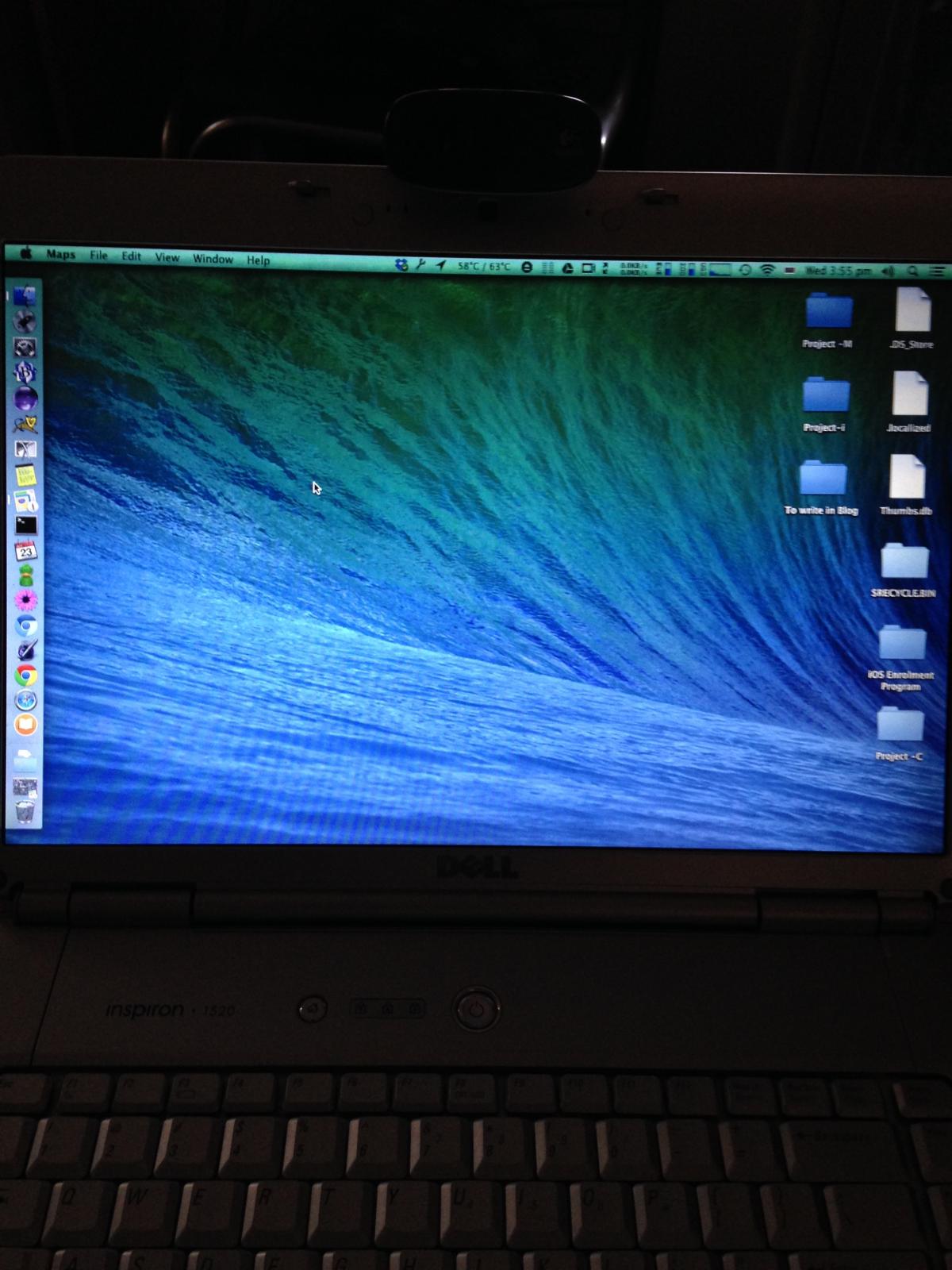

indiandragon Posted October 23, 2013 Share Posted October 23, 2013 Epic Maverick 10.9 Install Has been the easiest install till date, that too on the MBR ! For the previous two iterations the installation would end at failure due to MBR. But this one took 45 Minutes to install without any errors. Use the same USB Install method as in Mountain Lion. No need of ACPI Platform kexts roll-back as Darwin X said. The kexts to be replaced was AppleACPIPS2Nub.kext, ApplePS2Controller.kext, AppleHDA and ACPIBatteryManager.kext (refer in package shared by DarwinX). AppleGraphicsPowerManagement has to be patched, please refer my earlier threads on how to . Apps : Little snitch 2.X wasn't compatible so I had to buy the 3.X . Avast and other unsupported apps were moved to unsupported apps folder during first boot. Sleep : No change in sleep/wake behaviour (rare failed wake has been there in my hackbook for ever ). Temperature : Seems pretty normal to me . When mdworker, kext cache or other CPU consuming process is running the temperature shoots high. Has been like that for me for a long time , not after 10.8.5 Still, DarwinX : What has changed in the DSDT which you said would address temperature ? You should also take a look at my DSDT cause the temperature and sleep looks normal at my end. There's a minor possibility I've added some fix but I didn't make any changes to the DSDT since Lion. I'll upload my DSDT in a while. And now , This baby has seen 5 Generations of retail OSX today . I'm gonna Pumkin create a memorial site when this baby dies 1 Link to comment https://www.insanelymac.com/forum/topic/190780-guide-making-a-dsdtaml-for-dell-xps-m1330-xps-m1530-and-xps-m1730/page/57/#findComment-1957070 Share on other sites More sharing options...

chris1111 Posted October 24, 2013 Share Posted October 24, 2013 Epic Maverick 10.9 Install IMG_0016.JPG Has been the easiest install till date, that too on the MBR ! For the previous two iterations the installation would end at failure due to MBR. But this one took 45 Minutes to install without any errors. Use the same USB Install method as in Mountain Lion. No need of ACPI Platform kexts roll-back as Darwin X said. The kexts to be replaced was AppleACPIPS2Nub.kext, ApplePS2Controller.kext, AppleHDA and ACPIBatteryManager.kext (refer in package shared by DarwinX). AppleGraphicsPowerManagement has to be patched, please refer my earlier threads on how to . Apps : Little snitch 2.X wasn't compatible so I had to buy the 3.X . Avast and other unsupported apps were moved to unsupported apps folder during first boot. Sleep : No change in sleep/wake behaviour (rare failed wake has been there in my hackbook for ever ). Temperature : Seems pretty normal to me . When mdworker, kext cache or other CPU consuming process is running the temperature shoots high. Has been like that for me for a long time , not after 10.8.5 Still, DarwinX : What has changed in the DSDT which you said would address temperature ? You should also take a look at my DSDT cause the temperature and sleep looks normal at my end. There's a minor possibility I've added some fix but I didn't make any changes to the DSDT since Lion. I'll upload my DSDT in a while. And now , This baby has seen 5 Generations of retail OSX today . I'm gonna Pumkin create a memorial site when this baby dies 919607_10151668759815439_1105525726_o.jpg 5 GEN OS X thats pretty cool Link to comment https://www.insanelymac.com/forum/topic/190780-guide-making-a-dsdtaml-for-dell-xps-m1330-xps-m1530-and-xps-m1730/page/57/#findComment-1957423 Share on other sites More sharing options...
