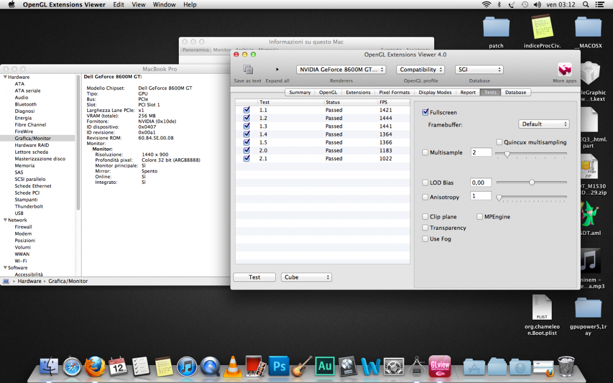

raimdal Posted October 12, 2012 Share Posted October 12, 2012 first test I've used the patch (and so I used mbp 7,1 smbios plist generated with chameleon wizard+darwinx selection) agpm error is gone , PCIe lane Width x1 again but my GL test is like Indian dragon before the upgrade and so better then is 10.8.1 and similar to his 10.8.0 test non patched Link to comment https://www.insanelymac.com/forum/topic/190780-guide-making-a-dsdtaml-for-dell-xps-m1330-xps-m1530-and-xps-m1730/page/50/#findComment-1859938 Share on other sites More sharing options...

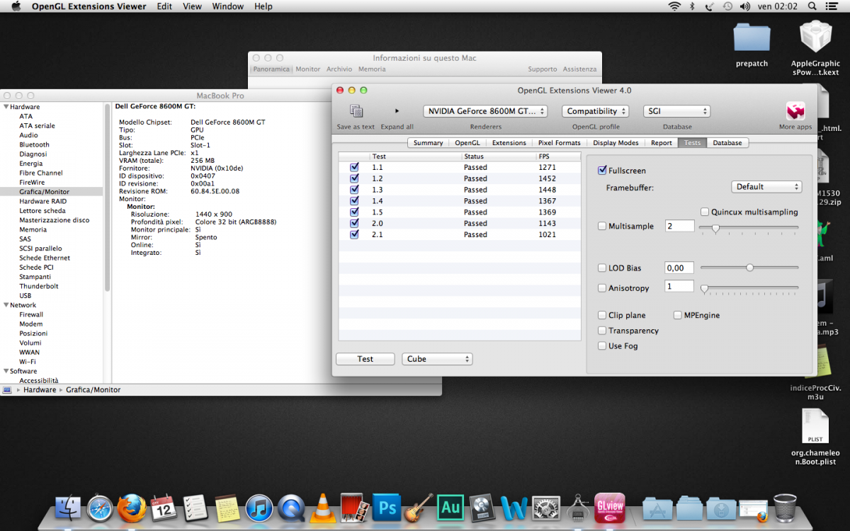

raimdal Posted October 12, 2012 Share Posted October 12, 2012 second test removing gpupowermanagement and with mbp5,1 the benchmark is better but temperature are just a little hotter, PCIe lane Width x1 Link to comment https://www.insanelymac.com/forum/topic/190780-guide-making-a-dsdtaml-for-dell-xps-m1330-xps-m1530-and-xps-m1730/page/50/#findComment-1859941 Share on other sites More sharing options...
raimdal Posted October 12, 2012 Share Posted October 12, 2012 3th test using agpm patch, mbp7,1 and applesmc 3.1.1 (lion10.7.3) error is gone and pcie lane is x8.....I know it had to be x16 but i don't have this value and in the other test it was x1.... so darwin what version do you have about applesmc 3.1.1 or previous? 4th test I've also patched geforce kext and nvdaresman kext with correct id.... pcie lane is again x8....I don't think my gpu is broken because benchmarks are good and pcie lane number change changing the configuration but I don't find the error ...where is my error? I've used the same configuration of darwinx and we have the same gpu...and the result for me it's not good like your...the situation is better with the last test but not so much how it could be....but I don't understand why.... I've also tryed like I've read in official mac forum...they shuted down macbook pro, removed battery and charger for 15 seconds and "for them" this problem (that they also have with gt8600) was solved...not for me...when it was 1x it returned sometimes to 8x....hargggggg could be a problem on pci bridge? what the hell I have to configure again? well because of I've added the correct device id to many kexts I hope this help someone...the difference for me is that now I see values going up and down in CUDA-Z performance tab...my lane don't go anymore down to x8 but mine gpu can have some problem (at this point) because now the device is identified more than in a basic installation.... I hope someone can find the missing link about this x8 and about "nvclockx error reading bios" also if I've patched also fakesmc kext...after showing this error nvclockx is loaded and show me gpu temperature idforinfoplist.zip Link to comment https://www.insanelymac.com/forum/topic/190780-guide-making-a-dsdtaml-for-dell-xps-m1330-xps-m1530-and-xps-m1730/page/50/#findComment-1859945 Share on other sites More sharing options...
