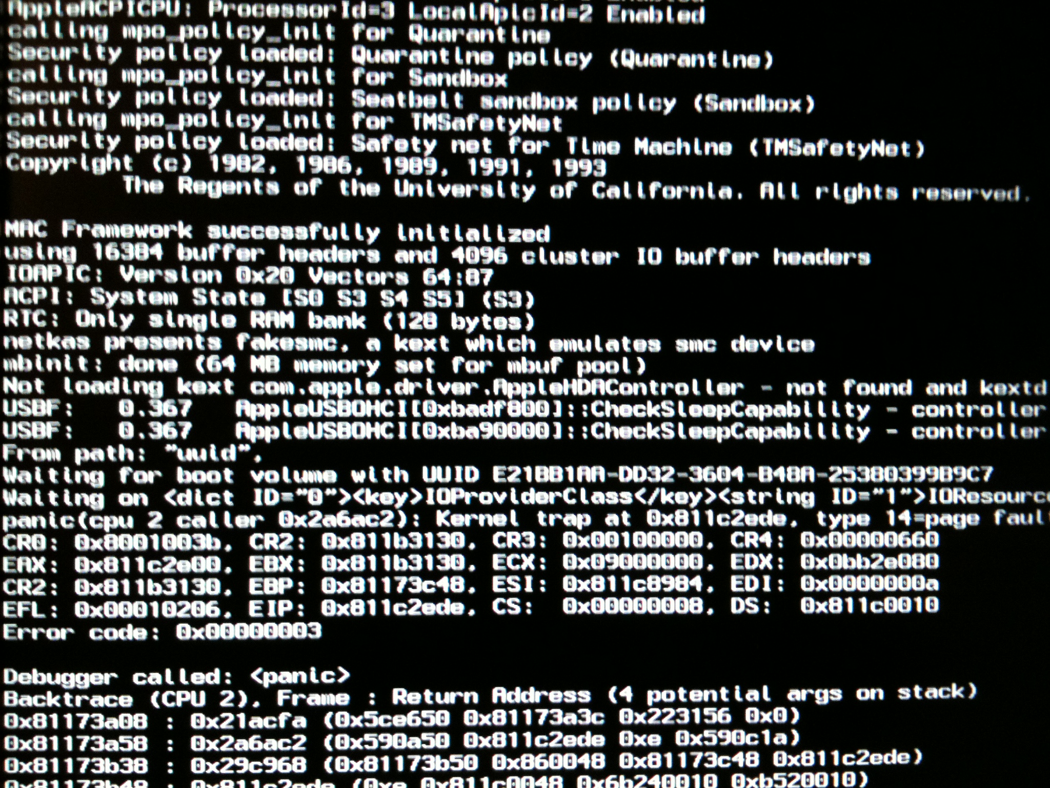

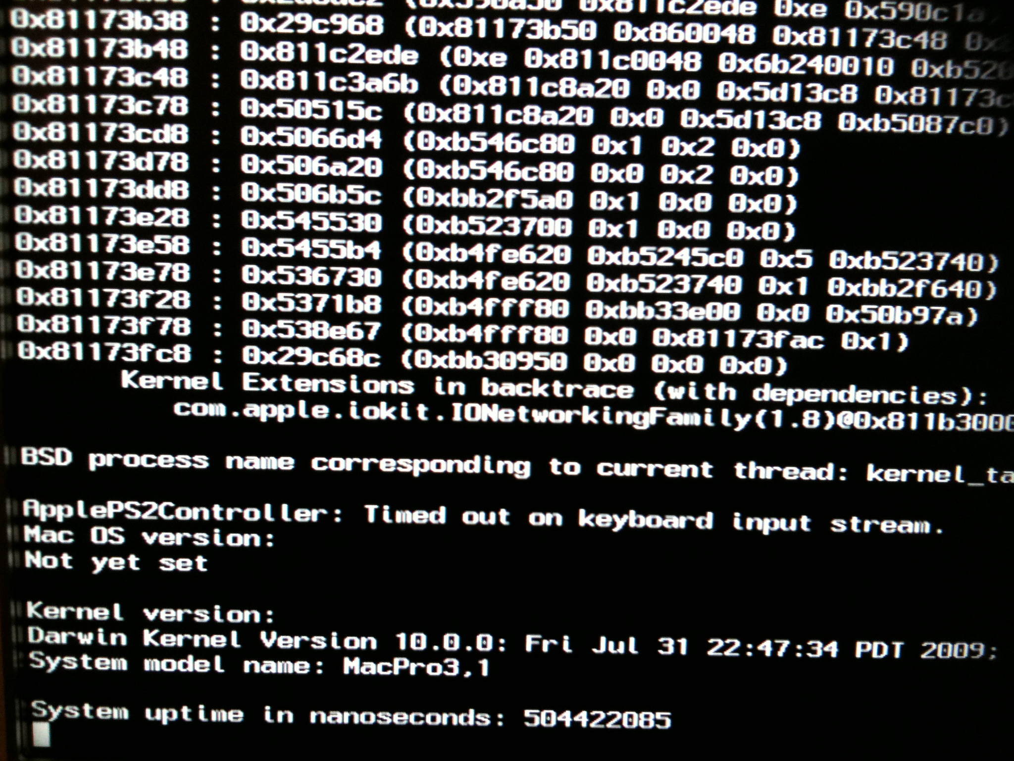

I have edited my SMBios.plist changing the SMProductname but I'm still having poping noises. I upload a screenshot of my System Profiler, I'm using Chameleon v1012 and the System Profiler doesn't show a MacPro Identifier but with "Chameleon 2.0 r431+Netkas PC EFI 10 1 boot" it shows it.
I have problems booting in 64bit(-x64 flag), I think system doesn't charge the kexts in Extra/Extensions and I have a KP shownig down:
Attached File  4_Chamaleon_2_RC1_without__x32_flag.jpg   994KB   116 downloads
When I boot in 32bit:
- No KP with Chameleon v1012.
Attached File  1_Chameleon_v1012.jpg   697.36KB   88 downloads
- Random KP with Chameleon 2 RC1.
Attached File  2_Chameleon_2_RC1__x32_flag.jpg   584.66KB   74 downloads
Attached File  3_Chameleon_2_RC1__x32_flag_Activity_Monitor.jpg   679.3KB   59 downloads
What can I do? I don't know what's the problem?
Could you write all the steps and upload the necessary files?
Thanks you very much.
Hardware: GA-965p-S3 rev 1.0 firmware F12, 2.13GHz E6300, 4GB RAM, 8600GTS

Hi Cartier82,
Screenshot 1 : I noticed that your fakesmc by netkas is not loading. You're going to have to try and resolve that. I've attached the copy I'm using.
Screenshot 2 : The Identifier (SMproductname) should be MacPro3,1.
Screenshot 3 : I see you corrected this and it now properly reads MacPro3,1. Another difference I did was to set the BOOT Rom Version also. Set it to MP31.00C1.080209154. (See attached screenshot). Lastly I entered in my Snow Leopard UUID (Disk Utility -> Get Info on Snow Leopard partition), you'll see I've entered all 3 adjustments in the smbios.plist which is attached. I've also attached the fakesmc.kext I'm using also (Thanks Netkas).

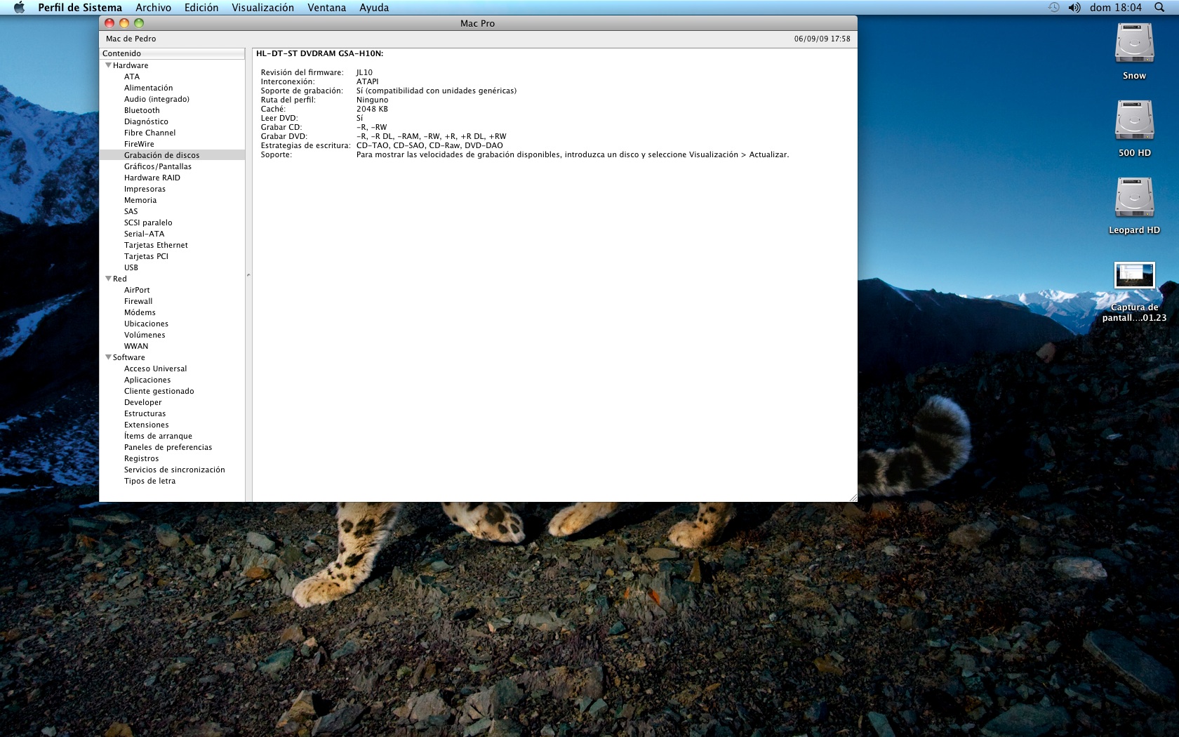

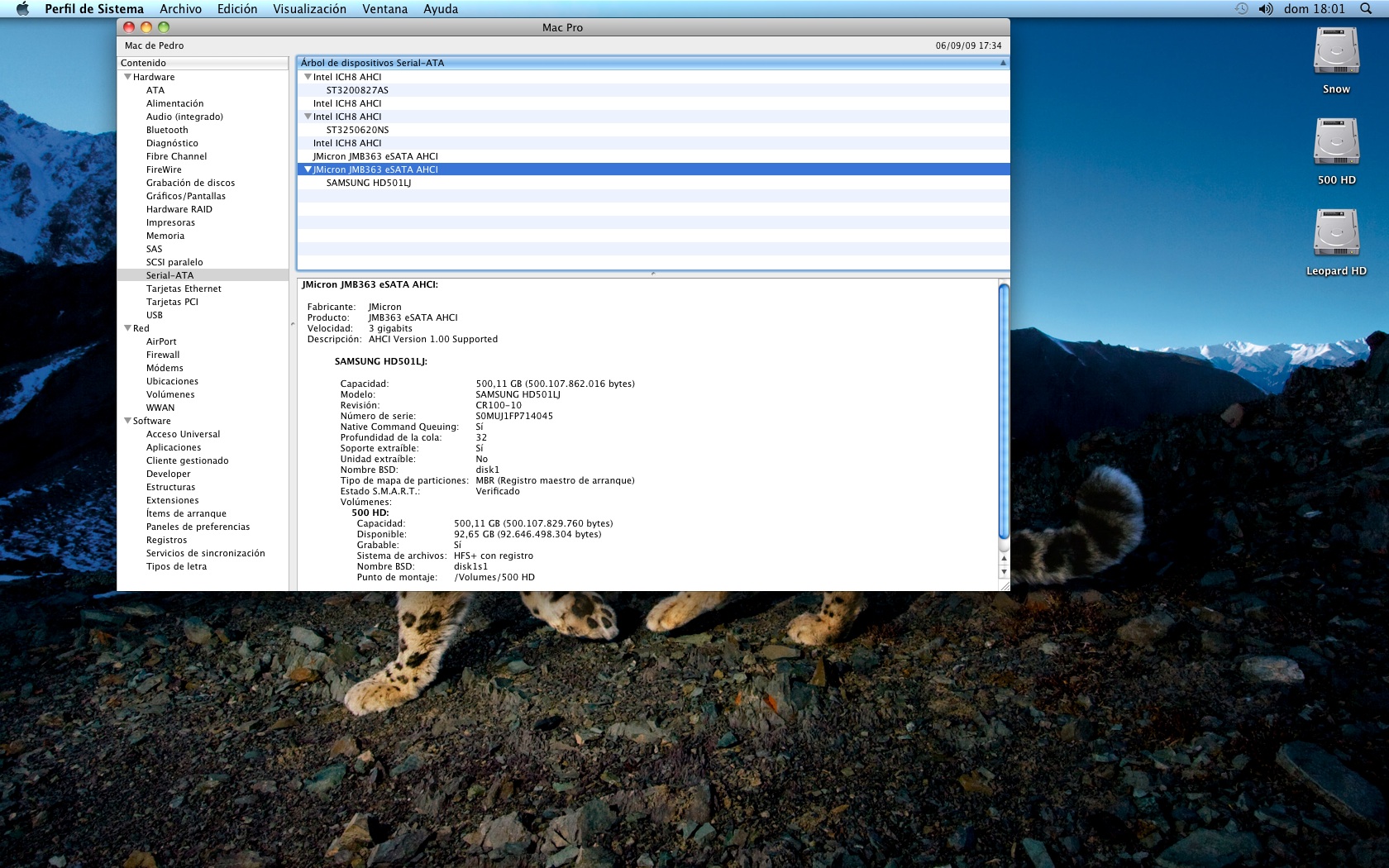

Hi Slither,
I'm testing the JmicronATA.kext, no KP at the moment.
Attached File  Captura_de_pantalla_2009_09_06_a_las_18.01.23.jpg   565.45KB   34 downloads
Attached File  Captura_de_pantalla_2009_09_06_a_las_18.04.26.jpg   498.69KB   15 downloads
Could you explain how patch the DSDT.aml (for USB and Audio)?
Thanks

Hi Slither,
Thanks

Hi Slither,
Everything working perfect now. Except i couldn't boot using -x32. It defaults to x64 using chameleon 2 RC1. I tried booting -x32 but got kernel panic. Is it becasue i installed snow using usb instead of DVD? I'm default to 64 bits now...
Thank you.
Can you send a screenshot of your kp please.
