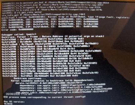

mprewitt Posted May 8, 2008 Share Posted May 8, 2008 Ok, I tricked my HP into getting the Enet port 2 installed, cost me 2 freezes, but it is now installed, so I am no longer getting the 'go apply' in the logs. BUT now it KP's on boot regardless. I can't catch any of the information in the logs. It won't write and it goes through a huge backtrace thing on the screen so the information is useless. And it goes by too fast for me, so I am at a loss as to how to help on this now... Mark Oh, running 3945 1034 Link to comment Share on other sites More sharing options...

mprewitt Posted May 8, 2008 Share Posted May 8, 2008 Ok, built & tested 1036, attached is a pic of latest KP. Hope this helps. Link to comment Share on other sites More sharing options...

jalavoui Posted May 8, 2008 Author Share Posted May 8, 2008 Ok, built & tested 1036, attached is a pic of latest KP. Hope this helps. yep i need someone to add IOLog("1\n"); IOLog("2\n"); etc to the functions of previous kp to find out where the driver get the kp nordix, if you allways get kp there's no point in posting log because it as no data related with the kp add iologs to ieee80211_tx_h_rate_ctrl() and rs_get_rate() this will show the place of the kp wait... i'll try this code in ieee80211_tx_h_rate_ctrl() if (unlikely(!tx->sta) return TXRX_CONTINUE; if this if 1st packect bug it will fix it i'll upload to svn try it iwi3945 rel 1037 iwi4965 rel 1038 Link to comment Share on other sites More sharing options...

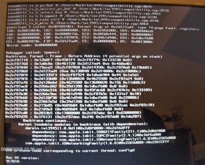

mprewitt Posted May 8, 2008 Share Posted May 8, 2008 ok, here is the latest KP. Mark 3945 1041 Link to comment Share on other sites More sharing options...

jalavoui Posted May 8, 2008 Author Share Posted May 8, 2008 fix for last kp - maybe iwi3945 rel 1042 iwi4965 rel 1043 Link to comment Share on other sites More sharing options...
mprewitt Posted May 8, 2008 Share Posted May 8, 2008 Ok, 3945 1043 KP is alittle different. sorry the picture sucks.. Link to comment Share on other sites More sharing options...

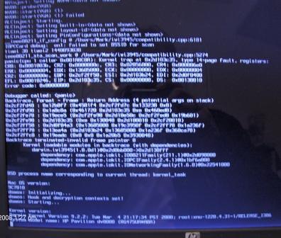

jalavoui Posted May 9, 2008 Author Share Posted May 9, 2008 tx packet code iwi3945 rel 1044 iwi4965 rel 1045 Link to comment Share on other sites More sharing options...
Marcy Darcy Posted May 9, 2008 Share Posted May 9, 2008 I just tried out 1044 >> result KP attached Screenshot and syslog greez Marcy system.log.zip Link to comment Share on other sites More sharing options...
jalavoui Posted May 9, 2008 Author Share Posted May 9, 2008 I just tried out 1044 >> result KP that was because of errors at startup try a few reboots the driver can't work if May 9 11:55:26 localhost kernel[0]: warning iwl3945: Radio disabled by HW RF Kill switch you need to turn the card on before testing - press the wireless switch Link to comment Share on other sites More sharing options...

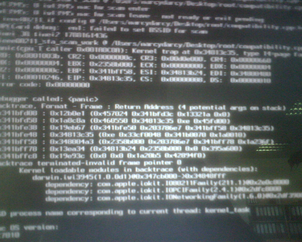

pere Posted May 9, 2008 Share Posted May 9, 2008 iwi 3945 r1044 Took a lot of reboots to get rid of timeouts, but finally booted ok, log attached. When tried to use manual scan, got frozen after that, reboot got an SCAN COMPLETE NOTIFICATION and kp here: IOPCcard debug: : failed to restore operational channel after scan _IEEE80211_if_config @ /users/pere/iwi3945/compatibility.cpp: 6182 related to this: { IM_HERE_NOW(); struct ieee80211_sub_if_data *sdata = (struct ieee80211_sub_if_data*)IEEE80211_DEV_TO_SUB_IF(dev); struct ieee80211_local *local = wdev_priv(dev->ieee80211_ptr); struct ieee80211_if_conf conf; static u8 scan_bssid[] = { 0xff, 0xff, 0xff, 0xff, 0xff, 0xff }; if (!local->ops->config_interface || !netif_running(dev)) { IOLog("no netif_running\n"); //return 0; } reboot.txt Link to comment Share on other sites More sharing options...

jalavoui Posted May 9, 2008 Author Share Posted May 9, 2008 scan... iwi3945 rel 1046 iwi4965 rel 1047 Link to comment Share on other sites More sharing options...
