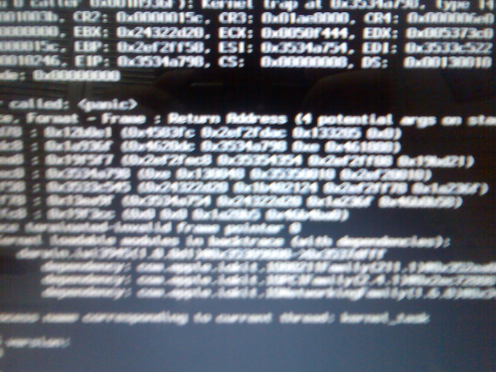

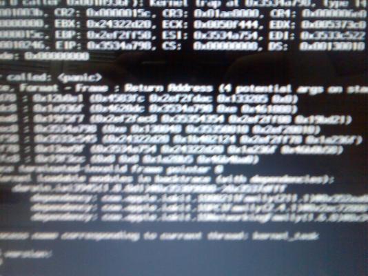

jalavoui Posted April 7, 2008 Author Share Posted April 7, 2008 iwi3945 can someone post the kp picture last one doesn't show where it crashes Link to comment https://www.insanelymac.com/forum/topic/84072-intel-wireless-2100-2200bg-2915bg-3945abg-4965agn/page/25/#findComment-699746 Share on other sites More sharing options...
Roal2488 Posted April 7, 2008 Share Posted April 7, 2008 iwi3945can someone post the kp picture last one doesn't show where it crashes Jalavoui: I got a KP(grey screen of death) when i mounted the kext with the kexhelper application, but i coulndt get any logs. of course i get the same KP whle trying to boot normally. will try with -v to see what happens. then i booted with -s and loaded the driver manually with the kextload command and got the screen i posted. How do i make it crash booting with -s? the thing is that the screen freezes there and still after 15min it was still like that. Link to comment https://www.insanelymac.com/forum/topic/84072-intel-wireless-2100-2200bg-2915bg-3945abg-4965agn/page/25/#findComment-699994 Share on other sites More sharing options...
glorybox Posted April 7, 2008 Share Posted April 7, 2008 iwi3945can someone post the kp picture last one doesn't show where it crashes 669 KP Link to comment https://www.insanelymac.com/forum/topic/84072-intel-wireless-2100-2200bg-2915bg-3945abg-4965agn/page/25/#findComment-700003 Share on other sites More sharing options...

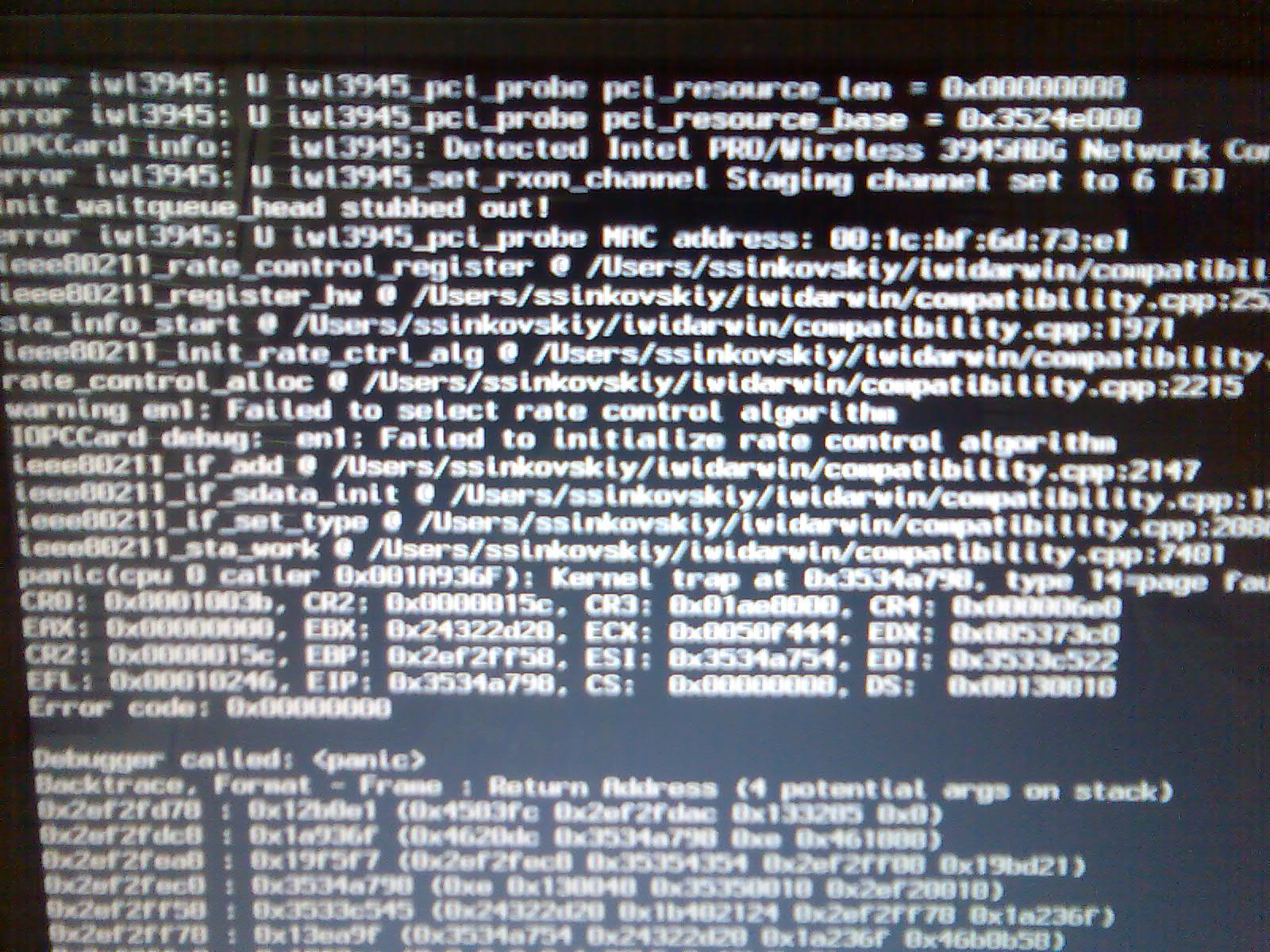

glorybox Posted April 7, 2008 Share Posted April 7, 2008 I've posted some markers and recompiled it. It crashes right here: void ieee80211_sta_work(struct work_struct *work) { IM_HERE_NOW(); struct ieee80211_sub_if_data *sdata = (struct ieee80211_sub_if_data*)work->data;//check this // container_of(work, struct ieee80211_sub_if_data, u.sta.work); struct net_device *dev = sdata->dev; ---->>>>> HERE struct ieee80211_local *local = (struct ieee80211_local*)wdev_priv(dev->ieee80211_ptr); struct ieee80211_if_sta *ifsta; struct sk_buff *skb; Hope this helps Link to comment https://www.insanelymac.com/forum/topic/84072-intel-wireless-2100-2200bg-2915bg-3945abg-4965agn/page/25/#findComment-700121 Share on other sites More sharing options...
revolt_team Posted April 7, 2008 Share Posted April 7, 2008 i added the IOLog("1\n"); to the static int ieee80211_open(struct net_device *dev) function and re-compile it whit xcode under leo 10.5.1 then i bot whit -s the i load the kext whit kextload but ... but ... but the driver frezees and i dont give me the kernel panic there some pics ... of a couple of try's Archive.zip Link to comment https://www.insanelymac.com/forum/topic/84072-intel-wireless-2100-2200bg-2915bg-3945abg-4965agn/page/25/#findComment-700135 Share on other sites More sharing options...
jalavoui Posted April 7, 2008 Author Share Posted April 7, 2008 I've posted some markers and recompiled it. It crashes right here:void ieee80211_sta_work(struct work_struct *work){IM_HERE_NOW(); struct ieee80211_sub_if_data *sdata = (struct ieee80211_sub_if_data*)work->data;//check this // container_of(work, struct ieee80211_sub_if_data, u.sta.work); struct net_device *dev = sdata->dev;---->>>>> HERE struct ieee80211_local *local = (struct ieee80211_local*)wdev_priv(dev->ieee80211_ptr); struct ieee80211_if_sta *ifsta; struct sk_buff *skb;Hope this helps very nice kp catch i'll try to fix it iwi3945 rel 670 if you have xcode maybe you can fix this - try some IOLog() if get a kp Link to comment https://www.insanelymac.com/forum/topic/84072-intel-wireless-2100-2200bg-2915bg-3945abg-4965agn/page/25/#findComment-700153 Share on other sites More sharing options...
glorybox Posted April 7, 2008 Share Posted April 7, 2008 very nice kp catch i'll try to fix it iwi3945 rel 670 if you have xcode maybe you can fix this - try some IOLog() if get a kp Well, I used printf(), since IOLog doesn't produce any messages to console Link to comment https://www.insanelymac.com/forum/topic/84072-intel-wireless-2100-2200bg-2915bg-3945abg-4965agn/page/25/#findComment-700266 Share on other sites More sharing options...
jalavoui Posted April 7, 2008 Author Share Posted April 7, 2008 iwi3945 rel 671 fixed code for thread alloc this version should be more stable Link to comment https://www.insanelymac.com/forum/topic/84072-intel-wireless-2100-2200bg-2915bg-3945abg-4965agn/page/25/#findComment-700303 Share on other sites More sharing options...
