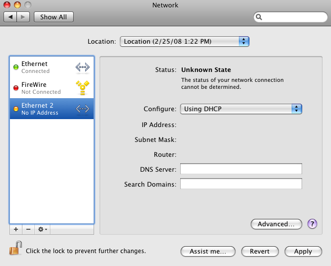

revolt_team Posted March 29, 2008 Share Posted March 29, 2008 my logs whit the last svn loads ok sometimes ... in the network preferences it is show how a ethernet card see the pict ... alt(comand)+shift+4 (to take it) but when i try to put it on on whit network selector nothing is happen and then of some time to try, the mac frezesss and not responding. some times the after the kext is loaded the mac frezess too the logs too .. are atached sorry for my inglish (viva mexico) dmesg.txt ioreg.txt system.txt Link to comment https://www.insanelymac.com/forum/topic/84072-intel-wireless-2100-2200bg-2915bg-3945abg-4965agn/page/21/#findComment-687999 Share on other sites More sharing options...

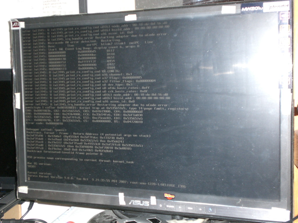

Sousuke Posted March 29, 2008 Share Posted March 29, 2008 I've compiled and tested the newest revision 654. But my comp hangs after a while, grey-screen-of-death... In any case, my MAC address is detected correctly and my logs are attached! dmesg.txt dmesg_complete.txt ioreg.txt system.txt system_complete.txt Link to comment https://www.insanelymac.com/forum/topic/84072-intel-wireless-2100-2200bg-2915bg-3945abg-4965agn/page/21/#findComment-688045 Share on other sites More sharing options...
Hacktrix2006 Posted March 29, 2008 Share Posted March 29, 2008 i'm getting Grey screen of death too just after the login windows shows. Is this a bug i wonder Link to comment https://www.insanelymac.com/forum/topic/84072-intel-wireless-2100-2200bg-2915bg-3945abg-4965agn/page/21/#findComment-688047 Share on other sites More sharing options...
jalavoui Posted March 29, 2008 Author Share Posted March 29, 2008 iwi3945 i hope you're building the .dmg correctly if the driver gives a kernel panic we must know where it is so we can fix it to do so: reboot press F8 type -s type sh /etc/rc wait for the driver load see if the driver angs if not call networkselector try option 1 a few times until it crashes post the kernel panic picture if you can't call the networkselector (because of seeing to many log messages) reboot until the driver crashes - them post the kp picture i don't expect to have the driver receiving/transfer packets so soon but it is expected to start scanning for neworks Link to comment https://www.insanelymac.com/forum/topic/84072-intel-wireless-2100-2200bg-2915bg-3945abg-4965agn/page/21/#findComment-688118 Share on other sites More sharing options...
