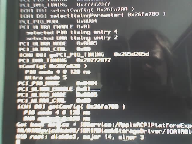

dimbulb Posted March 7, 2006 Share Posted March 7, 2006 I did essentially the same thing on a HP ZV6000. I move AppleGenericPCATA.kext and AppleOnboardPCATA.kext out of IOATAFamily.kext, moved the caches somewhere inane, just in case, and rebooted. It seems to detect the card and the disk, but then stops right after that. The last line I see is: BSD root: disk0s3, major 14, minor 3 Which looks a lot to me like it can read the disk and partition information, but then just stops. I'm not sure if it's getting that data from GRUB, or if it's actually reading the disk, but my experience with unix suggests the latter. I've included a screenshot to see if that helps. Sorry about the quality, it's an elderly cameraphone. Update: I edited the system with a Knoppix CD to see if there was anything I was missing, and now the system says: jnl: journal start/end pointers reset! (jnl 0x2737e69 ; s 0x438000 e 0x438000) Which is suspect it's reading off the drive, meaning something is happening before it freezes. Further Update: The problem actually seems to lie in the PS2 keyboard support. Removing it allowed 10.4.5 to boot. Link to comment https://www.insanelymac.com/forum/topic/8088-ati-south-bridge-solved-ati-ixp-ati-x200-xpress-chipset/page/4/#findComment-70728 Share on other sites More sharing options...
