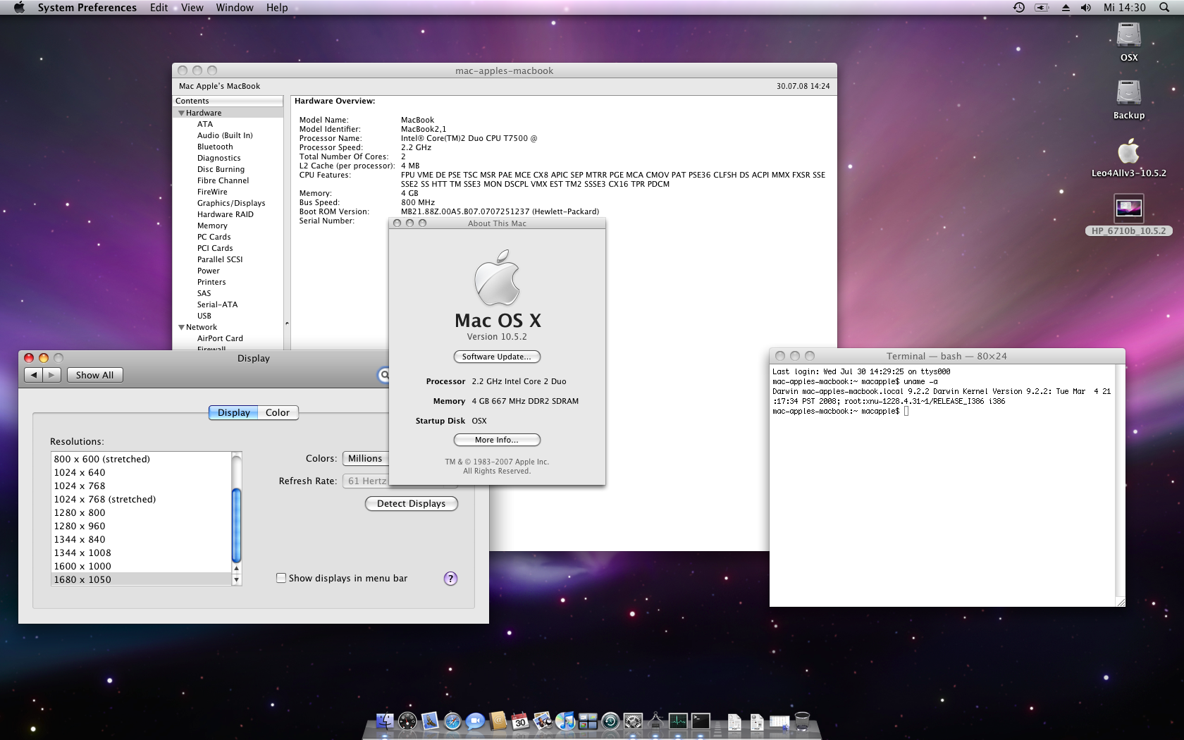

sskotleba Posted March 12, 2008 Share Posted March 12, 2008 Hey KlyX, Fabio and all other 6710b users! I have sucessfully booted the ToH RC2 using KlyX's guide. It now boots just fine without -x but when trying part two of the guide it will not go through completely. Therefore I have a great install of OSX Leo with 1024x768 support, no audio, WLAN, or real graphic support yet. I have followed the guide in booting again from the dvd using -x and will get through the first 3 lines of the code. When I get to: chown root:wheel mach_kernel . . . it says there is "No such file or directory". Has this happened to anyone else? If so let me know. By the way I might be reading the guide wrong because I got a little confused when you say under the second part "To work in Terminal in Leo is much easier that in the Toh installer". Because of this I tried to also install the code in Terminal while in Leo itself. That didn't work either and kicked me out saying it denied me access. Let me know what I should do next? So Fabio-Does the Kalyway 10.5.1 really work? The reason I am asking is because I have installed the Kalyway 10.5.1 on my dv8000t with dual booted Vista Ultimate with tons of success and a lot of people asking how to do it. I would love to get this hp 6710b up and going. If you say Kalyway works I will try it with the vanilla kernel and EFI 8.0. Link to comment https://www.insanelymac.com/forum/topic/76288-guide-leopard-on-hp-compaq-6710b-with-efi_v80-wireless-graphics-sound/page/2/#findComment-663516 Share on other sites More sharing options...

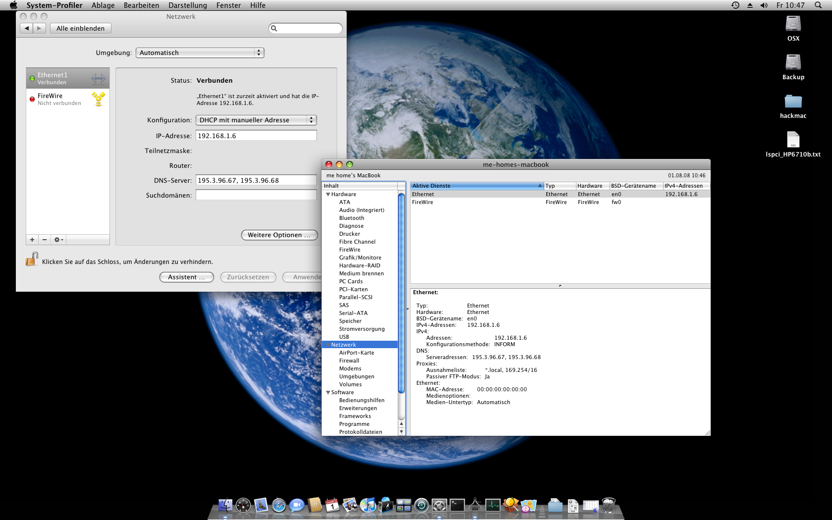

me@home Posted July 31, 2008 Share Posted July 31, 2008 I recently purchased a 6710b, and installed Kalyway 10.5.2, everything works fine, except for the LAN and the wireless, are there any advances with that? installed Leo4allV3 10.5.2 - had no luck with any 10.5.3 / 10.5.4 updates / DVD (iAtkos) Same here: Ethernet controller [0200]: Broadcom Corporation NetLink BCM5787M Gigabit Ethernet PCI Express [14e4:1693] (rev 02) tried to put it in BCM 5751 but still no LAN. I did order the wlan card mentioned a few post ago and hope to get a connection to the internet ! Edit: I can see ethernet connection but no MAC address - so I thinkt that's the error because I can not connect to internet (via Router). go to the hp parts order site and look up for partnr: 441075-002 441075-002 Broadcom 4311AG Wireless LAN 802.11a/b/g mini PCI adapter card (Bevo) - 54Mbps data rate, 2.4GHz operating frequency range - For Rest of World (ROW) WORKING ! I'm online now ! Just 3 screws have to be changed... Well paid Euro 53.- incl. ship + tax but it's worth it ! Link to comment https://www.insanelymac.com/forum/topic/76288-guide-leopard-on-hp-compaq-6710b-with-efi_v80-wireless-graphics-sound/page/2/#findComment-840394 Share on other sites More sharing options...
reck101101 Posted August 4, 2008 Share Posted August 4, 2008 YOYOYO but do you know some tricks without spending money buying that linksys? Hi @all I bought a HP Compaq 6710b a week ago and I was trying to get Leopard working on it. With everything it needs... Actually, that is quite difficult, but I got some results, I'd like to share with you. What you need: - OS X ToH RC 2 - Disc - USB Stick - 6710b Installation Files: Download ZIP here - Linksys Compact Wireless-G USB Adapter (WUSB54GC) --> costs about 20-30 Euros. And it's worth the money... AND the only way to get networking yet Preparations: - Format your USB-Stick and Name ist to "123". - Unpack the 6710b ZIP and copy the files on the stick First part: Installing Leopard To Install Leopard on your 6710b, you just need to follow the guide here: http://forum.insanelymac.com/index.php?showtopic=75928 Only change: you don't have to do the copy-part with your USB stick. The files in the 6710 zip-file contains also all files needed for the guide (pc_efi_v80) IMPORTANT: Boot with the -x option from the ToH DVD (press F8 before boot, and then -x) Be aware: After Installation of OS X ToH, you'll get a Kernel Panic. This is okay, just do the next step Second Part: Install the right Kernel and get Framebuffer Support Now boot once again to the ToH Disc (-x again). Go to the Terminal again. IMPORTANT: You'll need the name of the Volume where leo is installed and also the stickname (which should be 123, if you followed the guide until now). For my leo-Volume I'll use "Macintosh" What are we gonna do now: First, we will replace the ToH Kernel withe the newest 9.1 Speedstep Kernel which works perfectly for the 6710b. Then we delete all X3100 Files and install the Original Leo Framebuffer File, so that you can boot without -x mode into leopard. To work in the Terminal in Leo is much easier than in the ToH installer ;-) So type this in the Terminal: rm -R /Volumes/Macintosh/mach_kernel cd /Volumes/123/kernel/ cp mach_toh /Volumes/Macintosh/mach_kernel chown root:wheel mach_kernel chmod 644 mach_kernel cd /Volumes/Macintosh/System/Library/Extensions rm -R AppleIntelGMAX3100* cd /Volumes/123/framebuffer/ cp -R AppleIntelIntegratedFramebuffer.kext /Volumes/Macintosh/System/Library/Extensions/AppleIntelIntegratedFramebuffer.kext chown -R root:wheel AppleIntelIntegratedFramebuffer.kext cmod -R 755 AppleIntelIntegratedFramebuffer.kext Now, reboot (don't remove USB stick atm) and first enjoy the Leopard GUI... You did the first step to a good working leo System on your HP Compaq 6710b Third Part: Get REAL graphic support - with QE and CI Now, we should try to get some better graphics now. If you didn't get any Kernel Panics or other errors, then this should be easy ;-) Open the Terminal in Leopard cd /Volumes/123/graphics sudo cp -R AppleIntelGMAX3100.kext /System/Library/Extensions/AppleIntelGMAX3100.kext sudo cp -R AppleIntelGMAX3100FB.kext /System/Library/Extensions/AppleIntelGMAX3100FB.kext sudo cp -R AppleIntelGMAX3100GA.plugin /System/Library/Extensions/AppleIntelGMAX3100GA.plugin sudo cp -R AppleIntelGMAX3100GLDriver.bundle /System/Library/Extensions/AppleIntelGMAX3100GLDriver.bundle sudo cp -R AppleIntelGMAX3100VADriver.bundle /System/Library/Extensions/AppleIntelGMAX3100VADriver.bundle sudo cp -R Natit.kext /System/Library/Extensions/Natit.kext sudo chown -R root:wheel * sudo chmod -R 755 * Reboot again... If everything went well your leo boots up with QE and CI supported. Just go to the Display Section in you System preferences. Change the resolutions to 1680x1000 (not 1680x1050!! This will perform a nice bluescreen :-P). Have fun with full QE/CI support Fourth Part: Get WLAN connection That part is the hardest part... It costs acout 20-30 Euros, because to get networking with the 6710b you'll need to use an external source. At the moment, the integrated wireless and also the intergrated ethernet connection won't work. I hope they'll do later. Drivers are in development, but it's quite hard for the developper, because he has not the right hardware to test. The best WiFi support you'll get with the Linksys Compact Wireless-G USB Adapter (WUSB54GC), which is fully supported and has good drivers. - To install the drivers for the adapter, go to the USB stick, into the "wireless" folder. Unpack the Ralink Wireless Drivers Installation Wizard.mpkg.zip and install the package. - Reboot and press F8 before booting. Enter -f as boot argument to load the driver. - Now undpack and install the ralinkv015.zip package - Go to /Library/Preferences/SystemConfiguration and change the com.apple.Boot.plist - Add/change the following: <key>Kernel Flags</key> <string>-f</string> - Reboot again, enter nothing, just boot - Go to the network properties and configure the new adapter which you'll find there (manually will do it best) - If the Ralink Utlity didn't start yet, just go to programs folder and open the Wireless utilty. - Your adapter and the nearest network should show up here (so you nearly got ist ;-)). - Create a profile with your network informations (SSID, Security, etc.) and connect You should have now full internet access Fifth part: We want sound That part is quite easy The azalia sound driver will help your sound card to get some music Just navigate to the "audio" directory on your USB Stick and install the azalia.audio.pkg Reboot Enjoy sound So that's it for the moment... IMPORTANT: Don't update the Kernel with the 10.5.1 Kernel from apple. It will end into a Kernel Panic... Don't know why. The speedstep 9.1 kernel seems to be the best for the 6710b at the moment. Sixth Part (added 16.12.): Add energy options Maybe you'll found out, that you have no battery icons and no infos about the battery. Either, the battery is going down quite fast. I found a first workaround, which gets you at least the icon. - Download http://forum.insanelymac.com/index.php?act...ost&id=2295 - Do the following steps: 1. Un-archive the files. This will leave you with a PowerManagement.bundle 2. Navigate to: /System/Library/SystemConfiguration 3. (Optional) Backup your old PowerManagement.bundle 4. Copy (drag-n-drop) the new bundle into the SystemConfiguration folder 5. When the dialog box pops up, select authenticate and type your admin password 6. Reboot For me I can't change the energy environnment yet. But I'm gonna do some tests with Paulicats ACPI kexts soon. So hope, I'll do some progress, Special Thanks to: JamesD (for the pretty cool installation guide (see above)) mitro (for his extensions I used to get QE/CI working) keithpk (for the energy options workaround) Things I'll need to find out: - How to reduce brightness (for longer battery lifetime) If you have suggestions, questions, ideas... I'm glad to read responses Link to comment https://www.insanelymac.com/forum/topic/76288-guide-leopard-on-hp-compaq-6710b-with-efi_v80-wireless-graphics-sound/page/2/#findComment-843938 Share on other sites More sharing options...

KlyX Posted August 25, 2008 Author Share Posted August 25, 2008 Short update: Installation with Leo4All V3 worked perfectly for me: - Installation with the 9.2.0 Speedstep-Kernel - Drivers included: GMA X3100 The Wireless acutally the one I mentioned in my Tut. I'm going to order the Broadcom PCIe Card mentioned above. The sound expierience is working also with the driver mentioned in this thread - us said only speakers. So it's better now than half a year ago. Nevertheless: I can't change brightness at all. This would be a very important feature for me... KlyX Link to comment https://www.insanelymac.com/forum/topic/76288-guide-leopard-on-hp-compaq-6710b-with-efi_v80-wireless-graphics-sound/page/2/#findComment-868191 Share on other sites More sharing options...
