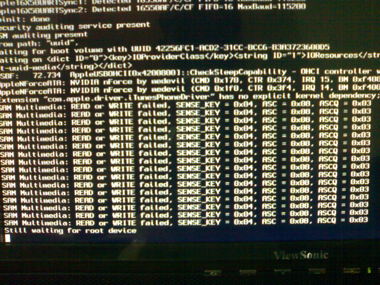

i tired with two different DVD -RW but still i am facing same problem.
No body here to help me with this problems :)
SAM Multimedia: read or write failed, SENSE_KEY = 0x04, ASC =0x08, ASCQ=0x03
Still waiting for root device
Faulty DVD Drive
Incompatible media
Faulty Harddisk
Data corruption over SATA/IDE cable.
While its annoying, its not really much of a mystery.
everything is New in my system
so i think there is no problem with dvd drive or HDD or any other cable.
coz i used to install vista using same dvd drive
