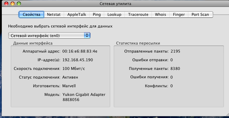

macmaniac Posted November 26, 2007 Share Posted November 26, 2007 I have Mobo ASUS P5K-E with the card Marvell 88E8056 and can not find drivers. Ethernet does not work me I ask for the help My system is ToH x86 9A581 RC2 The "Royco" fix. LAN: This is only for rev. 2.0, rev. 3.3, or any revision that uses Yukon controller 8056. For those that have 8053 (rev 1.0), LAN works without modification. This how-to was written by Royco. If you find it helpful, be sure to thank him! =) Open the terminal from /Applications/Utilities and type the following: sudo nano /System/Library/Extensions/IONetworkingFamily.kext/Contents/PlugIns/AppleYukon2.kext/Contents/Info.plist (find and change: <key>Yukon-88E8053</key>) (to: <key>Yukon-88E8056</key>) <-- change "53" to "56" (find and change: <string>0x436211AB</string>) (to: <string>0x436411AB</string>) <-- change "62" to "64" (find and change: <string>Yukon Gigabit Adapter 88E8053 Singleport Copper$</string>) (to: <string>Yukon Gigabit Adapter 88E8056 Singleport Copper$</string>) <-- change "53" to "56" Ctrl O <--- Thats letter O Enter Ctrl X sudo chown -R root:wheel /System/Library/Extensions/IONetworkingFamily.kext sudo rm -rf /System/Library/Extensions.mkext Reboot. After rebooting your LAN might not be working yet and showing up as disconnected. Do the following. - Go to System Preferences, Click on the network icon. - On the left pane select your ethernet, on the right pane where it says "Configure" select "off". - Click apply. - Now back to "Configure" select "Using DHCP". Click apply. - Your LAN should be working by now. Link to comment Share on other sites More sharing options...

woodoodm Posted December 18, 2007 Share Posted December 18, 2007 The "Royco" fix. LAN: This is only for rev. 2.0, rev. 3.3, or any revision that uses Yukon controller 8056. For those that have 8053 (rev 1.0), LAN works without modification. This how-to was written by Royco. If you find it helpful, be sure to thank him! =) Open the terminal from /Applications/Utilities and type the following: sudo nano /System/Library/Extensions/IONetworkingFamily.kext/Contents/PlugIns/AppleYukon2.kext/Contents/Info.plist (find and change: <key>Yukon-88E8053</key>) (to: <key>Yukon-88E8056</key>) <-- change "53" to "56" (find and change: <string>0x436211AB</string>) (to: <string>0x436411AB</string>) <-- change "62" to "64" (find and change: <string>Yukon Gigabit Adapter 88E8053 Singleport Copper$</string>) (to: <string>Yukon Gigabit Adapter 88E8056 Singleport Copper$</string>) <-- change "53" to "56" Ctrl O <--- Thats letter O Enter Ctrl X sudo chown -R root:wheel /System/Library/Extensions/IONetworkingFamily.kext sudo rm -rf /System/Library/Extensions.mkext Reboot. This don`t work for me too. Any help, pleeeeeeeeease ? Link to comment Share on other sites More sharing options...
