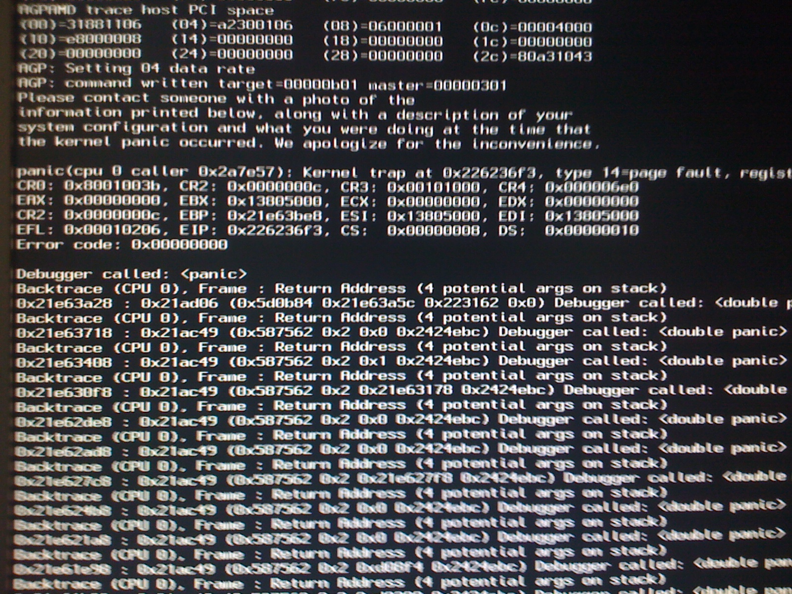

crazyJAT Posted August 14, 2009 Share Posted August 14, 2009 I am trying to use AGPGart 2.7.1 with a GeForce 7800 GS 256MB AGP card (0x00f510de) on an Intel 82845G AGP bus. Without the AGPGart.kext installed, I have QE/CI enabled, but it is very sluggish. When I install AGPGart.kext I get black and white bars with artifacts. Anyone know how to fix this issue? The image below is my screen after installing AGPGart.kext version 2.7.1 The image below is a closer look at the image Link to comment Share on other sites More sharing options...

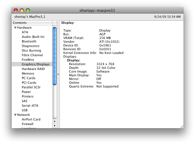

hackaroni Posted September 24, 2009 Share Posted September 24, 2009 @Slice I am inspired by your patience and persistence. You take it to a whole new level. Thank you! Installed iDeneb 1.3 10.5.5 with no video drivers. (Video worked 1024x768, no flags.) I've got an ATI Radeon 9200 AGP 256MB and tried using your AGPGart 2.7.1 and IOPCIFamily.kext 2.4.4 (I believe I tried version 2.5.4 of this as well) The computer boots up with in 1024x768, no flags, same as before. I'll attach my files and device/vendor... No worries if you don't have time to look at this... I will probably try Tiger 10.4.8 if this doesn't work. Thanks again! dmesg_and_ioreg.zip Link to comment Share on other sites More sharing options...
