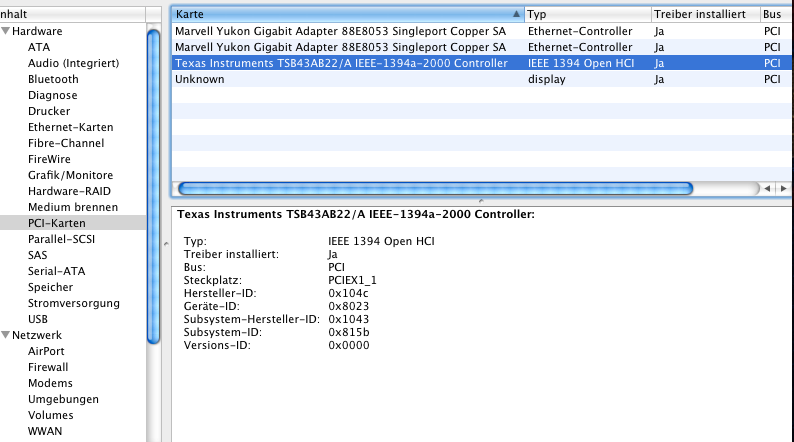

HI!
Apple System shows up a PCI FW Interface!
On 10.5 its recognized as a firewire port i think!?!?!?!?
I uploaded a screenshot from my Systemcontroll:
May be it helps!

FireWire works, but does not work as expected hotplug. If you boot with a connected and switched on FireWire device, it will work. I will try to find the cause of this behavior.

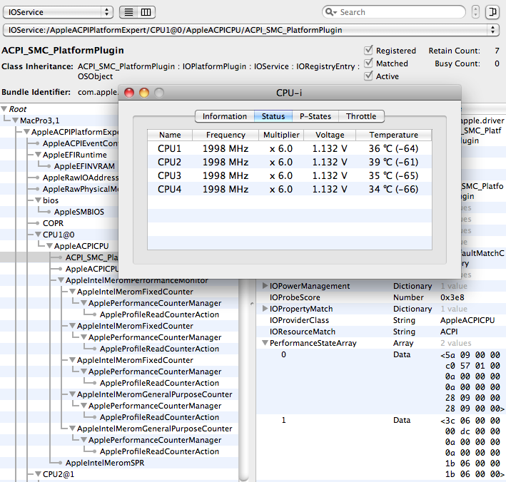

Yes i own firewire external disk so i can test
as i said automatic sleep doesn't work just sleep
IOService:/AppleACPIPlatformExpert/CPU1@0/AppleACPICPU/ACPI_SMC_PlatformPlugin shows 2 values and CPU-i too
it respond when more cpu is required
OK, But you have CSTInfo? - as in the selection #1, because if not it does not work you fully speedstep. Work only PST states without CST. CPU frequency will be changed, but after starting the LPC, CPU temperature should drop by a further few degrees.
