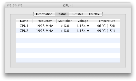

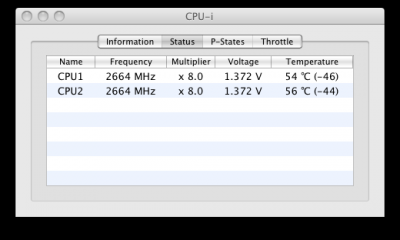

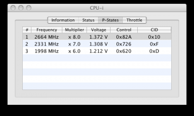

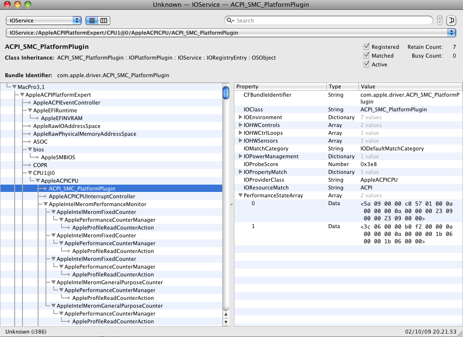

aliab Posted October 2, 2009 Share Posted October 2, 2009 Probably, because 2901 dont't have SSDT tables needed to working Vanilla SpeedSteep. You can try to implement SSDT tables manually in processors section. In Attachment You find SSDT tables dumped from 2504 BIOS. Thank you very much i will give it a try It seems to work in CPU-i but not reported in IORegister ? Edit : in fact 2 values are working the 6x and the 9x Link to comment https://www.insanelymac.com/forum/topic/68453-asus-p5w-dh-deluxe-thread-for-105x-leo-109x-mavericks/page/41/#findComment-1287423 Share on other sites More sharing options...

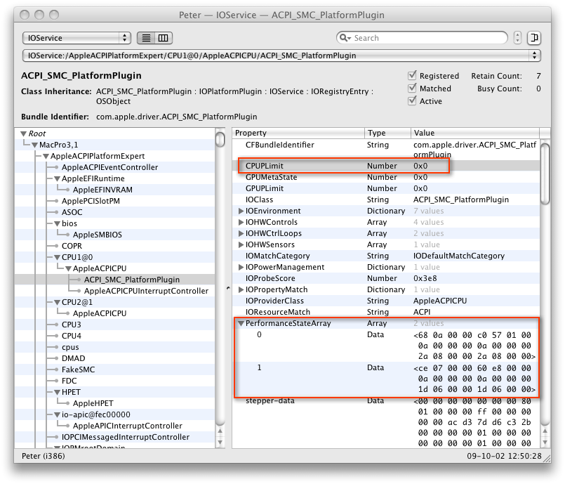

314TeR Posted October 2, 2009 Share Posted October 2, 2009 Edit : in fact 2 values are working the 6x and the 9x What would have confirmed the information from IORegistryExplorer. Look at CPUPLimit and PerformanceStateArray. Link to comment https://www.insanelymac.com/forum/topic/68453-asus-p5w-dh-deluxe-thread-for-105x-leo-109x-mavericks/page/41/#findComment-1287491 Share on other sites More sharing options...

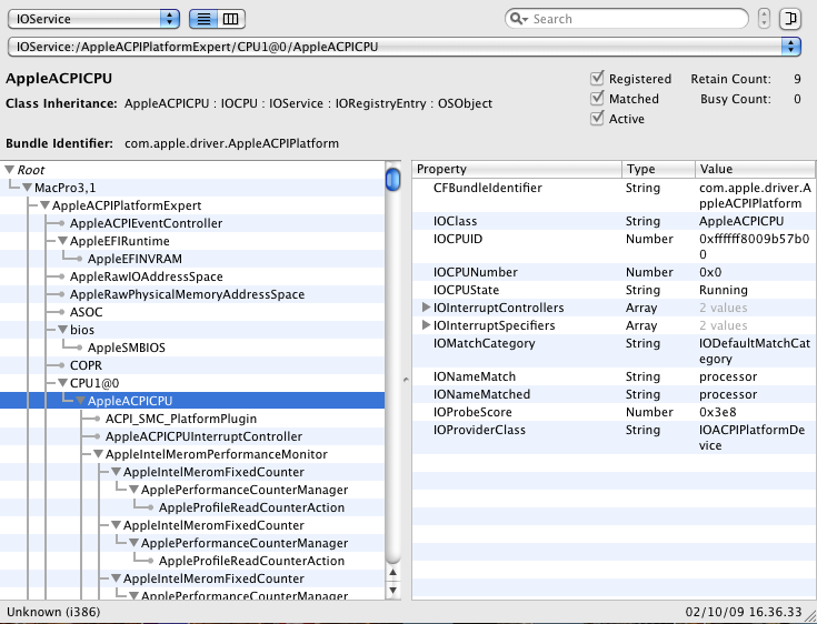

morfy Posted October 2, 2009 Share Posted October 2, 2009 We put the photos of my hack. What do you think? how can I resolve the situation? Link to comment https://www.insanelymac.com/forum/topic/68453-asus-p5w-dh-deluxe-thread-for-105x-leo-109x-mavericks/page/41/#findComment-1287642 Share on other sites More sharing options...

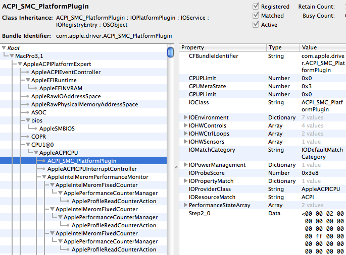

314TeR Posted October 2, 2009 Share Posted October 2, 2009 We put the photos of my hack. What do you think? how can I resolve the situation? Show contess of ACPI_SMC_PlatformPlugin, like on my screen. Link to comment https://www.insanelymac.com/forum/topic/68453-asus-p5w-dh-deluxe-thread-for-105x-leo-109x-mavericks/page/41/#findComment-1287680 Share on other sites More sharing options...

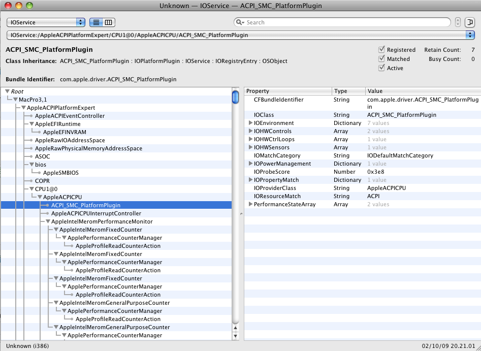

morfy Posted October 2, 2009 Share Posted October 2, 2009 Show contess of ACPI_SMC_PlatformPlugin, like on my screen. Here it is! Thx. Link to comment https://www.insanelymac.com/forum/topic/68453-asus-p5w-dh-deluxe-thread-for-105x-leo-109x-mavericks/page/41/#findComment-1287851 Share on other sites More sharing options...

314TeR Posted October 3, 2009 Share Posted October 3, 2009 @morfy - On your screens do not see the value CPUPlimit which must have a value of 0x0 to SpeedSteep work. Are you using NULLCPU or disabler ... If so, remove them ... Link to comment https://www.insanelymac.com/forum/topic/68453-asus-p5w-dh-deluxe-thread-for-105x-leo-109x-mavericks/page/41/#findComment-1288609 Share on other sites More sharing options...
morfy Posted October 4, 2009 Share Posted October 4, 2009 @morfy - On your screens do not see the value CPUPlimit which must have a value of 0x0 to SpeedSteep work. Are you using NULLCPU or disabler ... If so, remove them ... I put the bios 2901 and the DSDT of ALIAB started working with the speedstep-x32 (tested with MSR) while 64-bit anything. Link to comment https://www.insanelymac.com/forum/topic/68453-asus-p5w-dh-deluxe-thread-for-105x-leo-109x-mavericks/page/41/#findComment-1289277 Share on other sites More sharing options...
