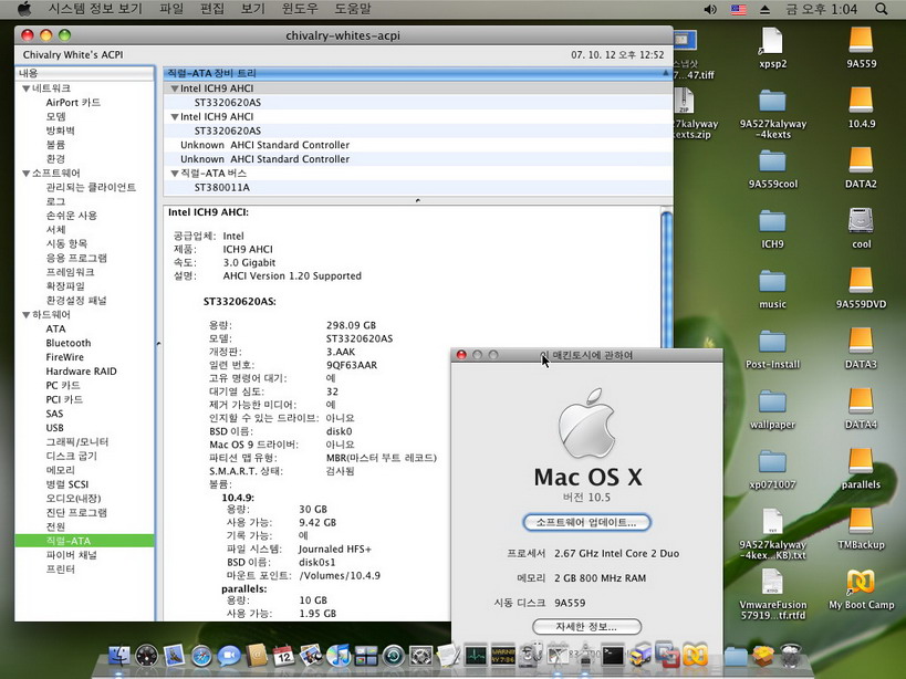

chival4ry Posted October 30, 2007 Share Posted October 30, 2007 Tried to tweak the info.plist from that kext to <key>IOPCIPrimaryMatch</key> <string>0x29268086 0x29208086 0x29218086</string> Those ids were found on Intel's web site (and 2926 and 2921 are the ones used in Windows Vista) but still it won't boot. Maybe because I chose in the bios SATA Mode Enhanced and not SATA Mode Compatible... But I don't think so... Hi, all. My friend(LeeBaek - 이백이백) tried many numbers ( 2910 ~ 2930 ), and found out "2923", and then told me this one about 2 weeks ago. ( I am sorry for my late info. ^^; ) I tried it on leopard-9a559, and in my case, almost there is not a difference in Performance, and didn`t try sata3 & sata4 ports yet. ---------- AppleAHCIPort.kext > Contents > Info.plist <key>ICH9AHCI</key> <dict> <key>CFBundleIdentifier</key> <string>com.apple.driver.AppleAHCIPort</string> <key>Chipset Name</key> <string>ICH9 AHCI</string> <key>IOClass</key> <string>AppleAHCI</string> <key>IOPCIPrimaryMatch</key> <string>0x29218086 0x29268086 0x29238086</string> <key>IOProbeScore</key> <integer>2000</integer> <key>IOProviderClass</key> <string>IOPCIDevice</string> <key>Vendor Name</key> <string>Intel</string> </dict> ----------- Link to comment https://www.insanelymac.com/forum/topic/58107-stay-clear-asus-p5k-vanilla-not-working/#findComment-487726 Share on other sites More sharing options...
