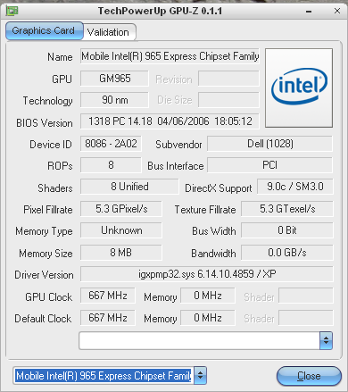

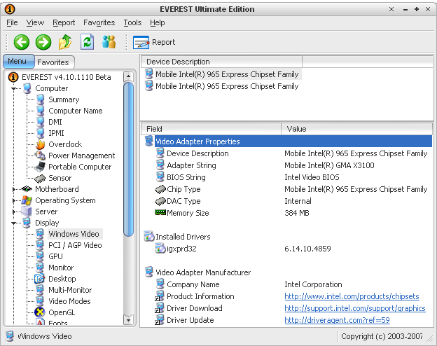

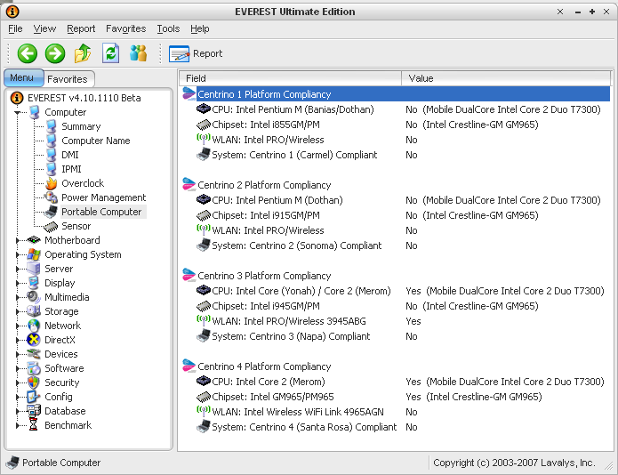

theSlug Posted November 14, 2007 Share Posted November 14, 2007 D630 don't have the GMA X3100 but only GMA 3100...don't work at the moment 965GMA AKA X3100 AKA GMA3100 AKA Crestline AKA SantaRosa. Same card.. intel develop only a graphic chip for a generation of chipset. on the table on this wiki: http://en.wikipedia.org/wiki/Intel_GMA GMA 3100 is associated with G31, Q33, Q35 G33 chipset GMA X3100 is associated with GM965, GL960 chipset the D630 have the crestline (GM965) chipset onboard. X3100 the difference between HWID is possible on the "apple edition", but.. the tweaking IMHO is also possible. i hope ! LASTEDIT: GPUz report a 667 clock for the vga (tipically GMA X3000), but i controlled the openGL support, is 1.5 (GMA X3100), previus card support only openGL 1.4. Link to comment https://www.insanelymac.com/forum/topic/52304-dell-latitude-d630-compatible/page/2/#findComment-506356 Share on other sites More sharing options...
errandwolfe Posted November 15, 2007 Share Posted November 15, 2007 The Dell Latitude D630 most definitely has the GMA X3100 NOT the GMA 3100. The excerpt below is directly from the technical specifications page on Dell's website. ntel® Graphics Media Accelerator X3100 (Up to 256MB shared2)The GMA X3100 graphics core is an intelligent and responsive graphics engine built into the chipset that is on the motherboard. This integration provides incredible visual quality, faster graphics performance and flexible display options Page can be found at: http://www.dell.com/content/products/produ...=biz&cs=555 Link to comment https://www.insanelymac.com/forum/topic/52304-dell-latitude-d630-compatible/page/2/#findComment-506963 Share on other sites More sharing options...
MacNeo Posted November 15, 2007 Share Posted November 15, 2007 I agreee, my Dell Lat. D630 has GMA X3100 too not GMA3100 ...! Link to comment https://www.insanelymac.com/forum/topic/52304-dell-latitude-d630-compatible/page/2/#findComment-507438 Share on other sites More sharing options...
